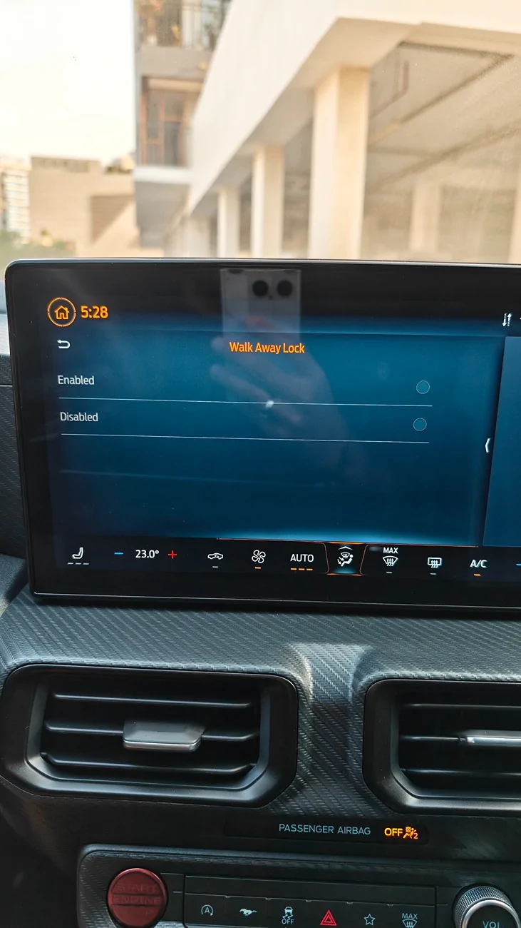

Here is what I have done till now:
- continuous gear display
- walkaway lock with feedback
- auto lock after 45s
if you dont mind me asking. what did u exactly change for those?

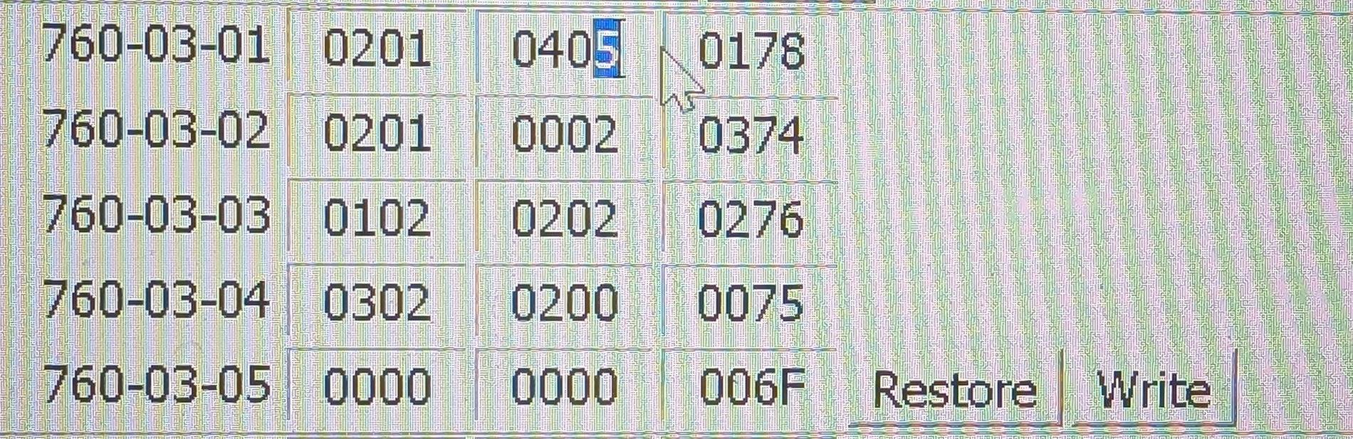

For the forward collision assist you can actually disable it through the abs module, it'll disable collision assistance while still allowing adaptive cruise and normal cruise control to be toggled, although you will have a "collision assist unavailable" warning on the dash. I like it being there as it confirms that The collision assist is off. You can remove the warning All together through the BCM.
Highlighted in blue is the address that should be changed to 1
If there is an issue change that same number back to 5

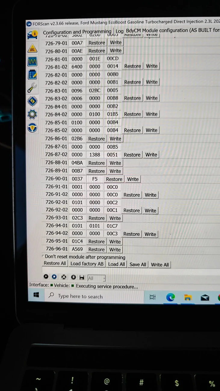

Can I ask please what you had to change to enable walkway locking?
I posted in another thread here, but could not get it to work.
I changed the APIM
7D0-09-05
BCM
726-91-01
In the first tab of the excel sheet it also mentions to change BCM 726-97-02, but these lines don't even show up for me. The entries stop at 96.
