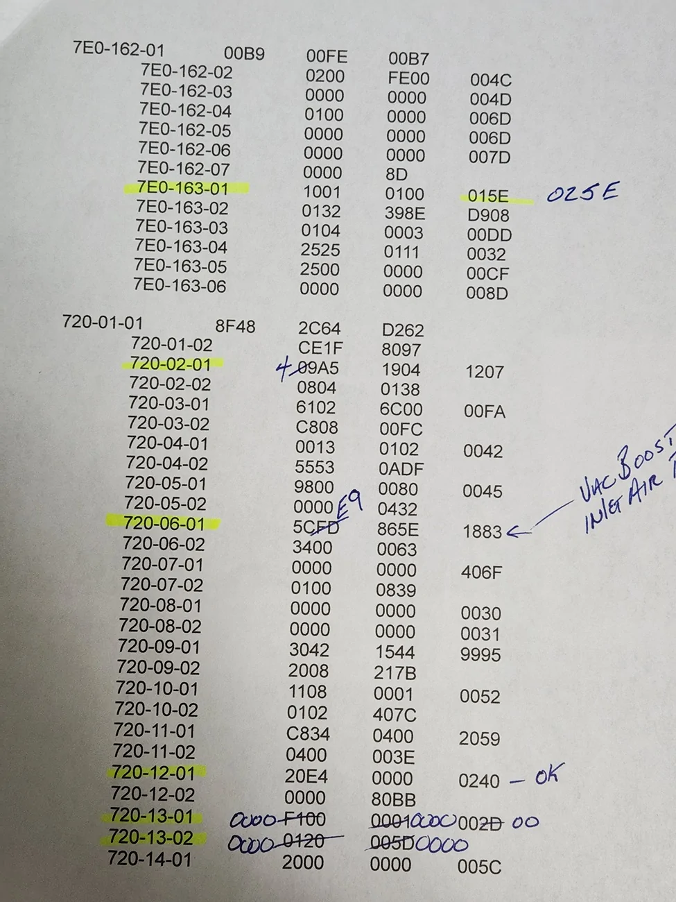

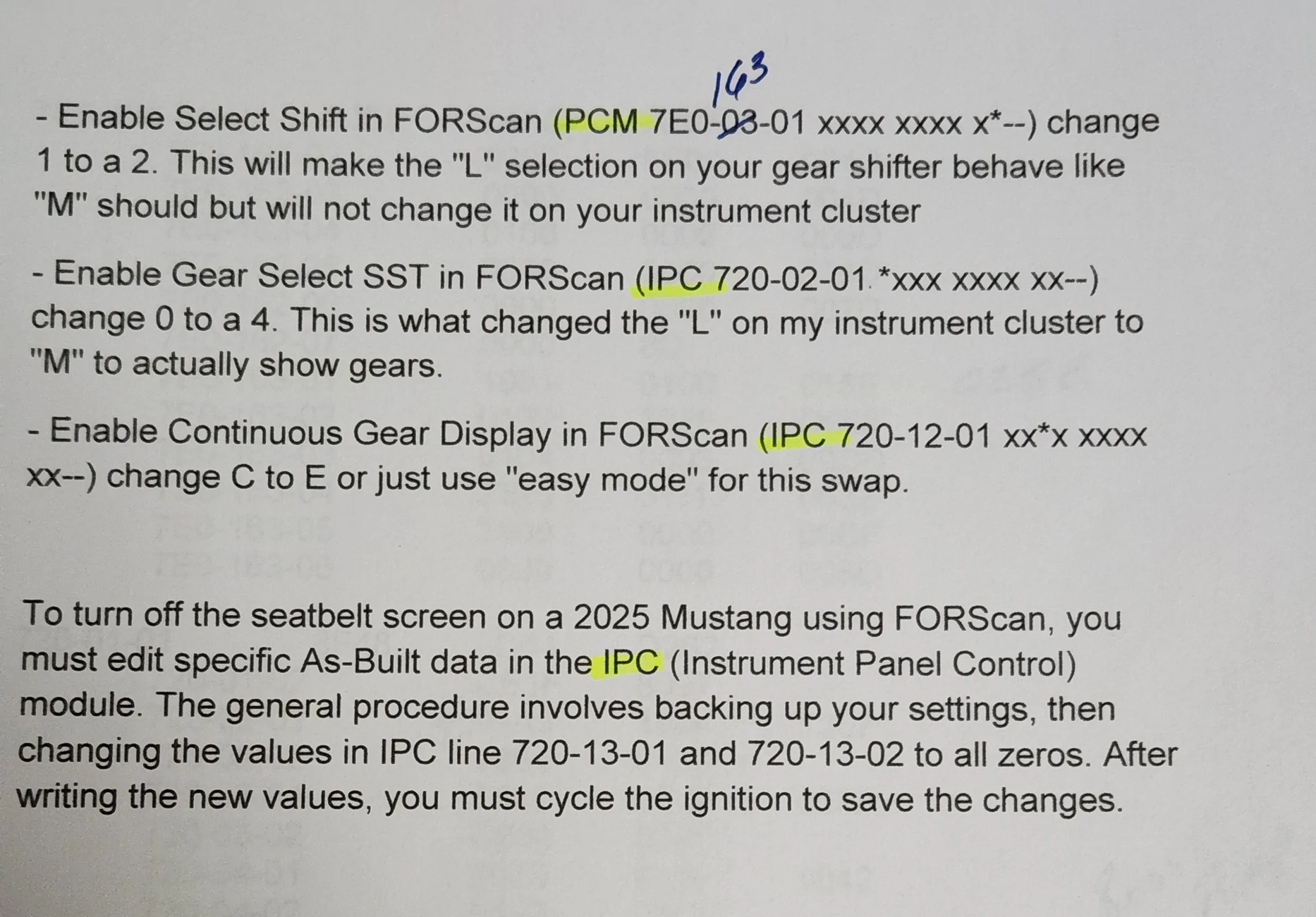

FWIW - been using Forscan since 2018 on my Ford trucks. Yes, make back up copies of everything! I print out a copy of the changes I want to make (copy and paste instructions from various sources) and the "as built" data with the data to be written. I make the changes on the as built printout, then make the same changes in Forscan. Then I file the hard copy away with the paperwork I keep on the car, as a hard copy record(s) of all Forscan changes.
