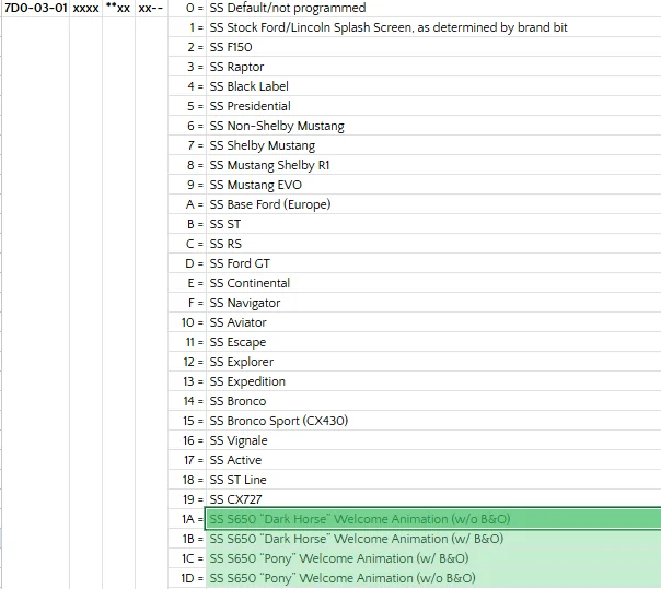

I know you're new to FORScan and maybe aren't ready to start FAFOing yet, but:
You said a base model, so no B&O right? This means that the start-up sound is fromt the splash screen going from the APIM to the ACM and through the speakers. Which means, in the APIM, you have have this config in this location:
Key location here is xxxx XXxx xx--
1D there is the "pony" welcome animation for non B&O Mustangs. So to get rid of the galloping sound, you would need to get rid of the splash screen completely. Either change it to 01 for Stock Ford, or you can try 06 for non-Shelby Mustang to see what that does.
If you don't get the desired result, you just change it back to 1D (assuming 1D is there now, which it should be as I pulled the config above from a 2025 Mustang with the base sound system).

Bang & Olufsen which is the branded system on vehicles with the upgraded sound system.
Which made me think of something: You can also try changing it to 1C to see what happens. If that directs the galloping sounds to the DSP of the B&O system which you do not have, it will send the signal for the galloping noise to no-man's land and not make a sound but you'd get to retain the same splash screen it has now. This is just a theory.....only one way to find out, though.
