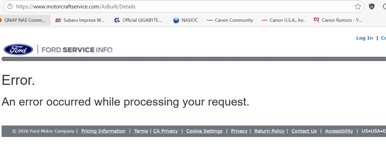

The "asbuilt" link didn't load on my phone. Is that still working?
Yes as far as I know it works, maybe try different browsers or different OS?

Hmmm,
Putting my IT hat on. Not working on PC either. Same when logged in too.

Maybe it's because I haven't bought a subscription yet?

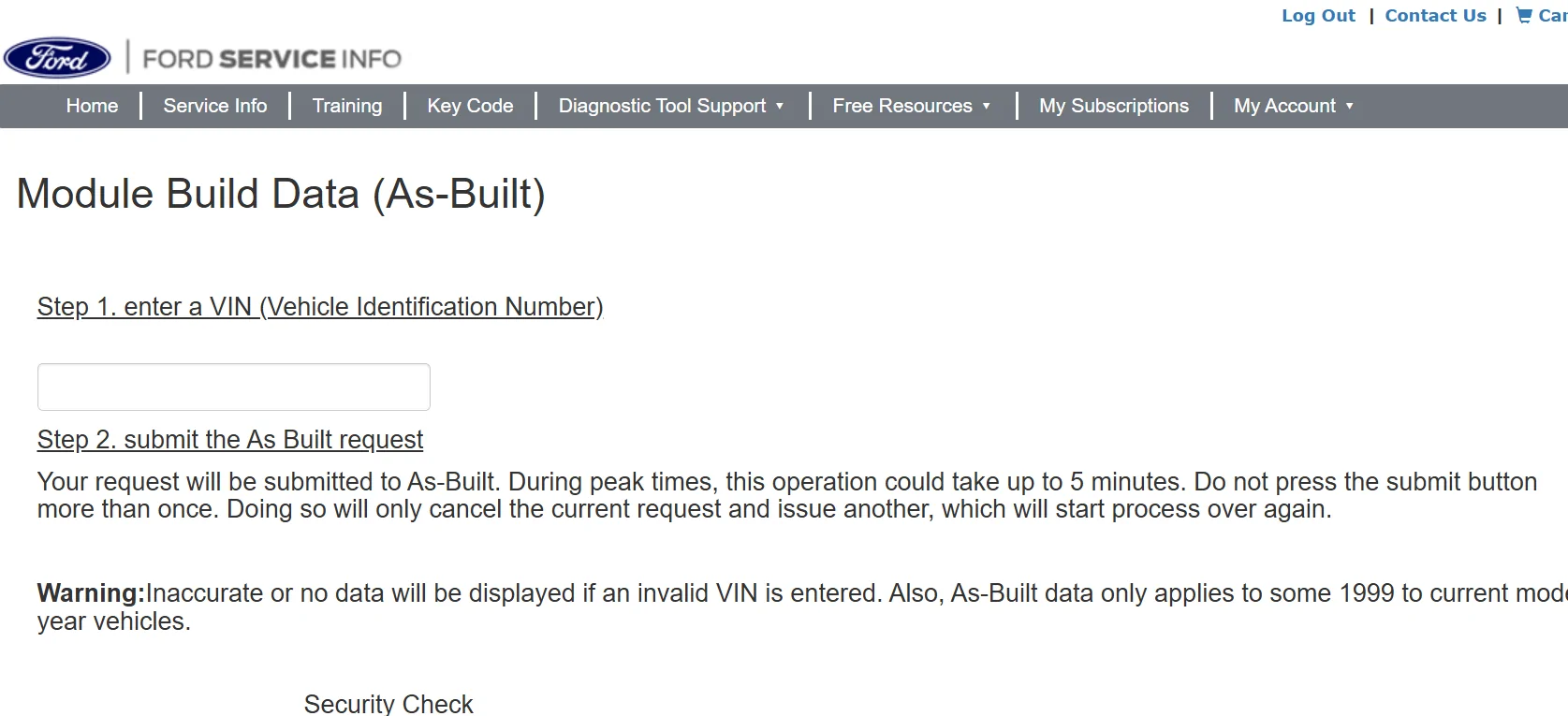

So the download is a file named [My VIN Number].ab and I save it to the IDS directory:
c:\Program Files\Ford Motor Company\Calibration Files
when I install ForScan?
Do I need the module addresses below as well?

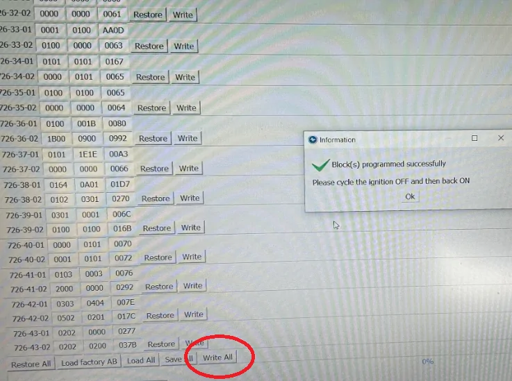

Nothing wrong with getting a copy of your ab data as it is before you start making changes, but keep in mind that if you scroll to the bottom of the module config page in FORScan, you will see this "write all" button there. All you have to do is click that and FORScan will pull the ab data for that module from Ford and write it.

This depends on whether the vehicle has synced up with the server or not between the time you made the change and the time you get an OTA for the module you made changes to. Eventually, the FORScan changes you made will make their way to the cloud and become part of your ab data. Once this happens, future updates will include the changes you made in them and won't revert it back.
