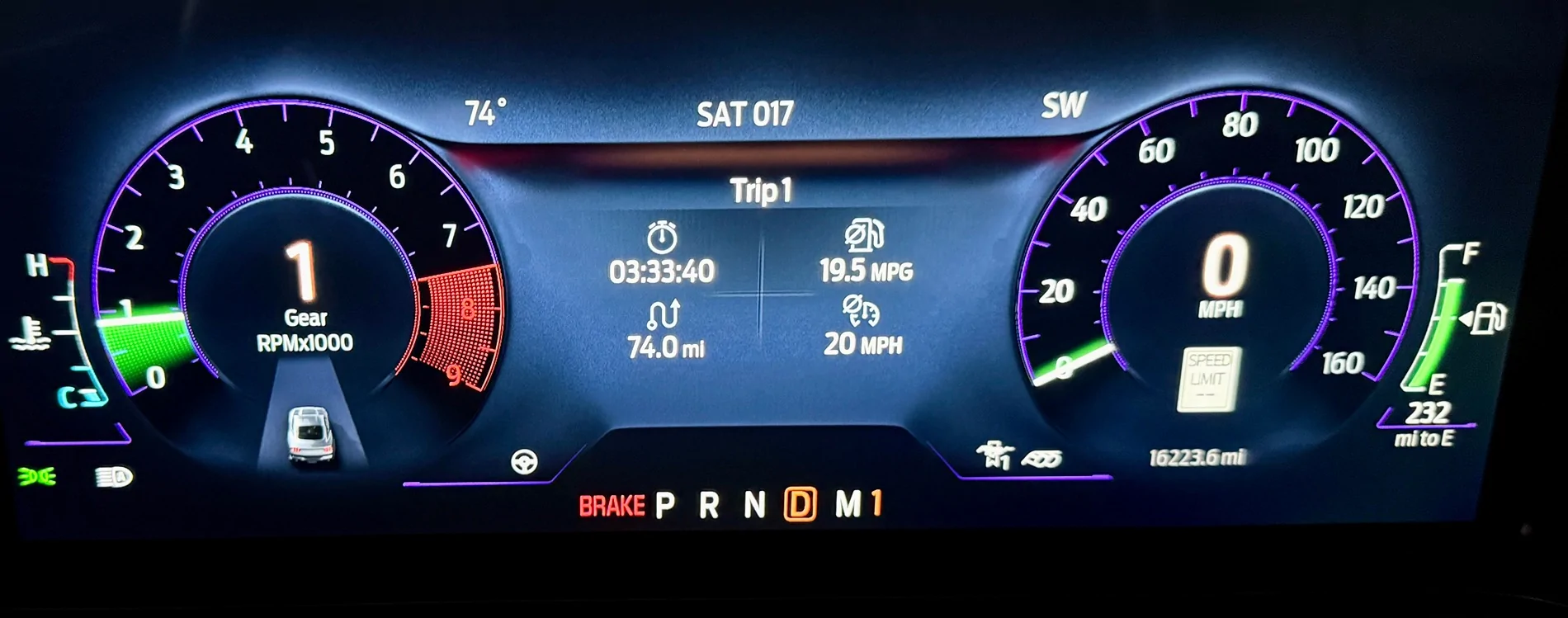

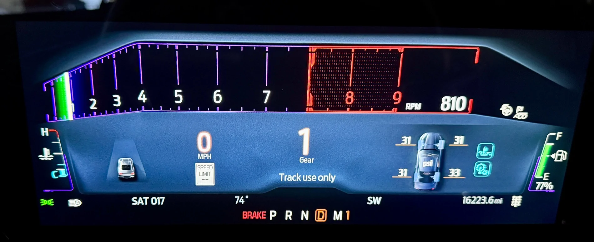

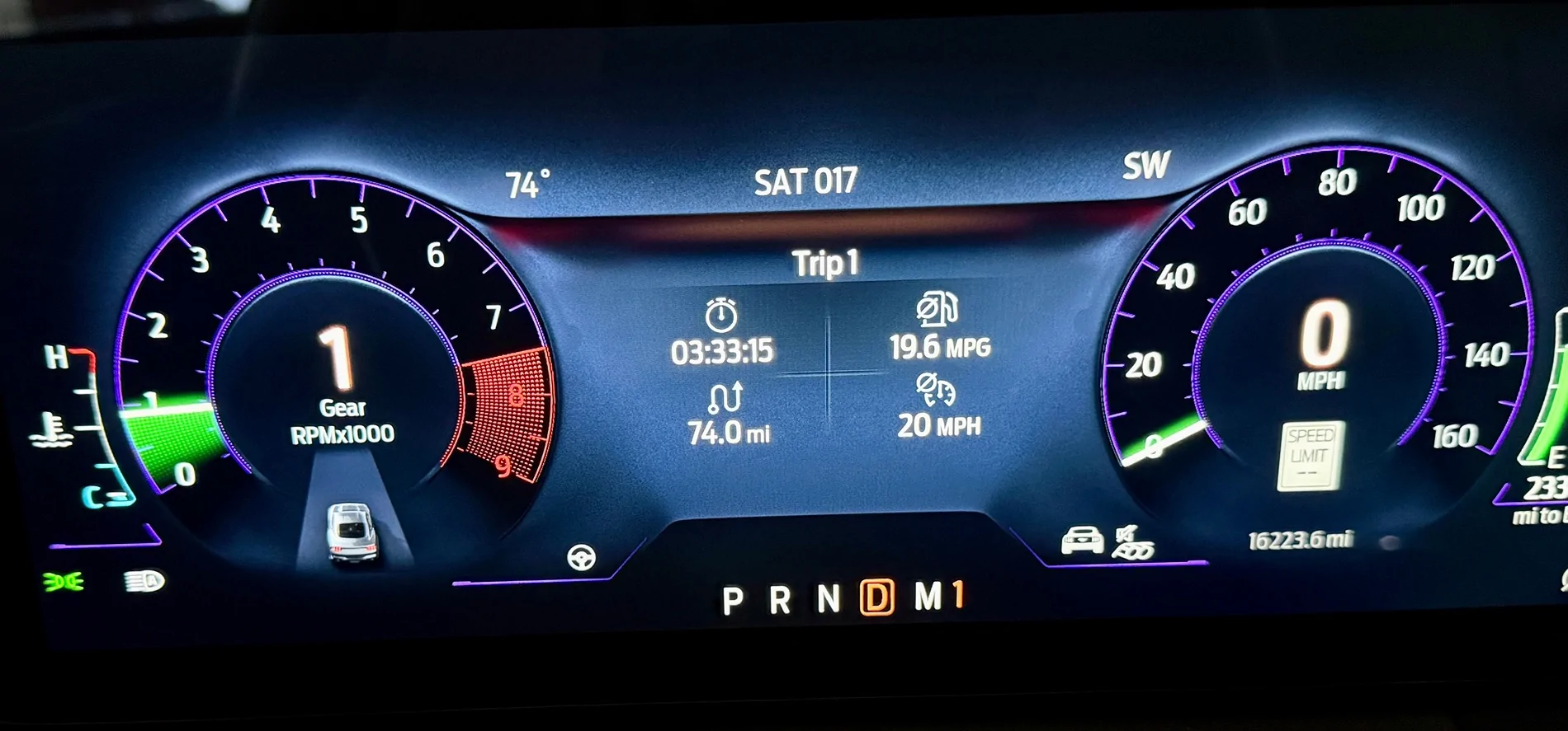

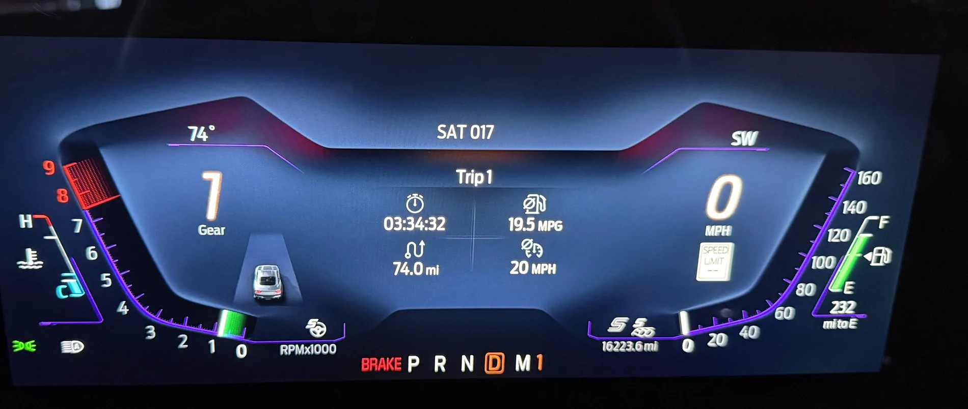

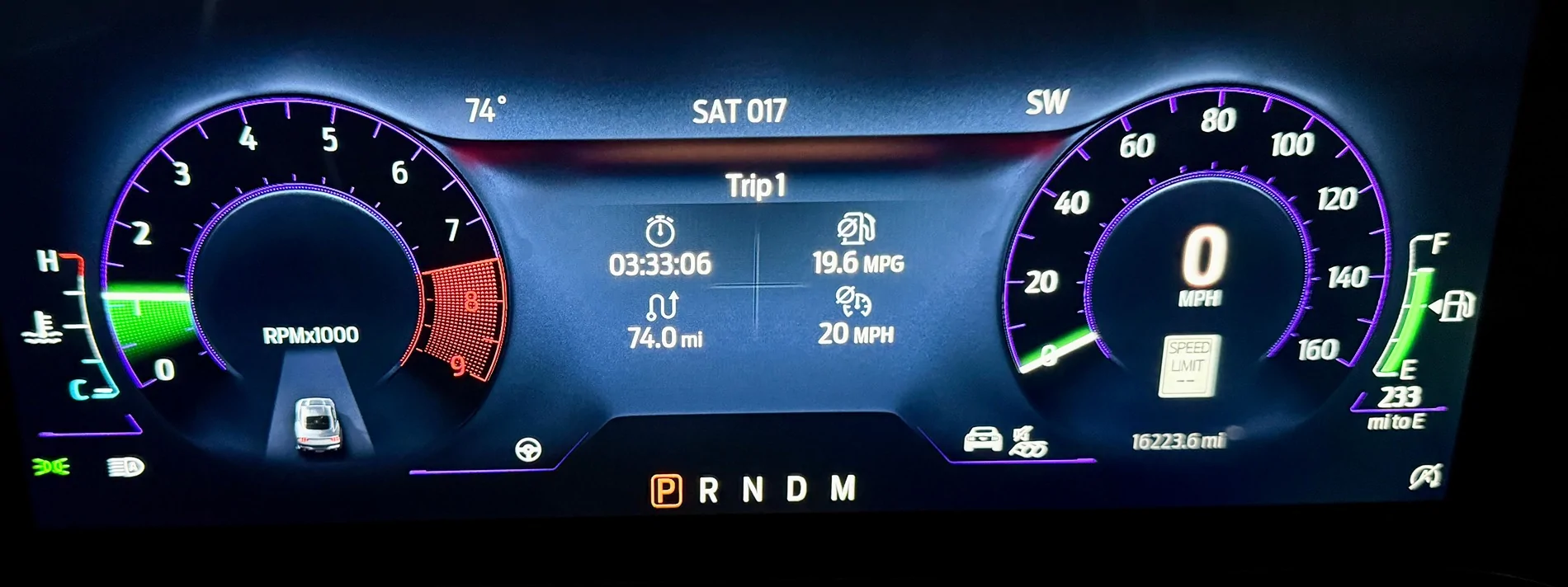

Here you go. Remember that the gear number does not show until you move it to Drive.
PARK
DRIVE NORMAL
DRIVE CUSTOM
DRIVE DRAGSTRIP
DRIVE SPORT
Sir, would you be willing to attach a pic of your dash in normal mode so I can verify exactly what i should be seeing?
PARK
DRIVE NORMAL
DRIVE CUSTOM
DRIVE DRAGSTRIP
DRIVE SPORT
Thank you so so much. I will verify if i did it correctly now.
Stangnutlx
Apr 1, 2026
2024 DH HP
I unpacked the IPC and changed continuous gear display to "enabled" wrote the change then cycled the key. Started it and still doesnt show up.
