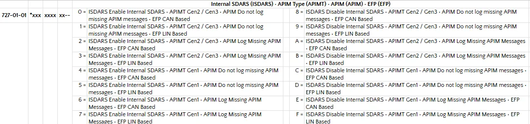

Has anyone started playing around with flattening the EQ on ACM 727-01-02 on the 650’s yet? I have a 301a 9 speaker setup that I want to try to liven up a bit and this was a good fix on my 2017 F150. I’m going to dust off my OBDlink MX and renew my license soon…
FYI this is what I’m referring to:
727-01-02 x*xx. 0=Flat EQ
1=Premium EQ #1 7=Audiophile EQ#3 D-F=misconfiguration
2=Premium EQ #2 8=Audiophile EQ#4
3=Premium EQ #3 9=Audiophile EQ#5
4=Premium EQ#4 A=Audiophile EQ#6
5=Audiophile EQ#1 B=Audiophile EQ#7
6=Audiophile EQ#2 C=Audiophile EQ#8
Update:
The spreadsheet is indicating the number is in a different spot now. This is the one listed for the 2024:
727-01-02xxx*xxxxxx--0 =EQS Flat EQ7 =EQS EQ #7
1 =EQS EQ #18 =EQS EQ #8
2 =EQS EQ #29 =EQS EQ #9
3 =EQS EQ #3A =EQS EQ #10
4 =EQS EQ #4B =EQS EQ #11
5 =EQS EQ #5C =EQS EQ #12
6 =EQS EQ #6
Has anyone figured out which is correct for 2024 ecoboost premium.
Every AI says this "727-01-02 x*xx. 0=Flat EQ" but the spreadsheet says its "727-01-02 xxx*"
Thanks!

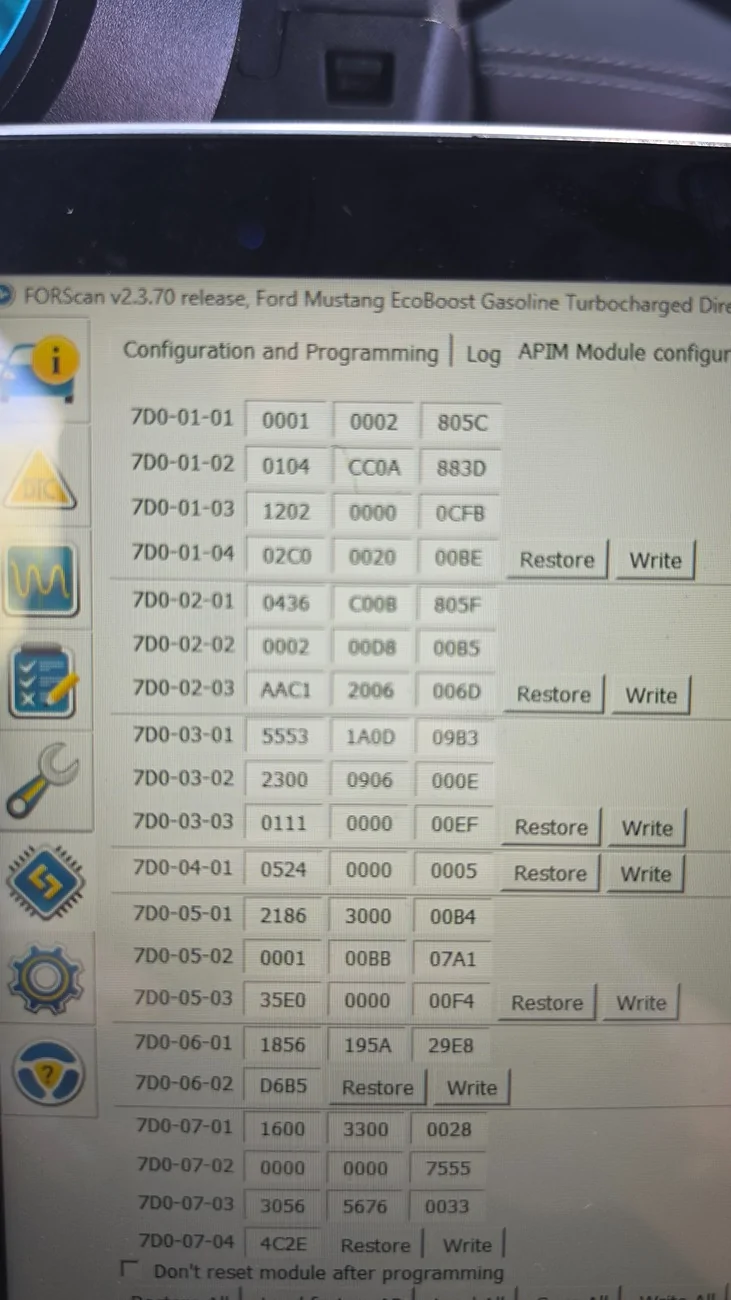

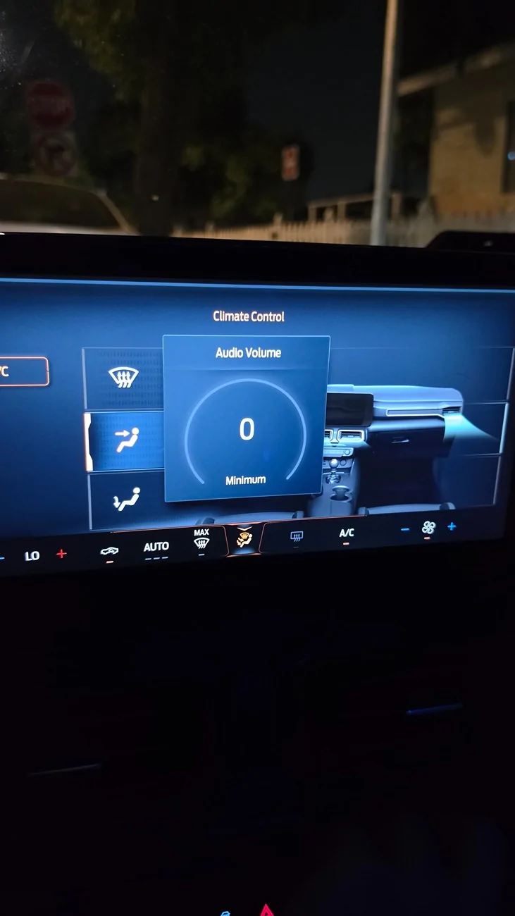

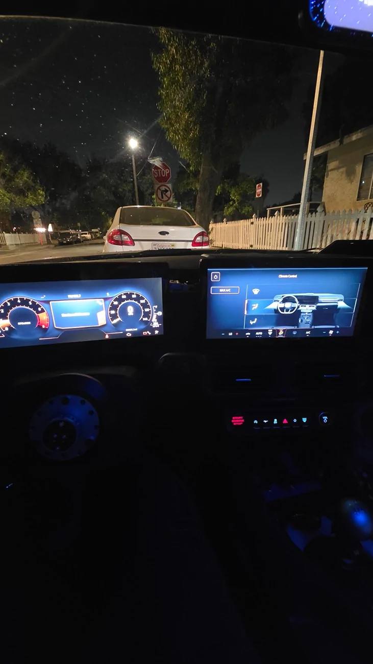

Got my S650 dash swap working including A/C, cluster, center screen and audio control panel, I have 2 questions, the Hazard only works on first click like momentary vs latching like I hit the button and it only flashes once then automatically stops, then hit again and same thing but hitting it multiple times triggers my tpms relearn lol, second, audio only displays 0 but works, I heard like 7D0-01-01 X###-####-#### to 0 will fix but it was for a Maverick, correct for S650 too?
I don't think that location will fix the volume issue. SDARS has to do with satelite radio and RSEM is some software related thing that I don't understand, but I don't think it corrolates to the volume control.
Try looking through the spreadsheet on the ACM spreadsheet to see if you find anything useful.

Hazards i found thankfully in a f150 forum, in the body control module, it was set to momentary and change to latching ( 1 to a 0) and hazards work, audio knob i cant figure out, i changed lines 727-01-01 ##x#-####-#### to a 5 and lost audio, i will go through the spreadsheet thank you!!

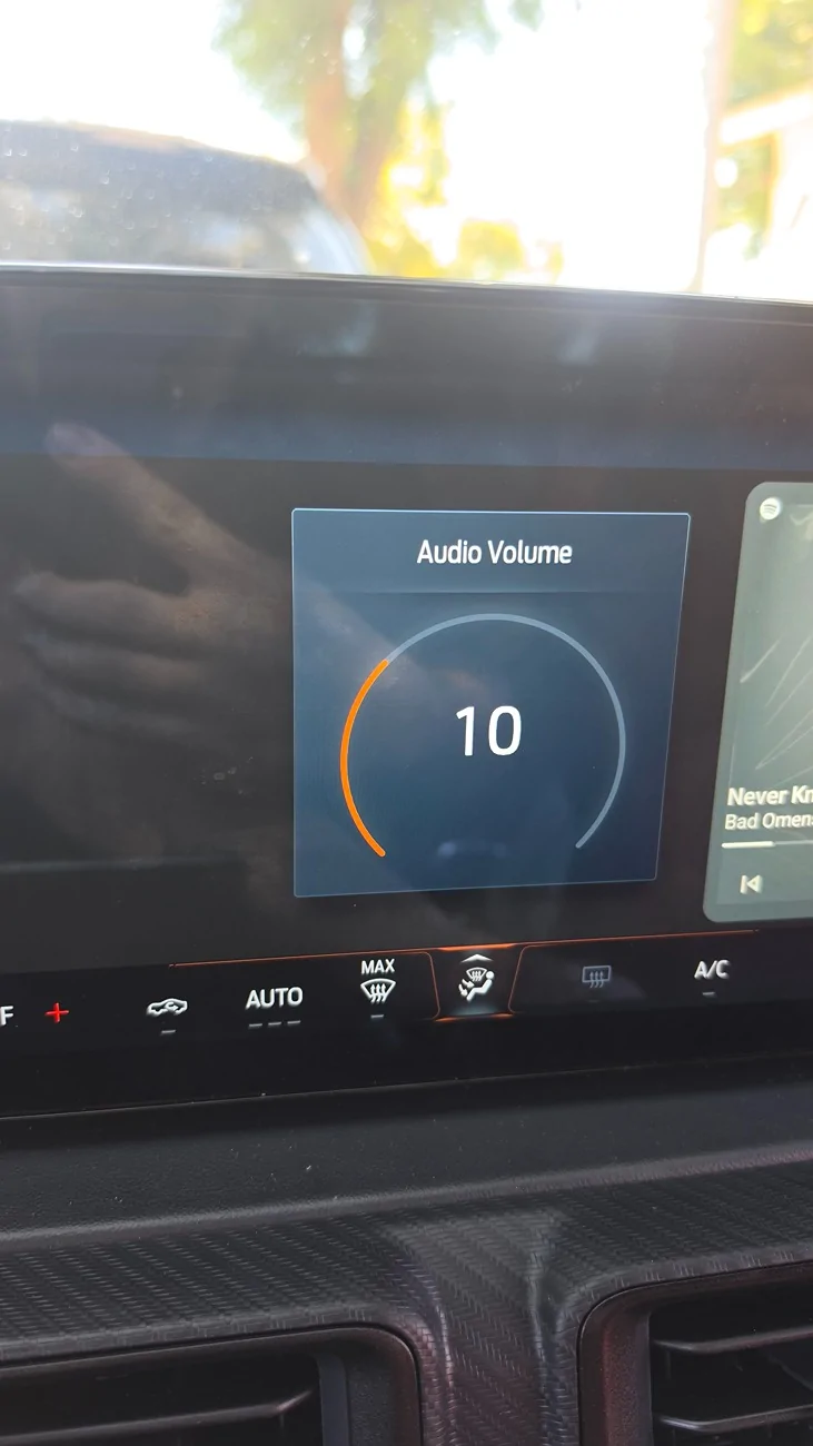

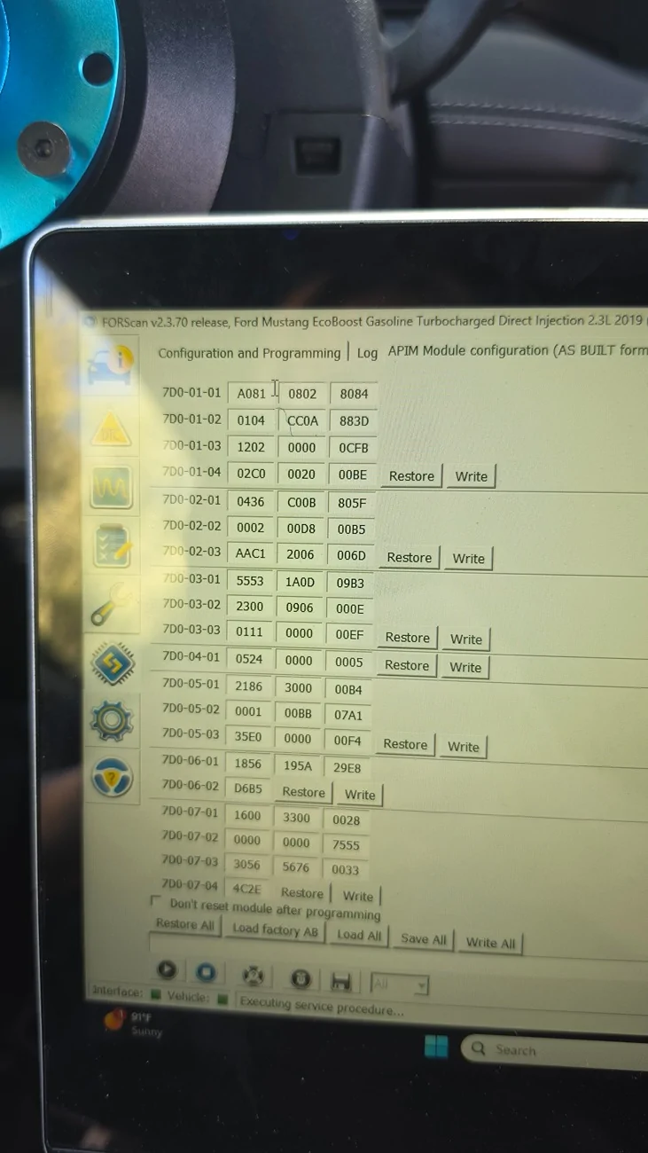

Alright another fix, I copied as built data from a 24 Mustang with 9 speaker package so I wouldn't interfere with the B&O external amp as I have 6 speaker package but wired the center speaker to the ACM, heres my original lines for 7D0-01-01
Heres the new data that worked
Ah, so it was in that line of the APIM? Interesting. Good to know.
