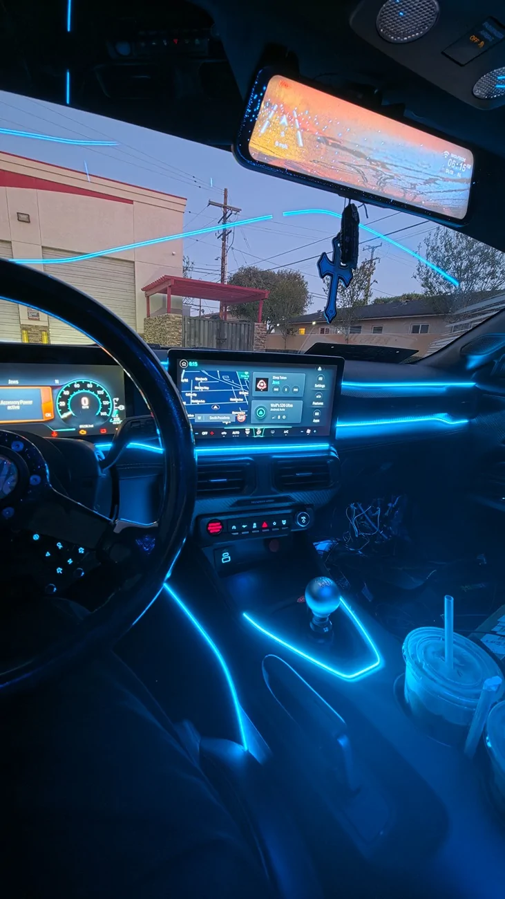

S650 dash swap completed in my S550, kick panel back on and cleaned the wires, I am still working on the steering wheel switches, have a plan to wire the s650 gateway only for the SCCM and am working on the electronic rear parking conversion with the brembo, thanks to everyone who helped with s650 forscan coding i needed!

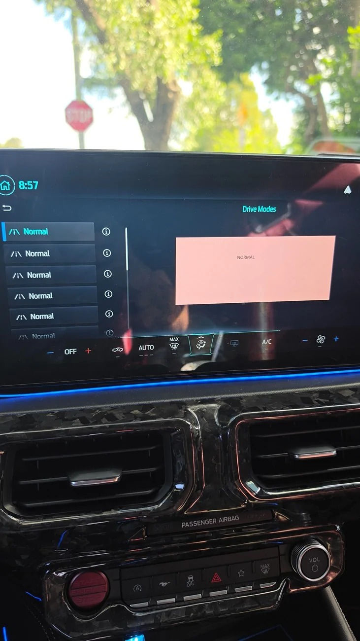

I'm back with another question on my S650 dash swapped S550, so was wondering if anyone can help?
- The profiles, I was able to create my own profile but I can't configure it to my key, the key detection module is still intact from my S550 and works with the S650 dash modules but it wont program the profile.
- I got the GPS working not knowing it was a Sync Module With Gps when I was first troubleshooting the swap, now that the swap is done, it shows maps but GPS has a slash through it meaning obviously no gps, can I turn off the maps since i only use android auto anyways? Cause the maps show I'm in a whole other city like 20 miles away.
- my drive modes on the center screen show like 10x normal modes with no info, am I missing a module? I have the IPC, Sync4, APIM, SCCM, and the HVAC module
I don't have that profile screen on my car at all, when i push the pony button and create custom drive modes it does not look like that, if i remember ill grab a pic next time i go for a drive.
The Gps slash through i had a similar problem when i upgraded to a GPS APIM, i had to install a different antena on the back. Then in forscan APIM easy mode there is a gps setting were it gets gps data from TCU or the newly installed antenna. Once i selected the other option other than TCU it worked as intended. Sorry its been a while since i was inside the APIM area.
