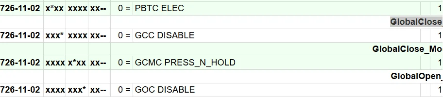

Has anyone figured out which is correct for 2024 ecoboost premium.
Every AI says this "727-01-02 x*xx. 0=Flat EQ" but the spreadsheet says its "727-01-02 xxx*"
Thanks!
Pretty sure that’s referring to previous generation(s).
I’d trust the spreadsheet over AI.

i tried, but it does not work even if everything is enabled
Just curious if anyone has found success with the global close since roket posted this in 2024.
Aggie1999
Oct 19, 2023
185
250
S650 PREM GT
The Mustang doesn't have the hardware to make it work.
Yes I'm an Aggie and thus I ask dumb and obvious questions, but that don't make no sense to me. It has the hardware to roll the windows up, soooo.... what it needs a flux capacitor or a neural interlink something or another?
ChrisMattice
Jun 5, 2023
47
43
Albany NY
2017 Ford F150 XLT
This has never been a thing. The S550's couldn't do it either. I believe it was never an active config and they never bothered adding it.

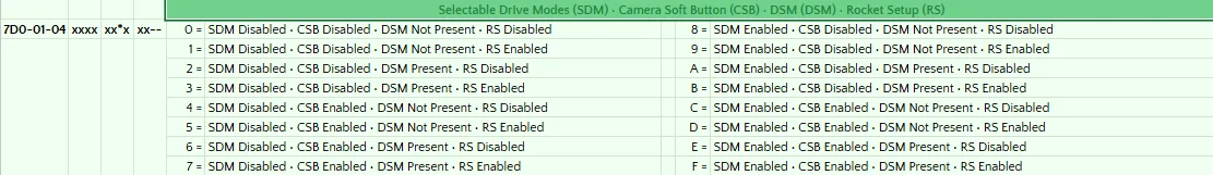

What modules in forscan control the drive modes, asking for my S650 dash swap, I have a list of drive modes (like 8 of them) saying normal and a blank picture for eachone, I feel I have a as built data corruption (Basically meaning S550 trying to communicate to S650 IPC resulting in Invalid data, also is there a module or coding that shows the cruise control icon, I have working cruise control but no icon that comes on
rugedraw
Apr 17, 2024
493
622
Miami, FL
You are exploring uncharter territoty brother. I know the drive modes need to be enabled in the IPC in a few spots. I would control F and search for drive in the spreadsheet under the IPC. Also, enable drive modes here in the APIM:
Danozamo
Jul 17, 2026
Dallas, Tx
Mustang GT w/ PP1
APIM
7D0-05-01 2186 xxxx xx--
7D0-09-02 xxxx x500 xD--
IPC
720-03-01 x1xx xxxx xx--
720-09-01 xxxx xxxx 9x--
IPMA
706-01-01 xx4x xxxx xx--
706-02-01 6xxx xxxx xx--
After changing all the lines in the 3 modules, go to the wrench icon and reboot the modules one by one IPC - IPMA - APIM.
Good luck and let me know if it works. If not, than probably there is no hardware in your car that can make this work.
