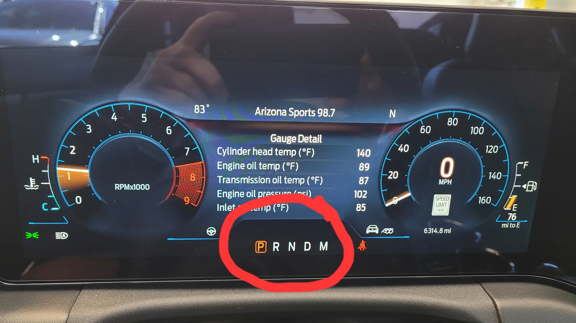

No I’m talking about on the actual screen bud, it says “N” or “R” where the gear display would be. I attached an image to show what I’m talking about.

That's only on manual transmission cars. Autos already have it at the bottom of the sceen where I circled. This does not change when you enable continuous gear display.

That's a nice find. It should be changable in Forscan, also on the automatic. Only need to find the right adress.

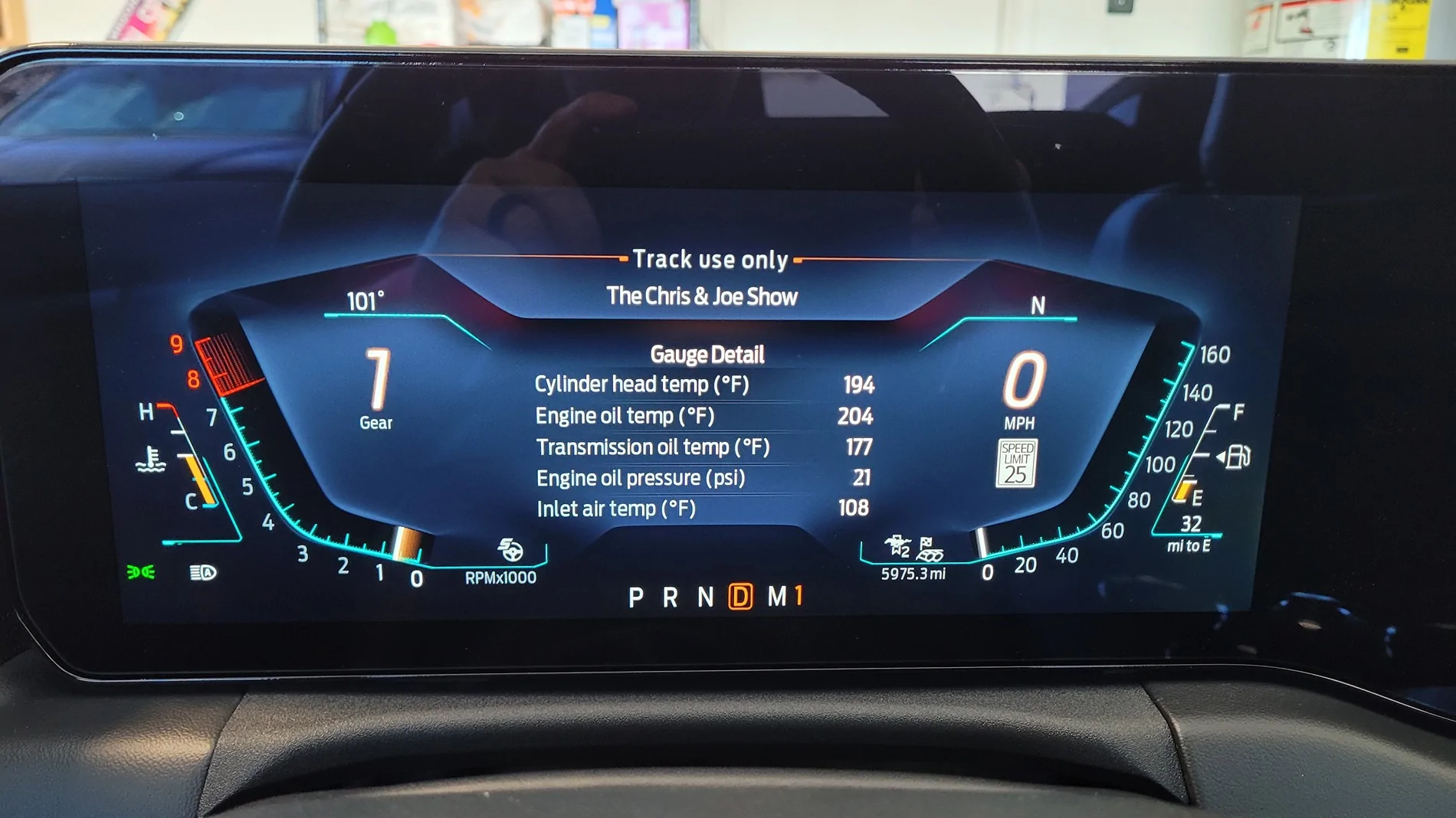

Here's a photo of how my instrument cluster is now, and where the gears are displayed. Small gear icon next to the "M" icon at the bottom, as well as a larger gear icon on the left opposite the speedometer. Both numbers display when the car is in "D" or "M."
