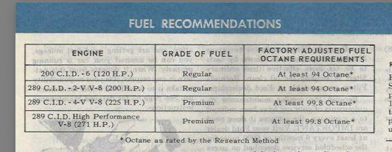

You are missing a bit of the context.
Take a look at the page (I've attached a copy)...
It's 98 Octane with an Asterisk which specifies the Research Octane Method / Number.
This is RON. We use AKI in the states - so 98 RON = 93 Octane as you see in the USA Fuel Pumps.
S650 Mustang Does 5.0 coyote performance improve with octane? Screenshot 2025-08-19 at 6.44.35 PM

We have the Euro standard, most of the world in fact, which is RON, Research Octane Number
98 RON is your 93 MON. It's our standard Premium octane. Some gas stations have 100 RON on pump. We can't get E85 on pump anymore either.
Thank You for for the detailed response.
I was not aware of the different ways of measuring Octane.
