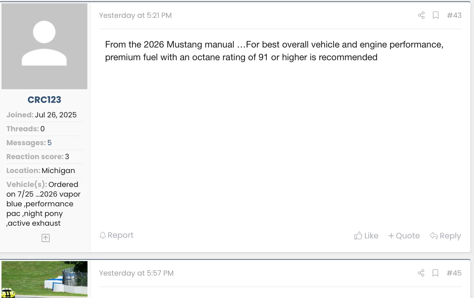

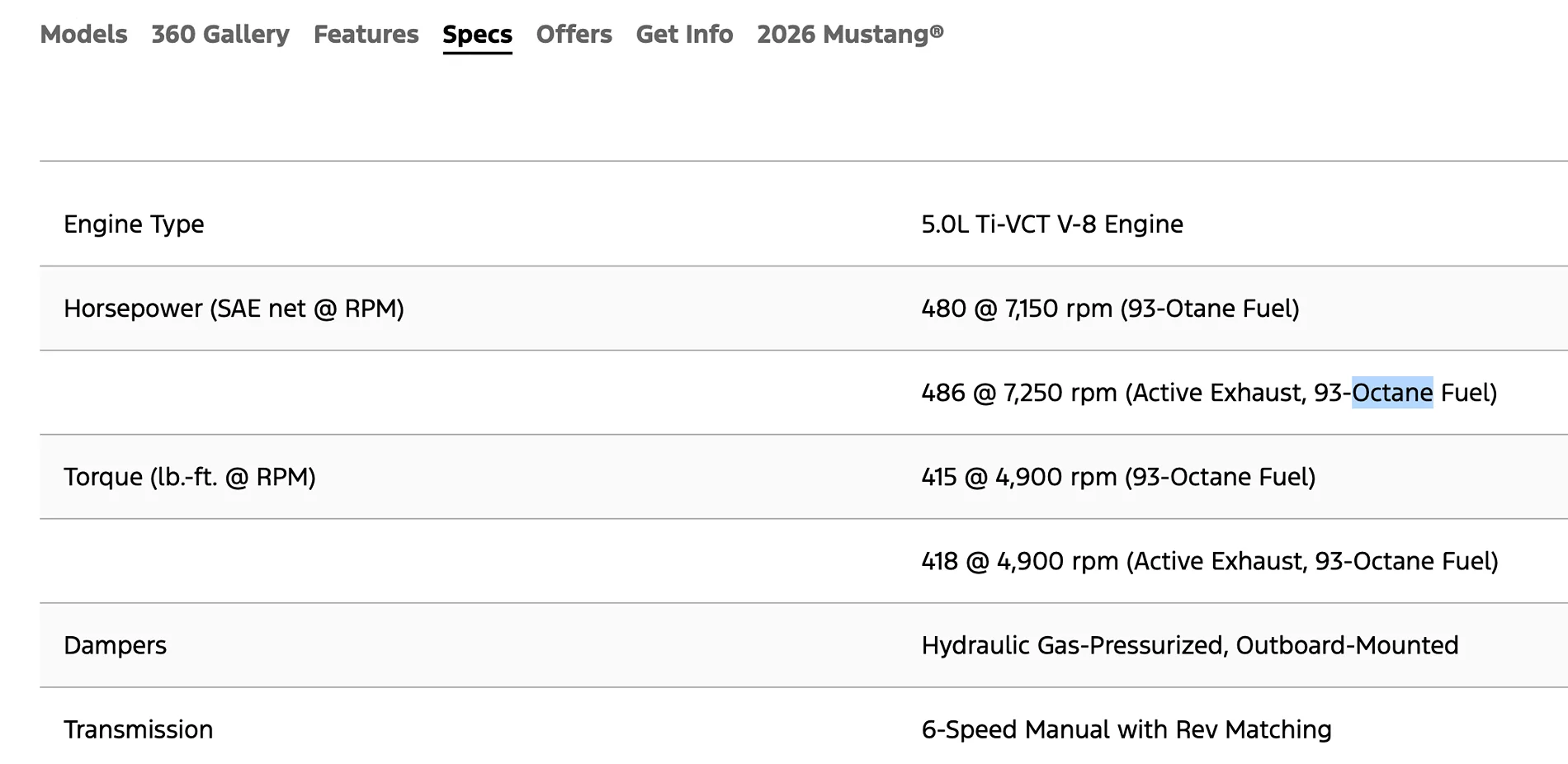

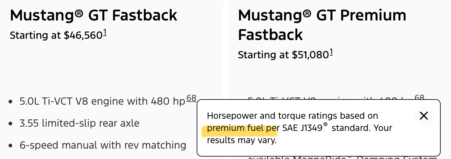

There should be nothing less that quality 91 in this (5.0) engine quality 93 would be the best without getting exotic. Shell's 91 has proven very good on the dynos in the past.
