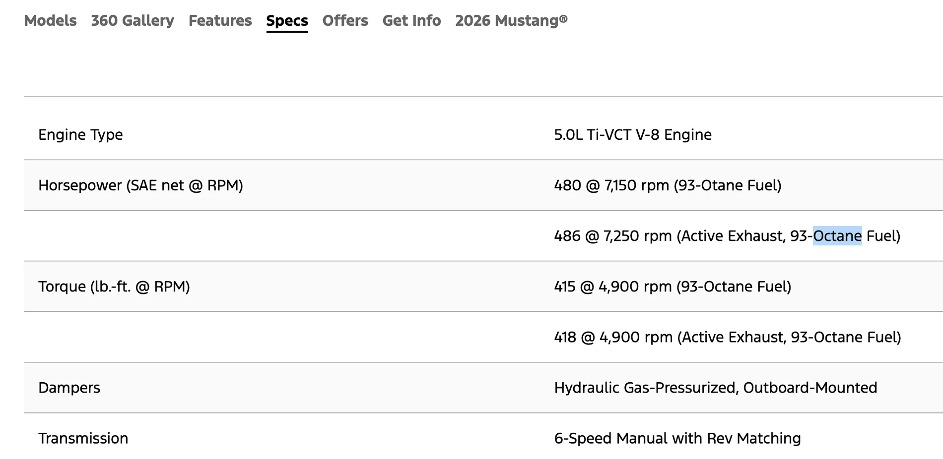

Ordered on 7/25 …2026 vapor blue ,performance pac ,night pony ,active exhaust
From the 2026 Mustang manual …For best overall vehicle and engine performance, premium fuel with an octane rating of 91 or higher is recommended
