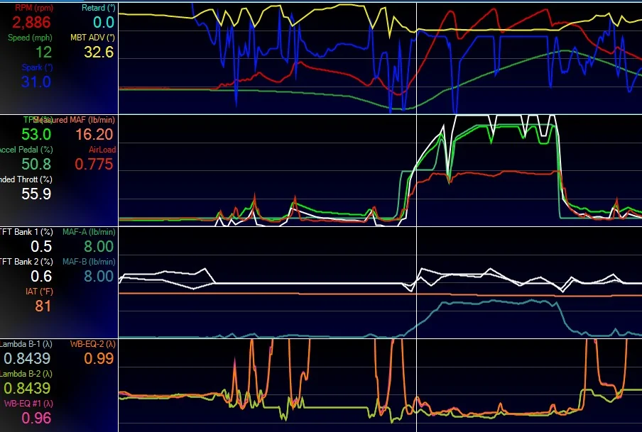

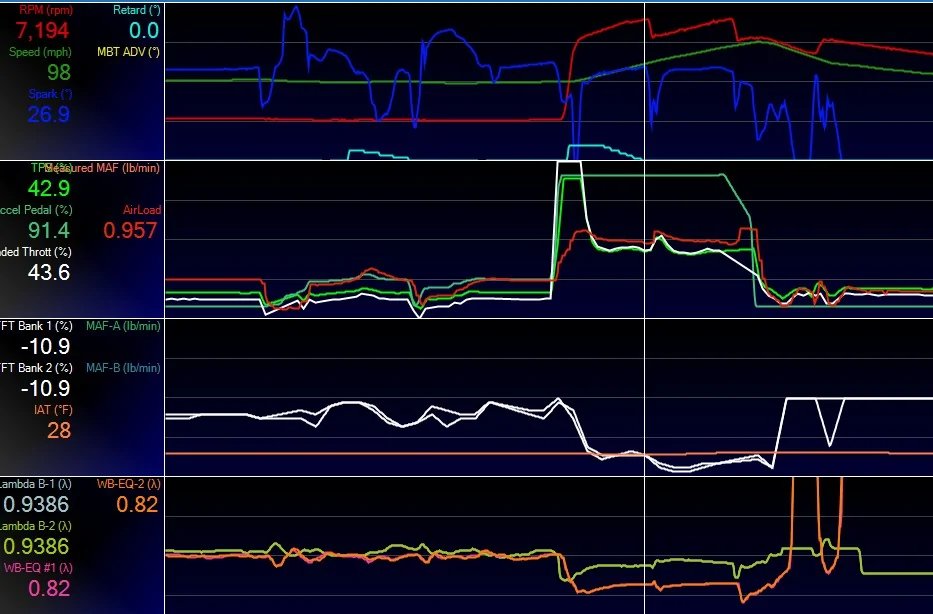

I logged Ethanol Free 87 [ Or as Some People would say, E85 with Zero Ethanol ] back in the Winter, 30degree IAT.
Had knock when I 1st floored it in 4th but it surprisingly cleared up and dialed in 26.9degrees timing and carried that thru 5th.
S650 Mustang Does 5.0 coyote performance improve with octane? EthanolFree87-OffRam
And No I don't use 87, I just tested it,
As for your question about how much timing can be dialed in on E85.
I'm seeing 31,6. And that's ramped in by 2800rpm.
Hence the reason tooners warn you not to run 'low' ethanol E85 with an aggressive E85 tune. Unless you want new pistons.
S650 Mustang Does 5.0 coyote performance improve with octane? E80_Timing
