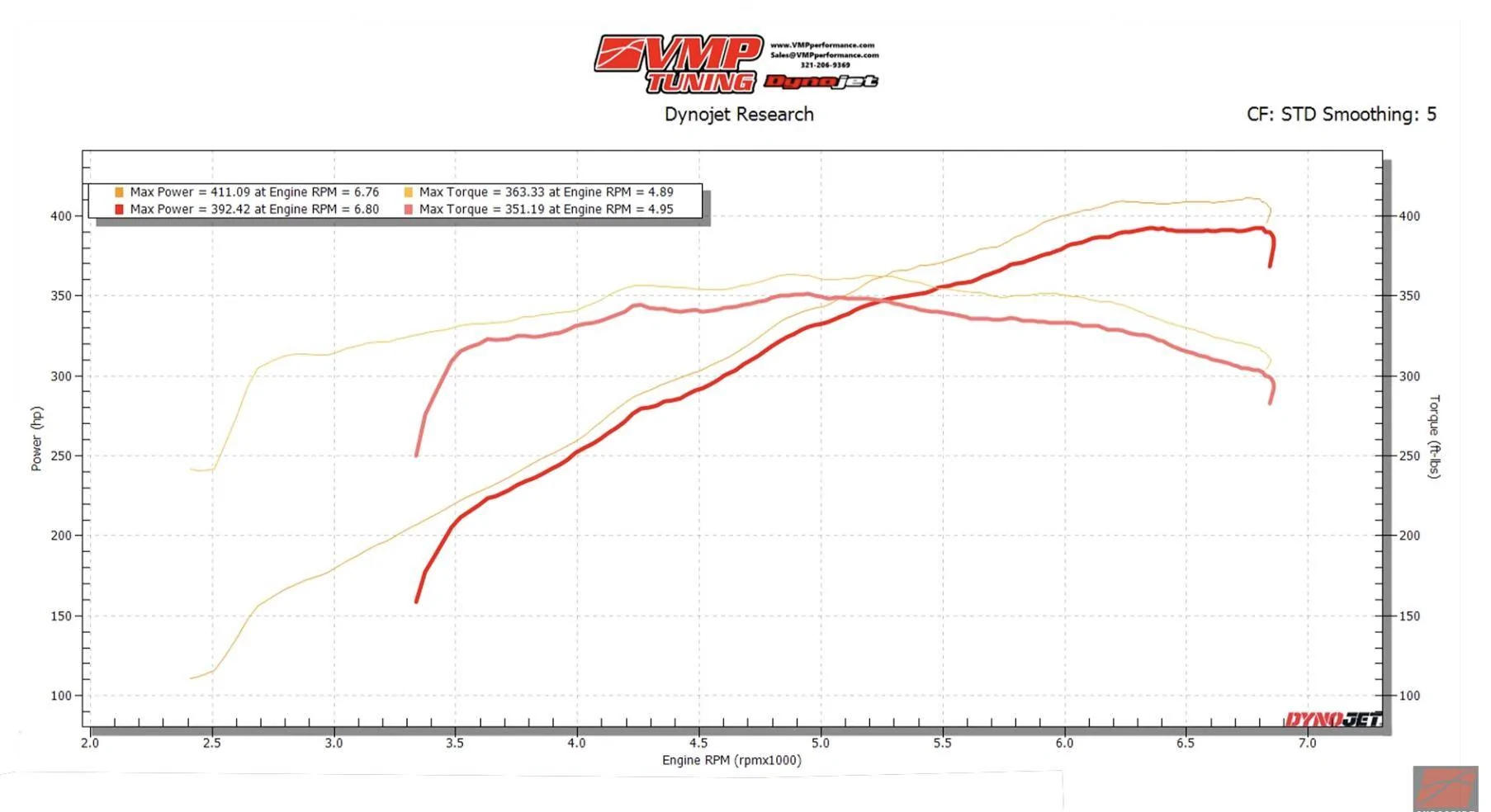

A while back VMP did some dyno testing that showed a ~20 horsepower difference between 87 and 93.
I would love to see a data log for the ignition timing on those pulls
There has always been a HP loss between 87 & 93 which is why Ford quotes all performance specs using 93. I recall the original numbers for Gen 2 were 10-15HP. The difference is a lot larger on the Ecoboost.

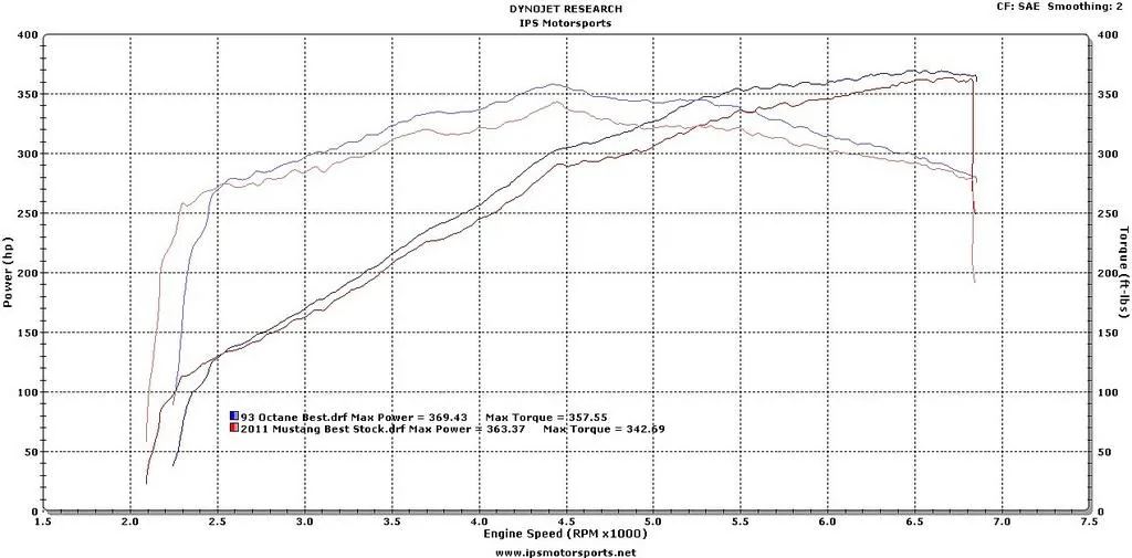

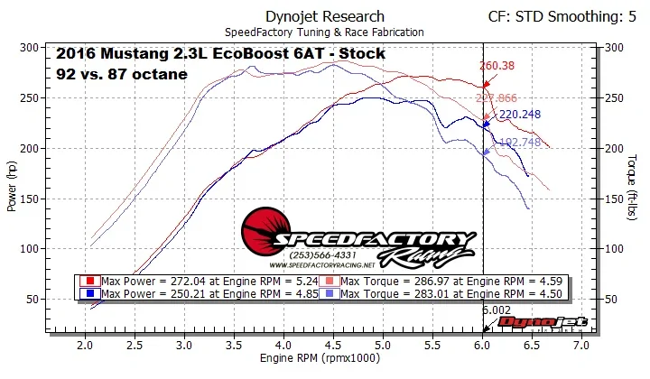

Here's some well-known charts, one is a gen 1 coyote and the other is an eco
S650 Mustang Does 5.0 coyote performance improve with octane? gen1_87_93
S650 Mustang Does 5.0 coyote performance improve with octane? how-much-horsepower-do-i-lose-for-putting-87-fuel-in-a-v0-jinn9uvb98yc1
