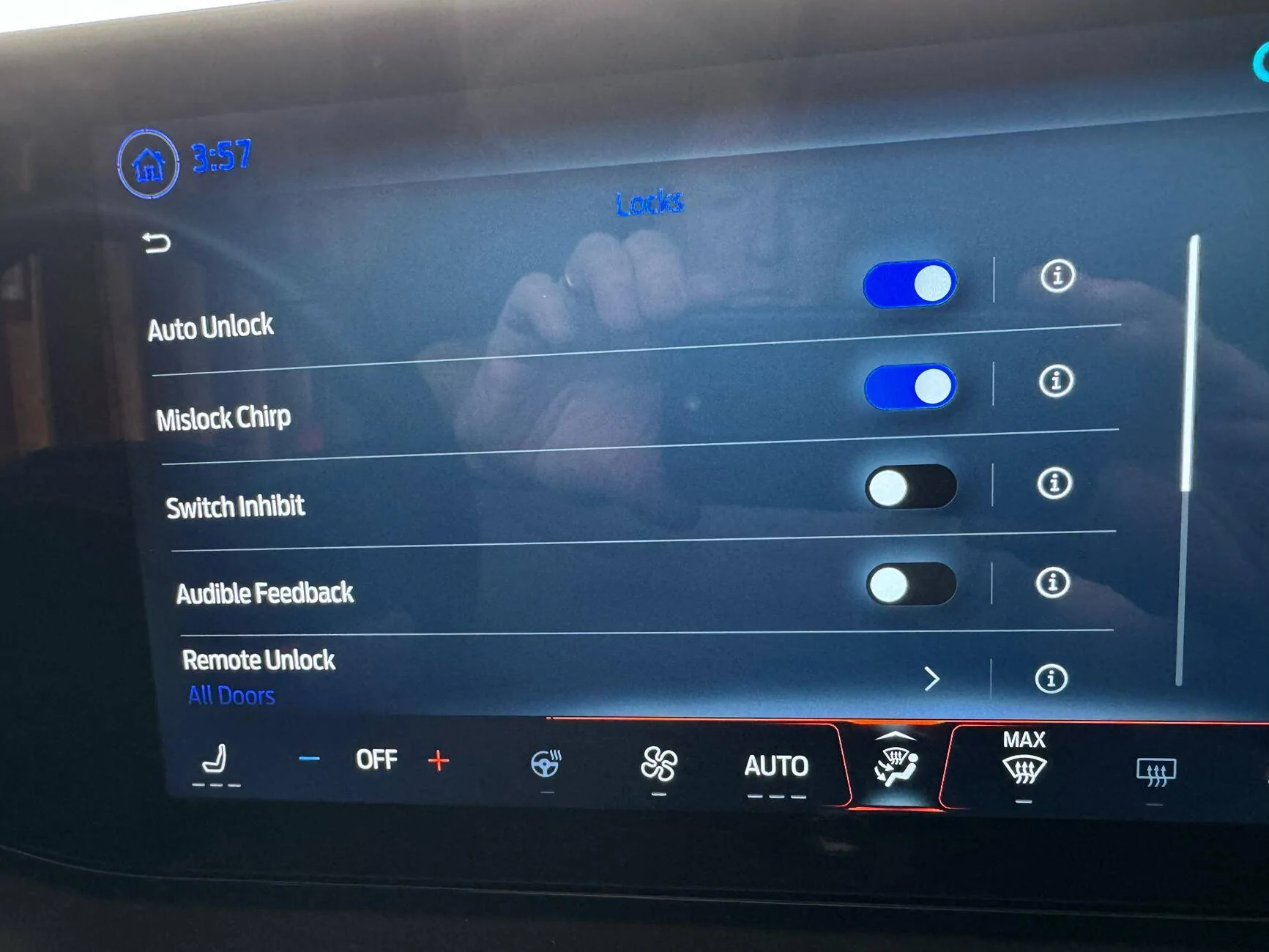

Has anyone been able to enable the "auto lock" toggle in the APIM? I enabled it on my 23 SD and my wife's SUV with FORScan in plain english. However trying it on the Mustang had no effect. Then I tried it in HEX and it still didn't work. I'd like to be able to turn off auto lock but it appears Ford has this one locked down (pun intended) on the Mustang unlike other vehicles?

I don’t think you are following. With FORScan you can add the toggle to the settings menus of the car. So it can be turned on and off through the vehicle settings menu. The Mustang comes with an Auto Unlock toggle in the lock settings menu. But not auto lock. I’ve added it to both our Nautilus and my F250. Adding it to the Mustang is not working through FORScan in either plain English or HEX.

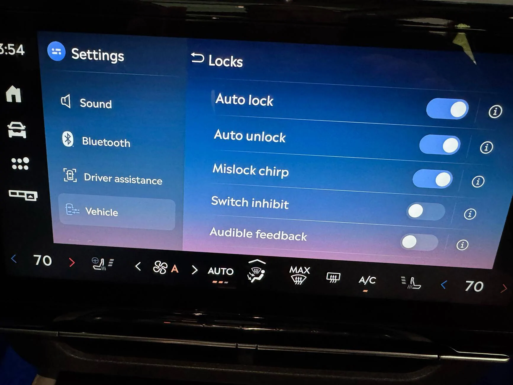

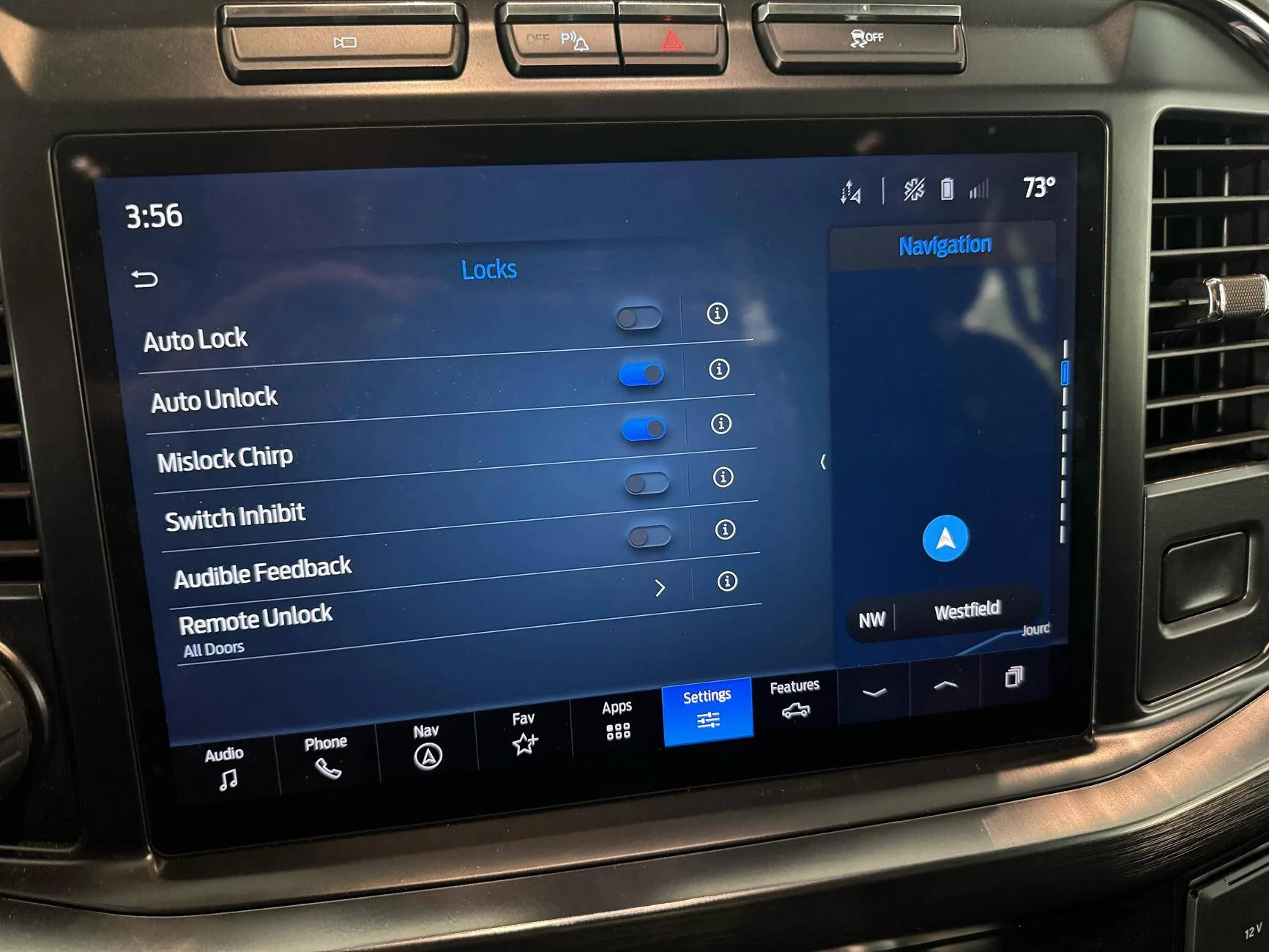

It absolutely works on both our Lincoln and Super Duty. Turn off auto lock and it will never lock. Turn it on and it will auto lock when the vehicle is in motion. I don't want to set either way in perpetuity. I want to set it to off for me paired to my user profile and on for my wife who likes it. Here are the toggles added to both of our other vehicles. They stay in their respective positions after key cycle and work as they should. Last pic is the Mustang without the toggle turned on with FORScan.

Neither. I want the auto lock toggle added to the settings menu.
