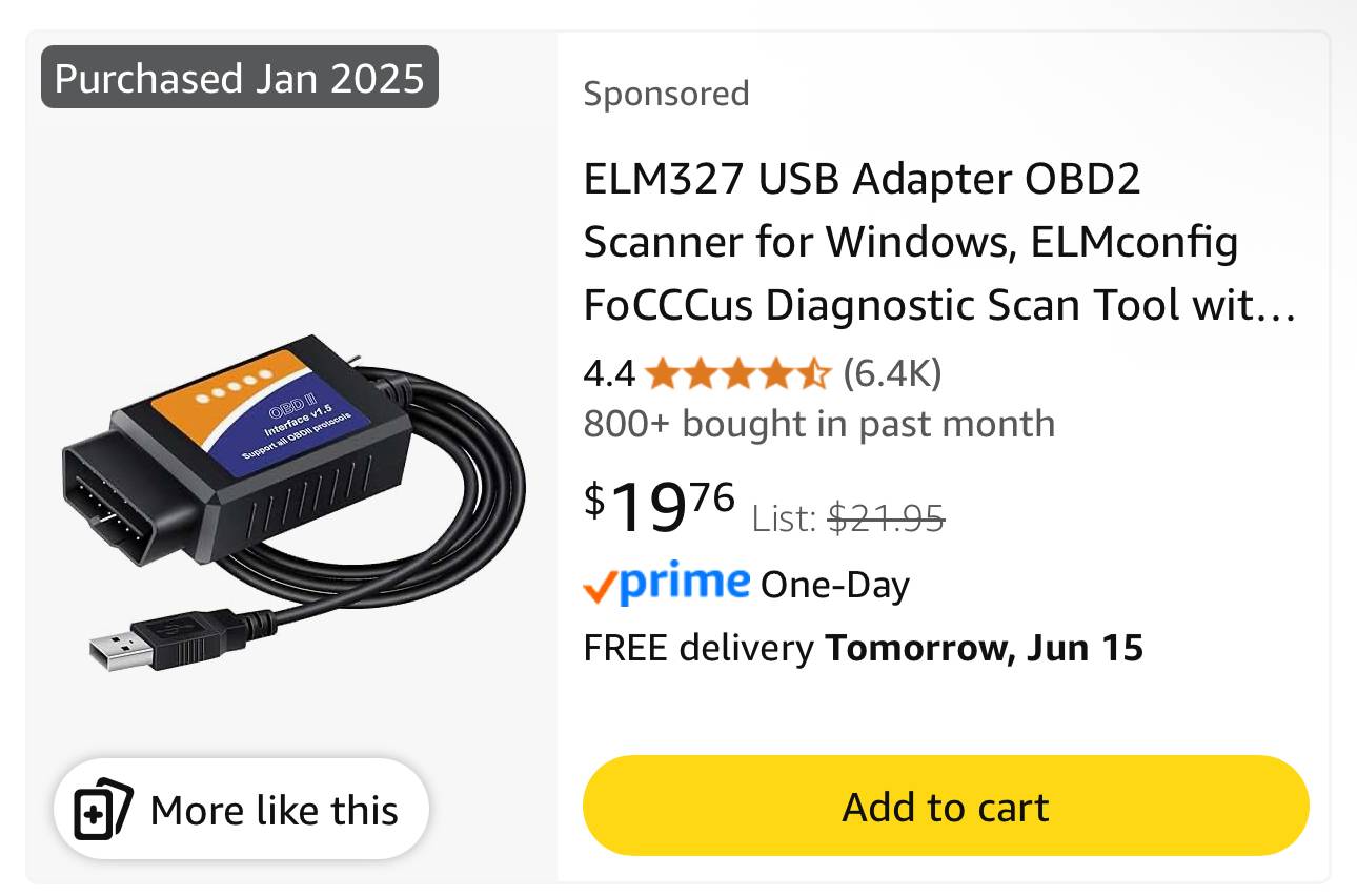

that's the same one I have. also I am trying to change my premium startup lights to dark horse light up but the codes are not the same compared to what the spreadsheet has any advice?
Mine is similar to that s well.
On mine the switch, in the manual, was incorrect. It was showing it the opposite of what is was. Trying using it in backwards, of what is says, and see if the modules show. Also, make sure you have inserted it fully into the ODBII port.
acenawz
Jun 10, 2025
maryland
2024 mustang gt premium
It ended up being a bad cable. I just ended up buying a new one and that solved the issues
