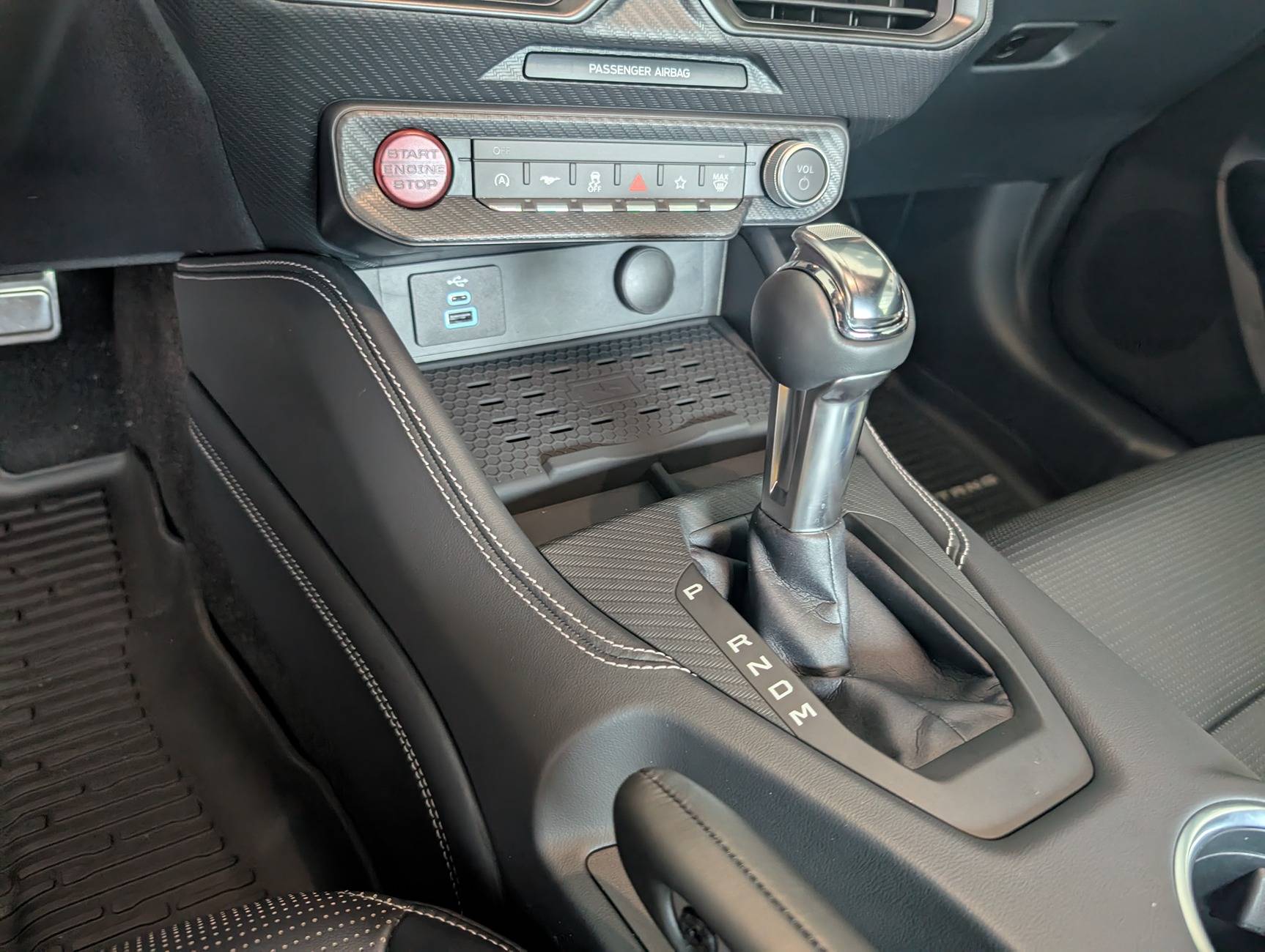

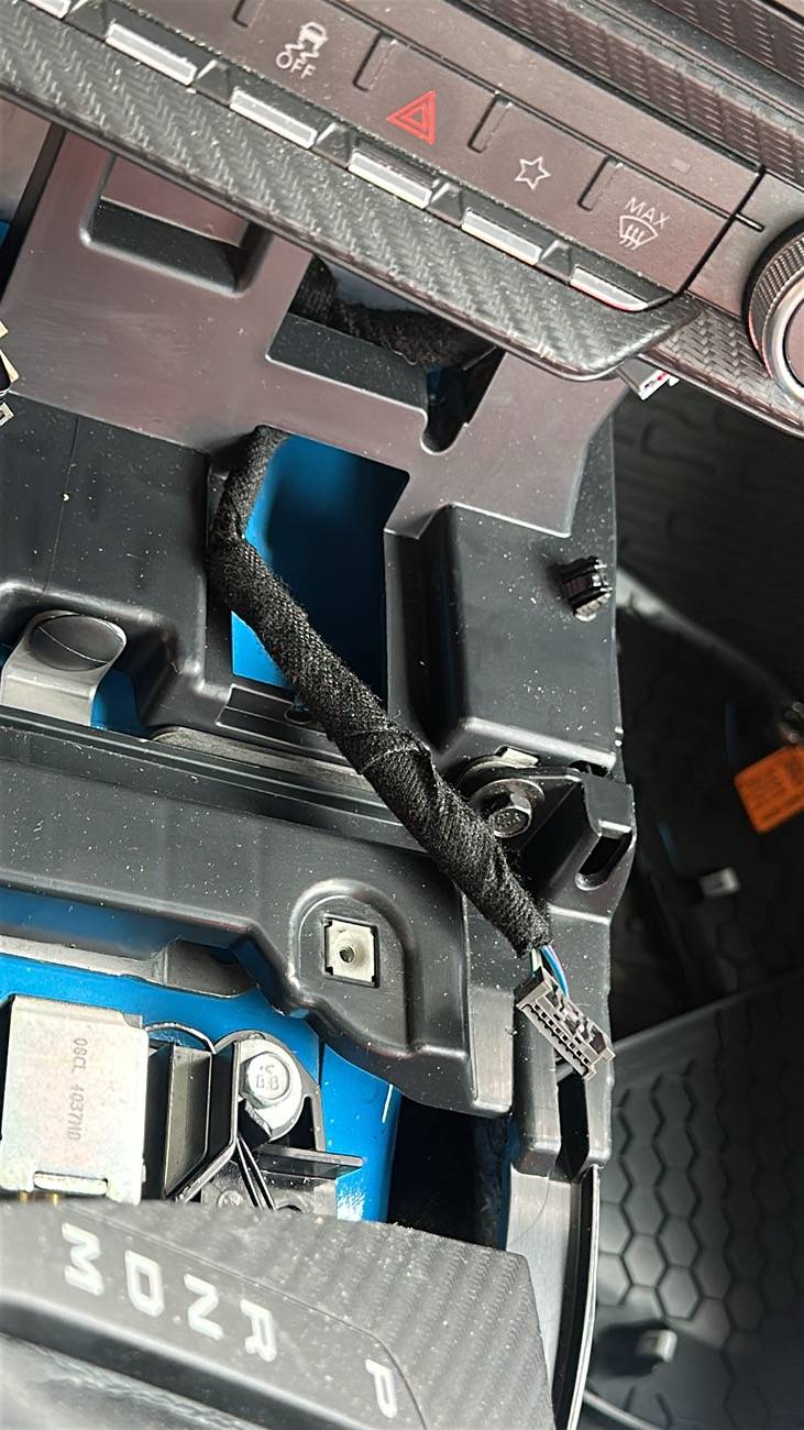

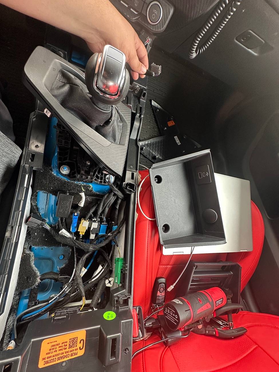

Wireless charger has been installed successfully in my 301A package 🫡 it was indeed already wired just tucked away. Regarding overheating I’ve been using it for several days now and it does not overheat at all. It gets a little warm but that’s the same as charging with a cord. Phone: iPhone 14 Pro Max.
Very happy with my purchase. I have a silicone mat being delivered hopefully in the next 10 days.
As @erasat mentioned it came pre loaded with the forscan settings, just needed to update the BCM line: 726-59-01

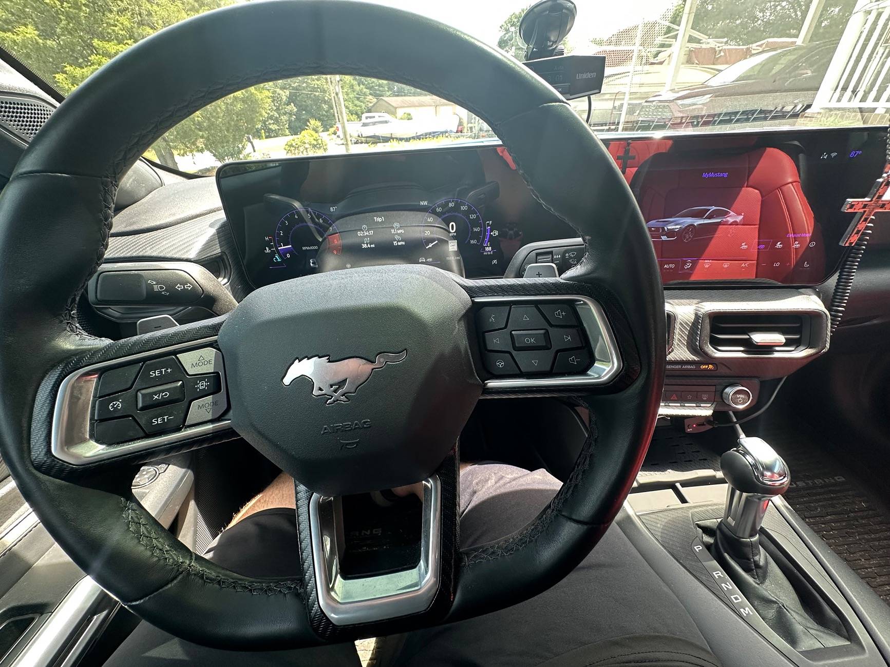

I now have ordered a Premium Screen which is also going to be fully plug n play as they are basically monitors and that’s it lol.
I’ll update yall once it arrives with the install and how it turns out.
Yeah, with the Homelink Sun Visor, OEM Leather Seats, Illuminated door Sills (without light because no pre-wired), Premium screen and the Wireless Charger, my 300A group PP looks like a Premium one so I'm good with that.

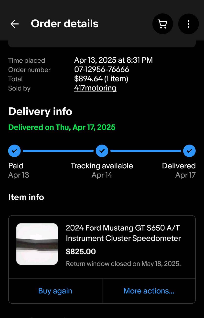

Hate to be the bearer of bad news, but I think you may have gotten screwed on that display if the information on parts.ford.com is correct....
Full one piece display at parts.ford.com 586.95

I initially had the same thought process, I went to a ford dealer and asked for the part and they said that was the incorrect part and the correct part is actually $1,500 MSRP and they sell for $950 through that specific dealer and there is a core charge which would bring it to $2,000

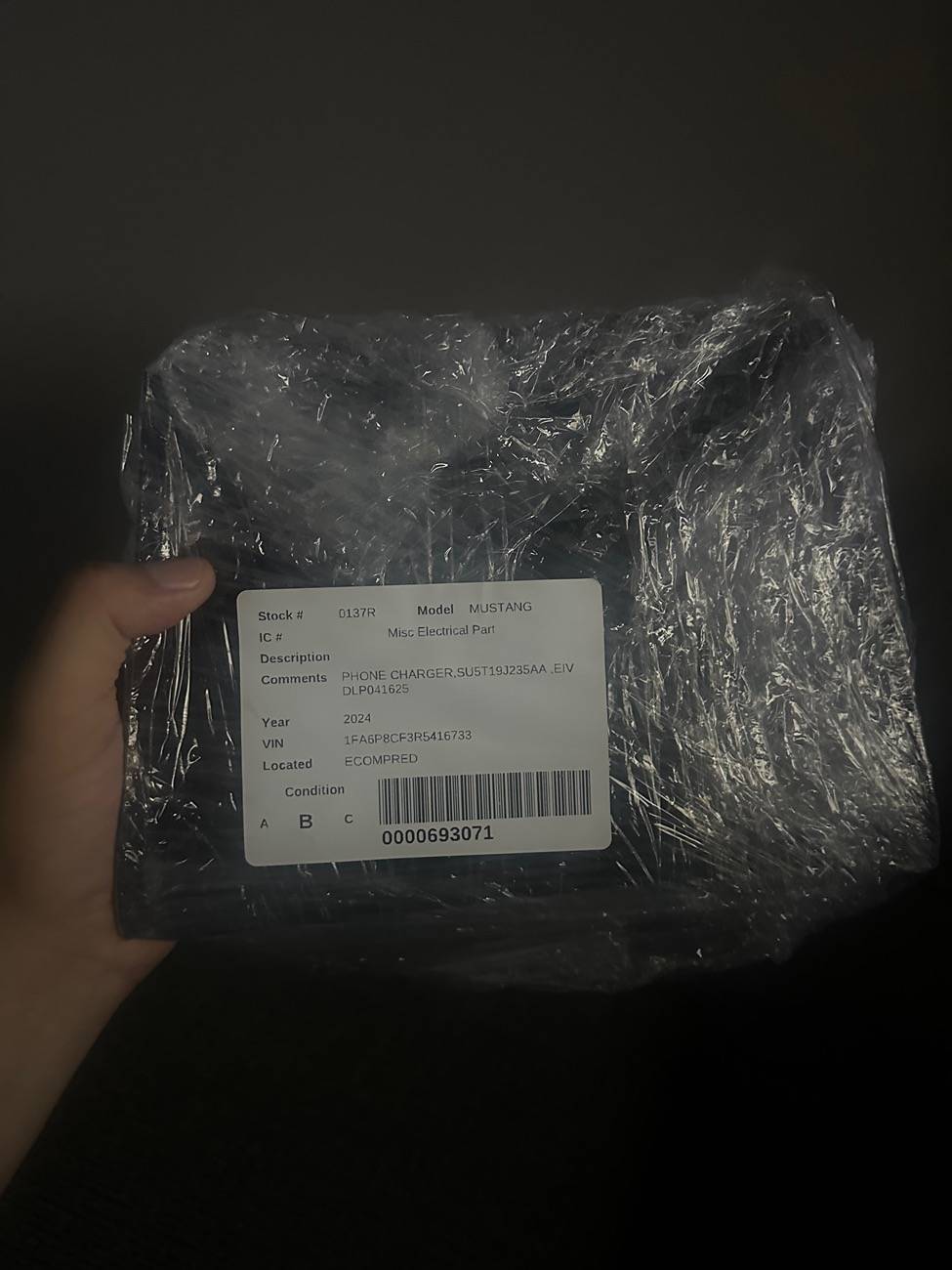

Yep! Glad that I did as well, I actually bought the display from the same seller that I bought the wireless charger from specifically because of the smooth process and how it wasn’t sketchy etc. looked exactly as described. And agreed a lot of people won’t check. I will admit I don’t know if the dealer was telling the truth and was just trying to upsell but I just wasn’t willing to risk throwing away $600 for nothing you know? Plus they showed exactly how they got the display:

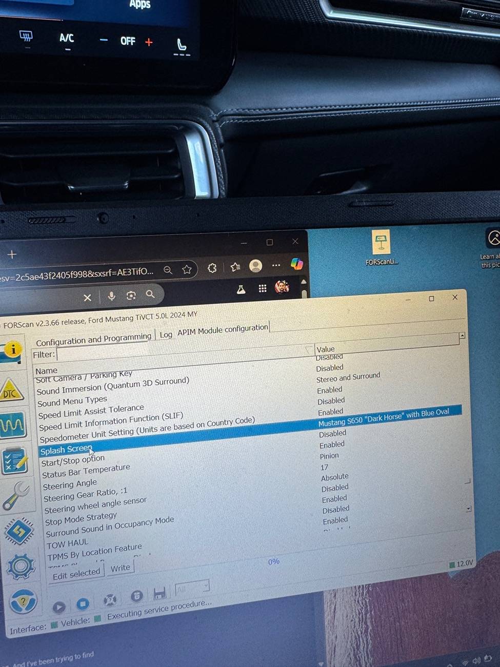

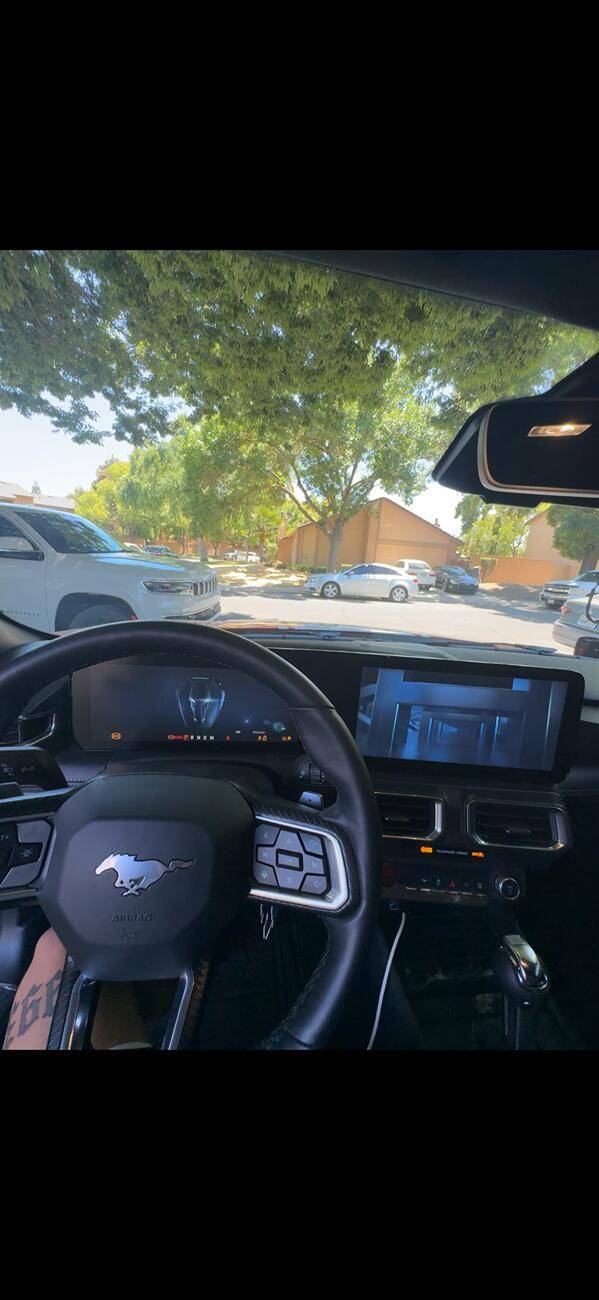

Sep 26, 2023
Modesto, CA

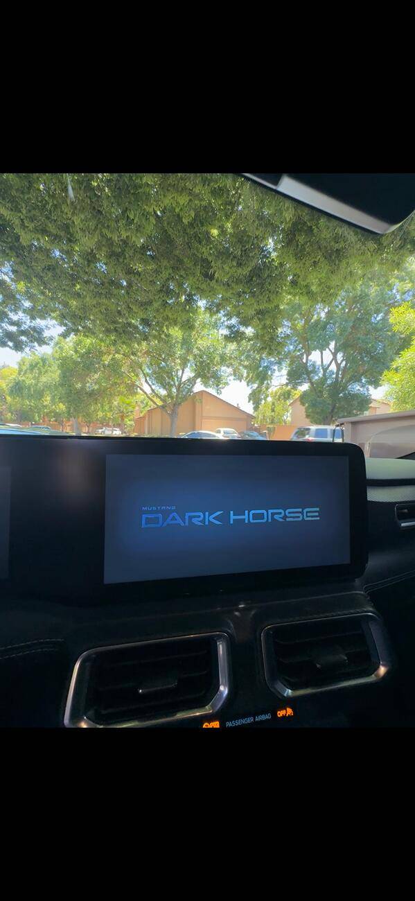

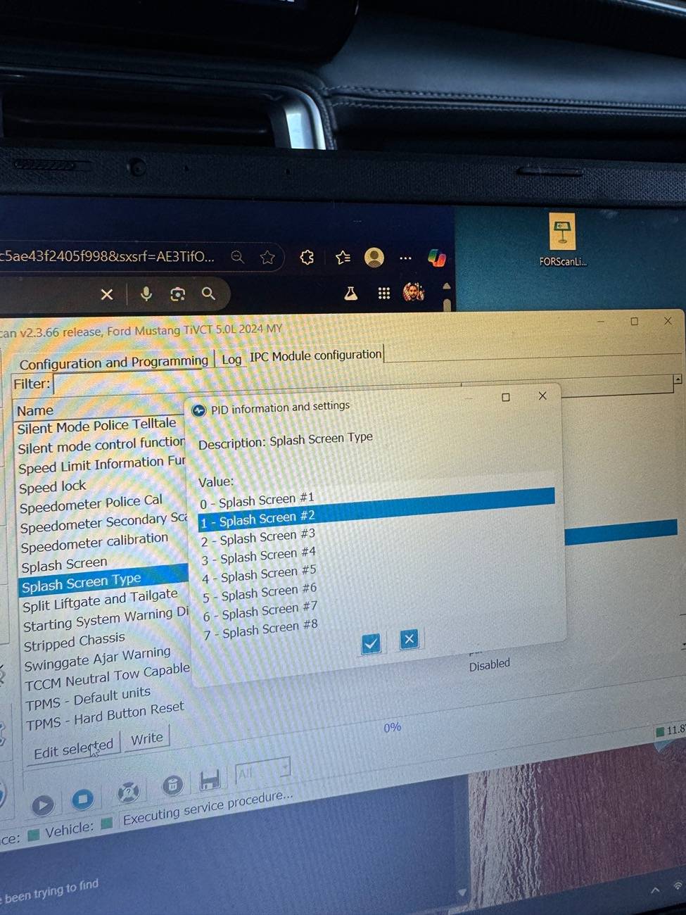

on forscan easy mode To get the dark horse startup on dash go to IPC module on easy mode and select splash screen #2.
to get in on the radio go to APIM module and change it to whatever you want for the stereo. I selected the dark horse with oval and now I have the dark horse start up on my 400a GT mustang

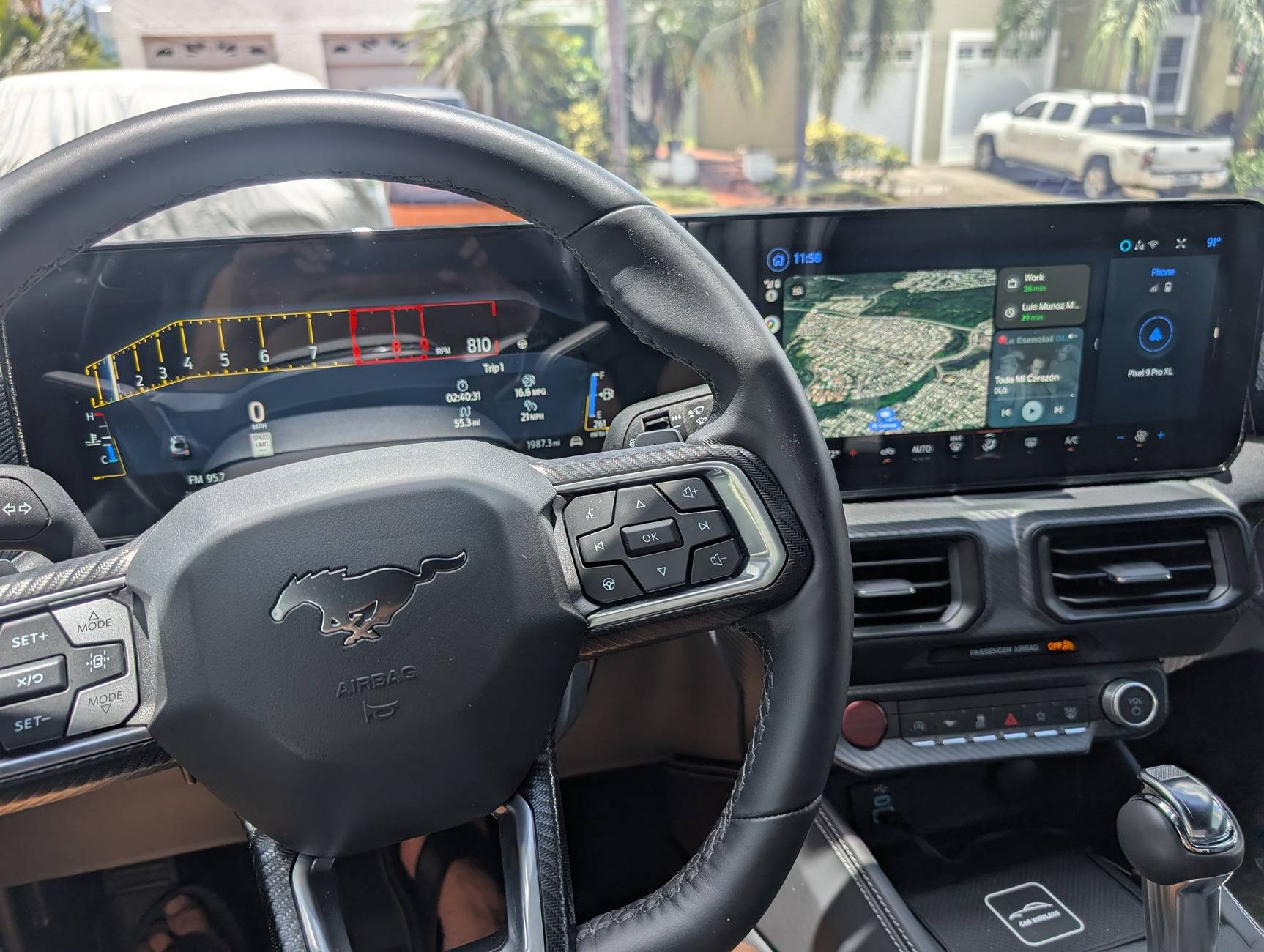

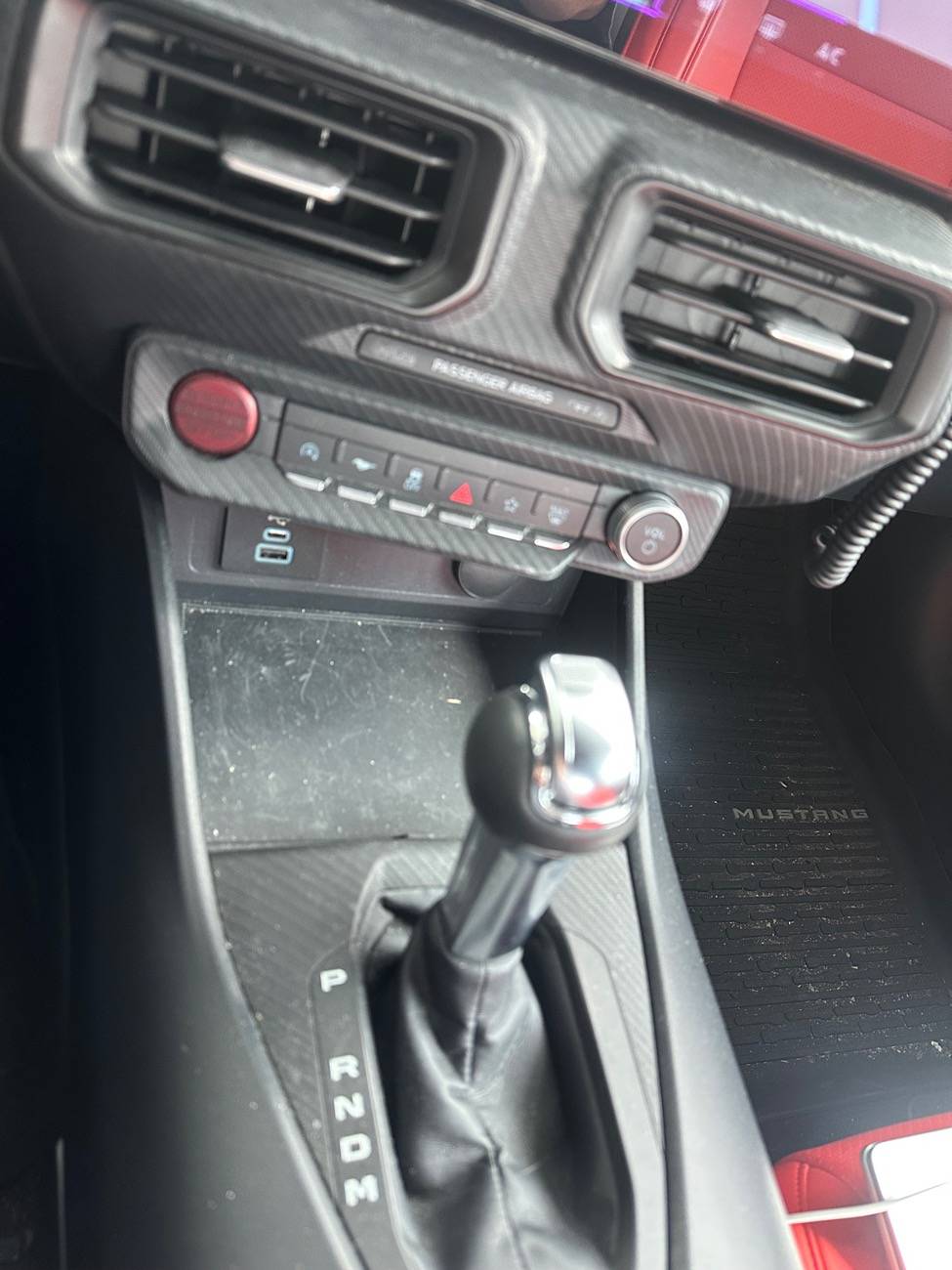

Little update on my 301A - The OEM Premium Screen & OEM Wireless Charger are both installed and working perfectly. Very happy with this decision. I’ll include a before & after photo.
After

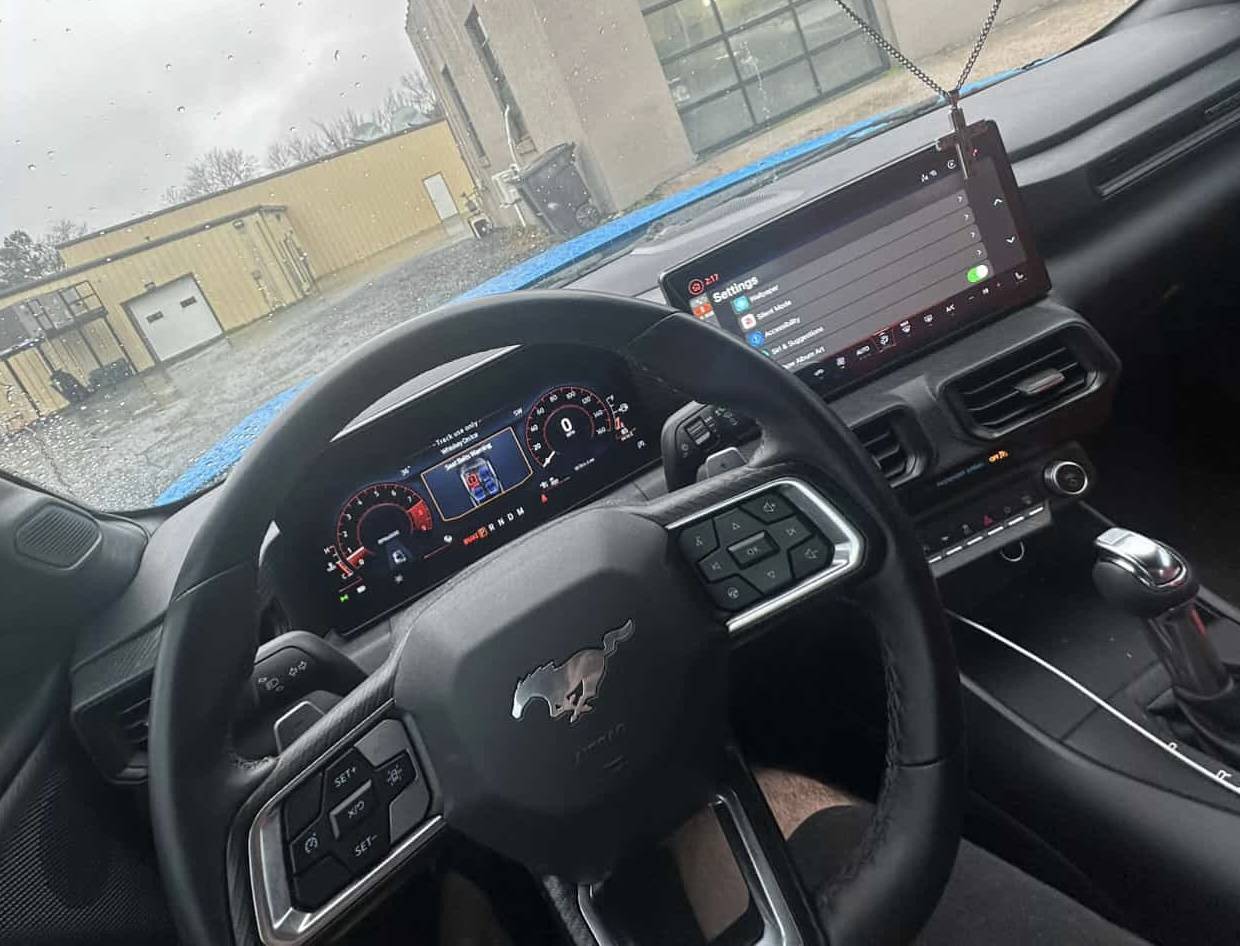

Hi, imusing the ms/hs switch obd2 reader but it's not showing me any of the ipc options on for scan also I tried to turn on the dark horse lighting on my premium s650 but the numbers are all different compared to what im seeing on spreadsheet and on videos. please help.

Hey, this is the one I’m using. However, it is not the recommended cable as some have issues with it to my understanding. Some other people in here should be able to tell you other options hopefully.

that's the same one I have. also I am trying to change my premium startup lights to dark horse light up but the codes are not the same compared to what the spreadsheet has any advice?
