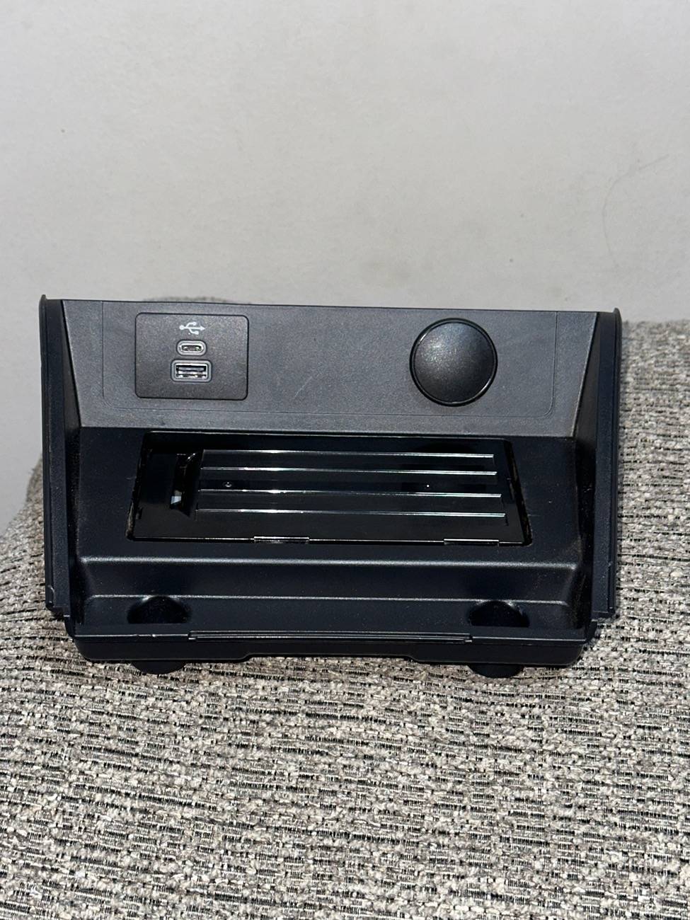

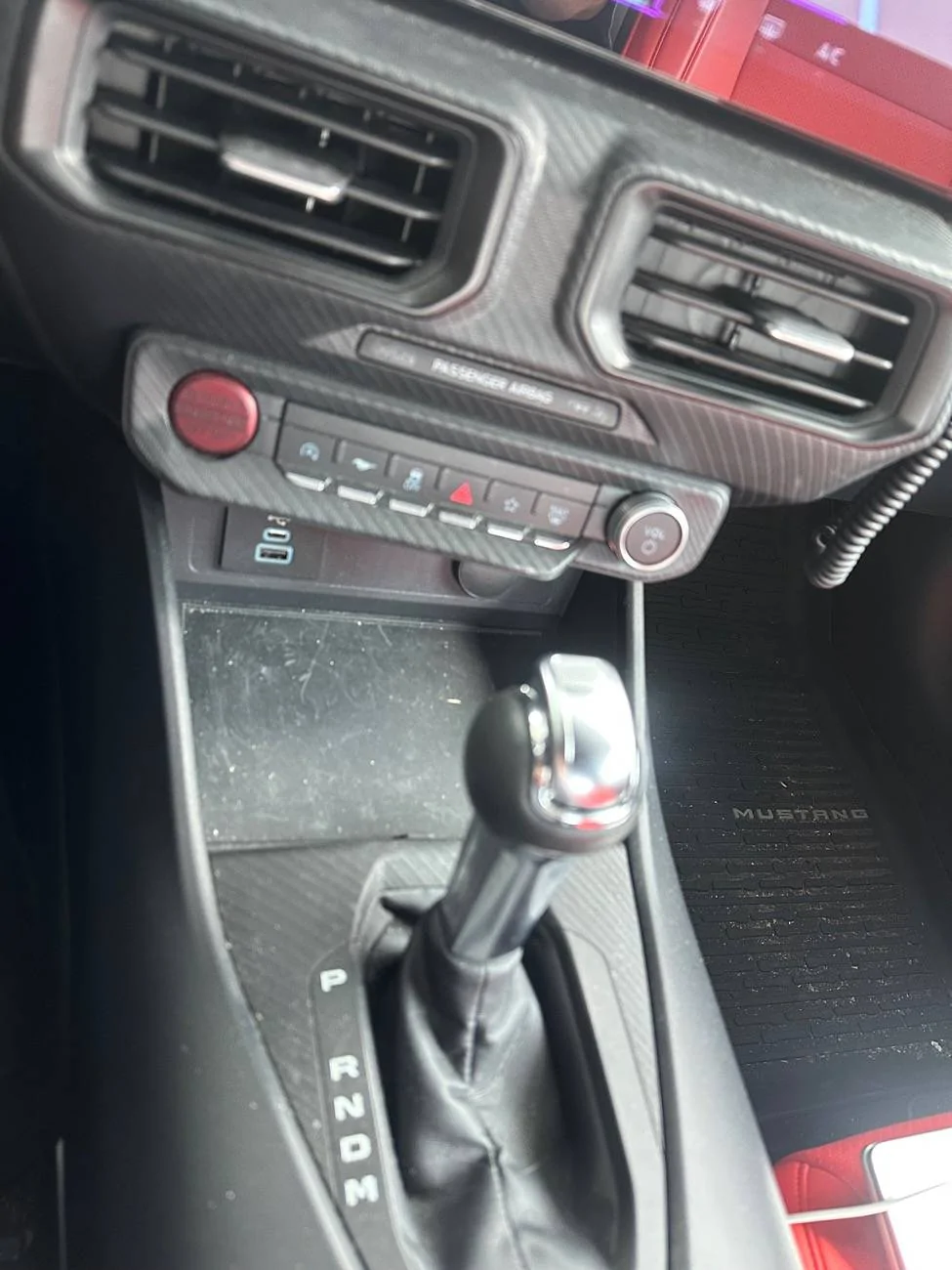

Finally received today the Wireless Charger Pad Module, the whole take off kit that I bought on eBay 3 weeks ago. It had everything except the rubber pad but I got a new one from Amazon, not OEM but I think it works and looks better than the OEM one.
Here to confirm that once the pre-wired cable and connector is connected to the Wireless Charger Module, the car recognize it, and after running ForScan and not loading the Saved Profile and let it detects all the modules including the new ones, all the values that you gave me here were already there, so they come preloaded on the module. The only one that needs to change is the BCM one, the 726-59-01.
So far so good, it definitely looks better, at least for me, and it recognizes the phone and start charging on par with the ones on my Ioniq 5 Limited and Tesla Model Y.
Thank you.

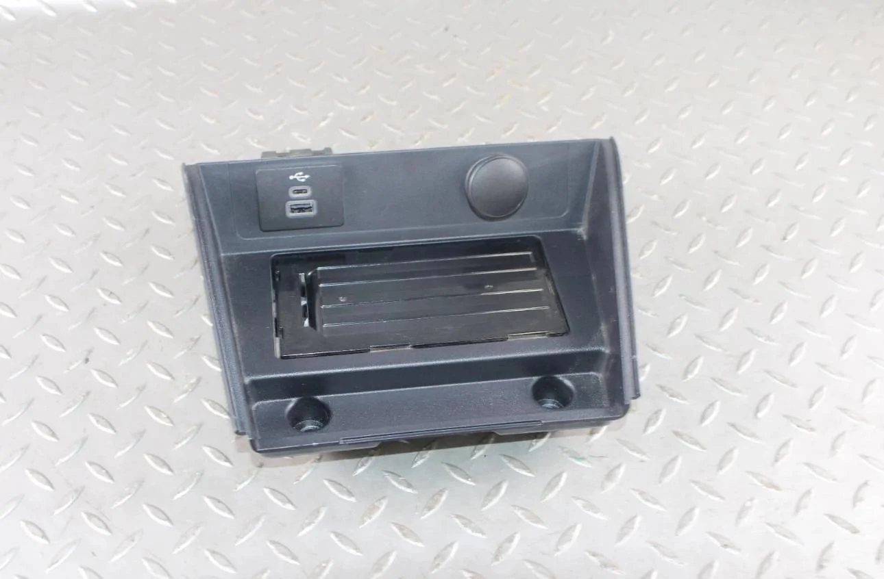

Ordered a wireless charger take off.

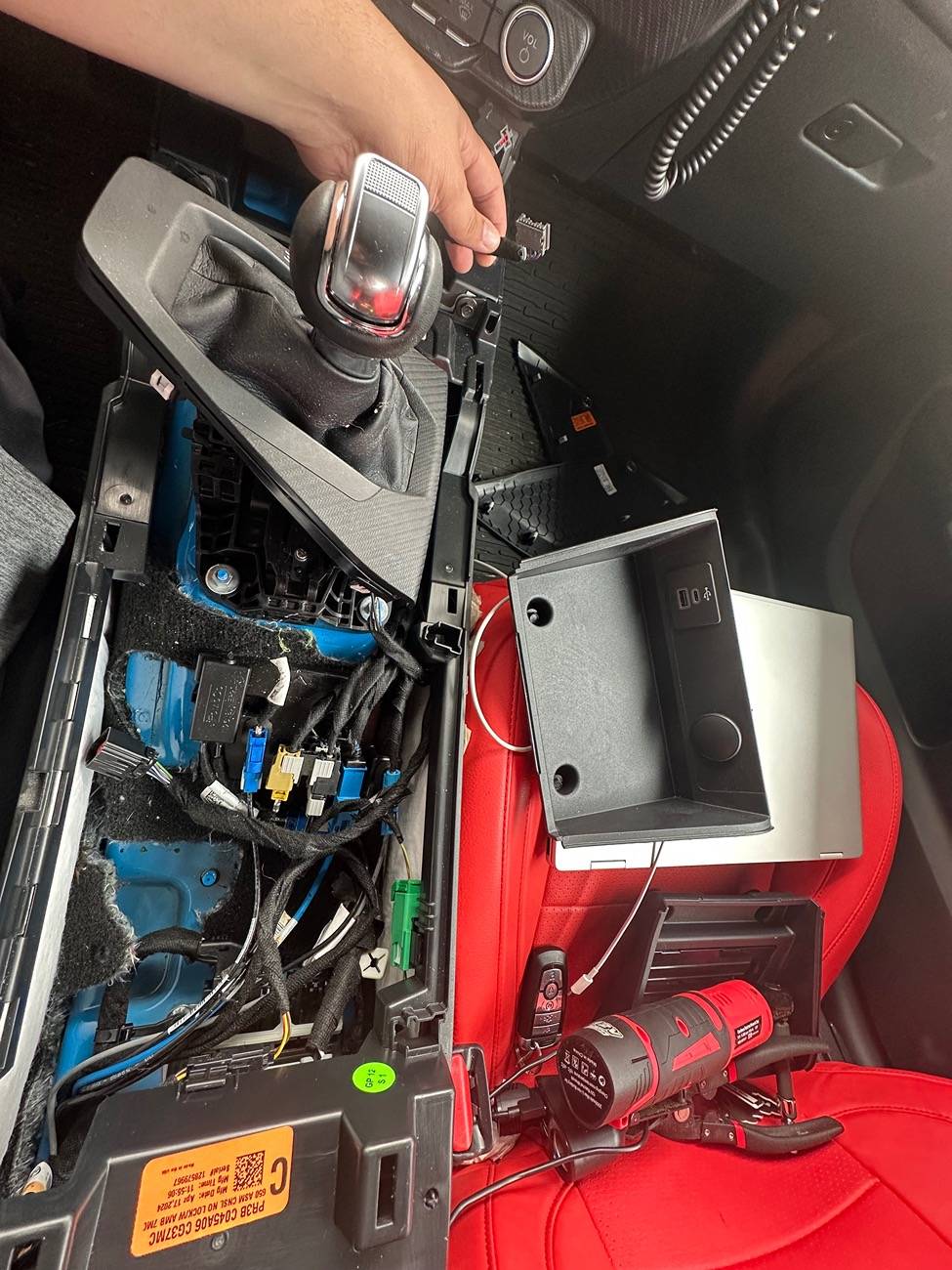

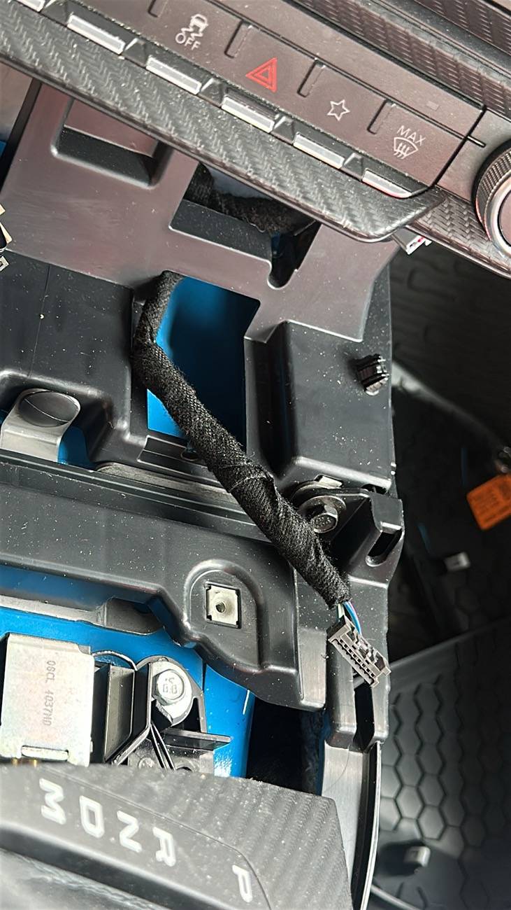

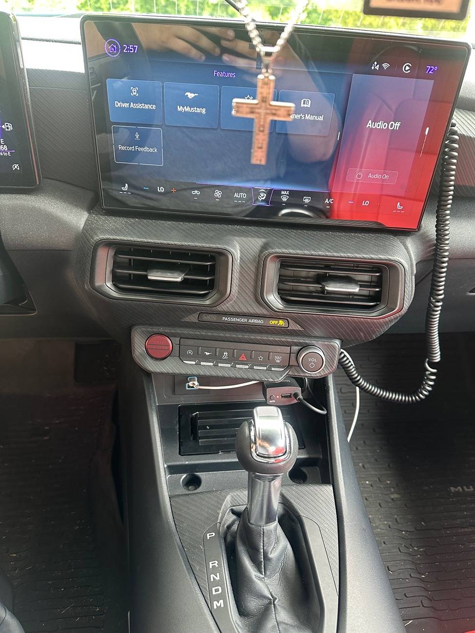

Wireless charger has been installed successfully in my 301A package 🫡 it was indeed already wired just tucked away. Regarding overheating I’ve been using it for several days now and it does not overheat at all. It gets a little warm but that’s the same as charging with a cord. Phone: iPhone 14 Pro Max.
Very happy with my purchase. I have a silicone mat being delivered hopefully in the next 10 days.
As @erasat mentioned it came pre loaded with the forscan settings, just needed to update the BCM line: 726-59-01
