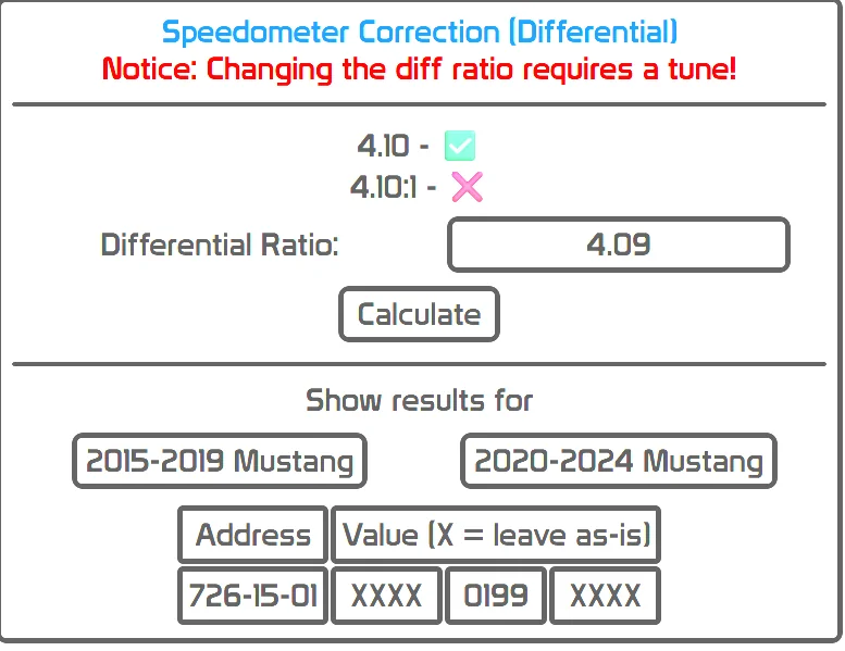

Sorry, I couldn't find it. Are we able to change drive ratio for final drive through Forscan?

Sorry, you may need to explain this to me a tad.
Im showing putting in 0199 for the 2024 Mustang
it's because the data is in hexadecimal. check first that value in your BCM and let me know if it says "0175" or something else
here is how the ratio is calculated:

2,686

I don't think you can change the ratio with Forscan, it says requires a tune.
