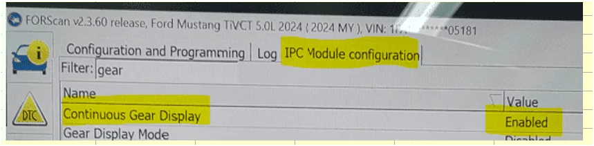

For all those that have A10s, if you haven't added gear indication displayed continuously in the Tach display using FORSCAN, you r missing out !

This is one of the easiest changes in FORSCAN, see below.
Maybe for you, but I don't want to end up with a paperweight! Why Ford, in their infinite wisdom, would not turn that on as the default is beyond me. If there were no paddles, I could understand it. Glenn

I agree. In Manual mode, it comes up very small near trans mode on bottom display. OBTW the scary part of FORSCAN is getting started with cable purchase and FORSCAN App. The Trans Indicator is one of the easiest to change, just change DISABLED to ENABLE. Most other changes require changes to raw, multi characterter settings.

Yes! I've seen some screens in FORScan and that's why I am not sure I want to mess with it. However, you make it seem like this one is easy enough and I really want the gear displayed. I may have to venture into the unknown! I do have the screen print! Thanks again! Glenn
