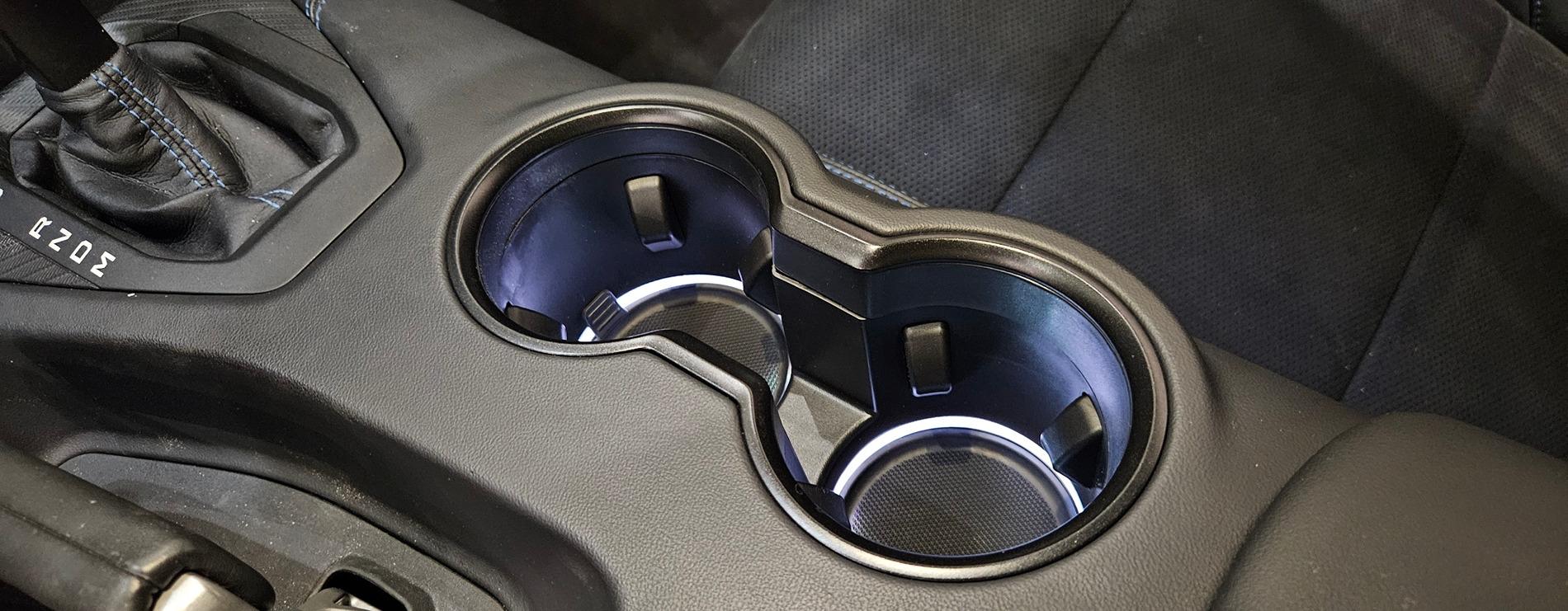

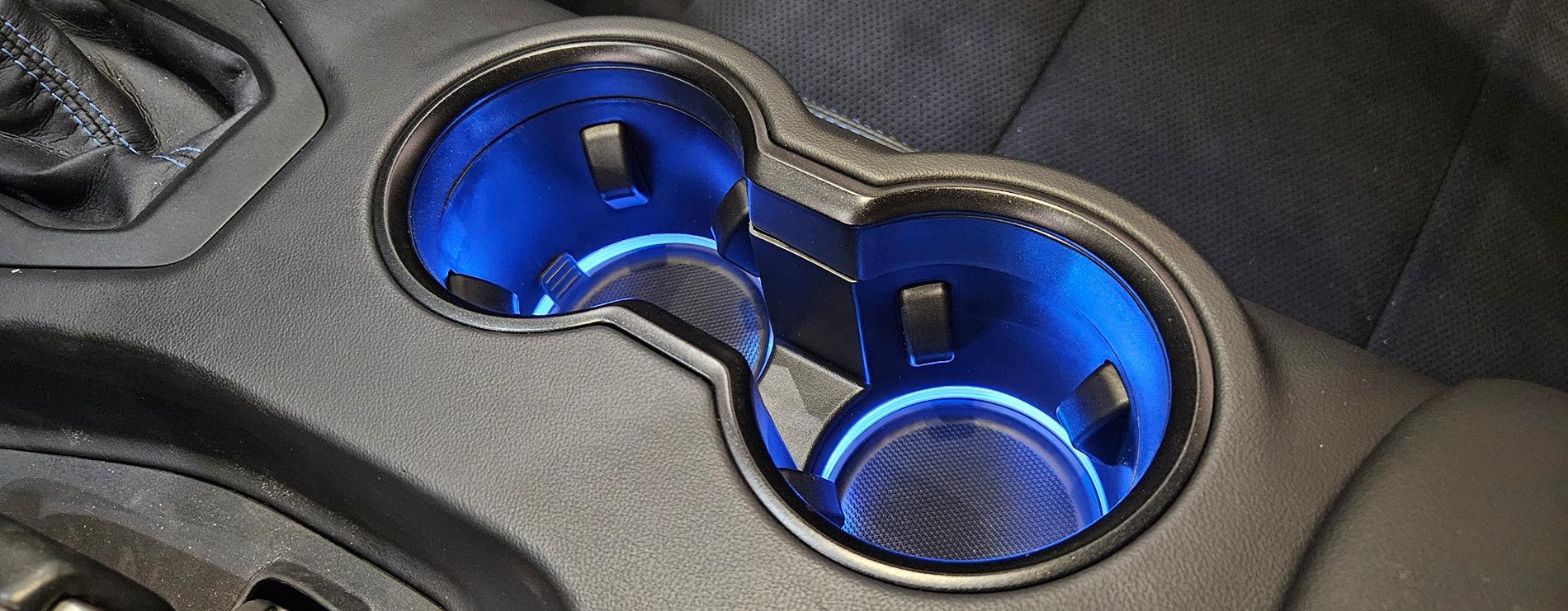

i took about 4 hours to install the cupholder lights. so happy with the result! i even wrapped the wires in tessa tape so it looks fairly factory
Out of curiosity, since brightness is relative, etc, blah blah. By any chance is it bright enough to be perceived by peripheral? Checking for the corner distraction light potential. You know, that type of light dad would tell you to turn out while he was driving type of thing.
i would say no. you can see it out of the corner of your eye, but its not really distracting, at least to me
Awesome! Professional looking install with bang for the buck result!

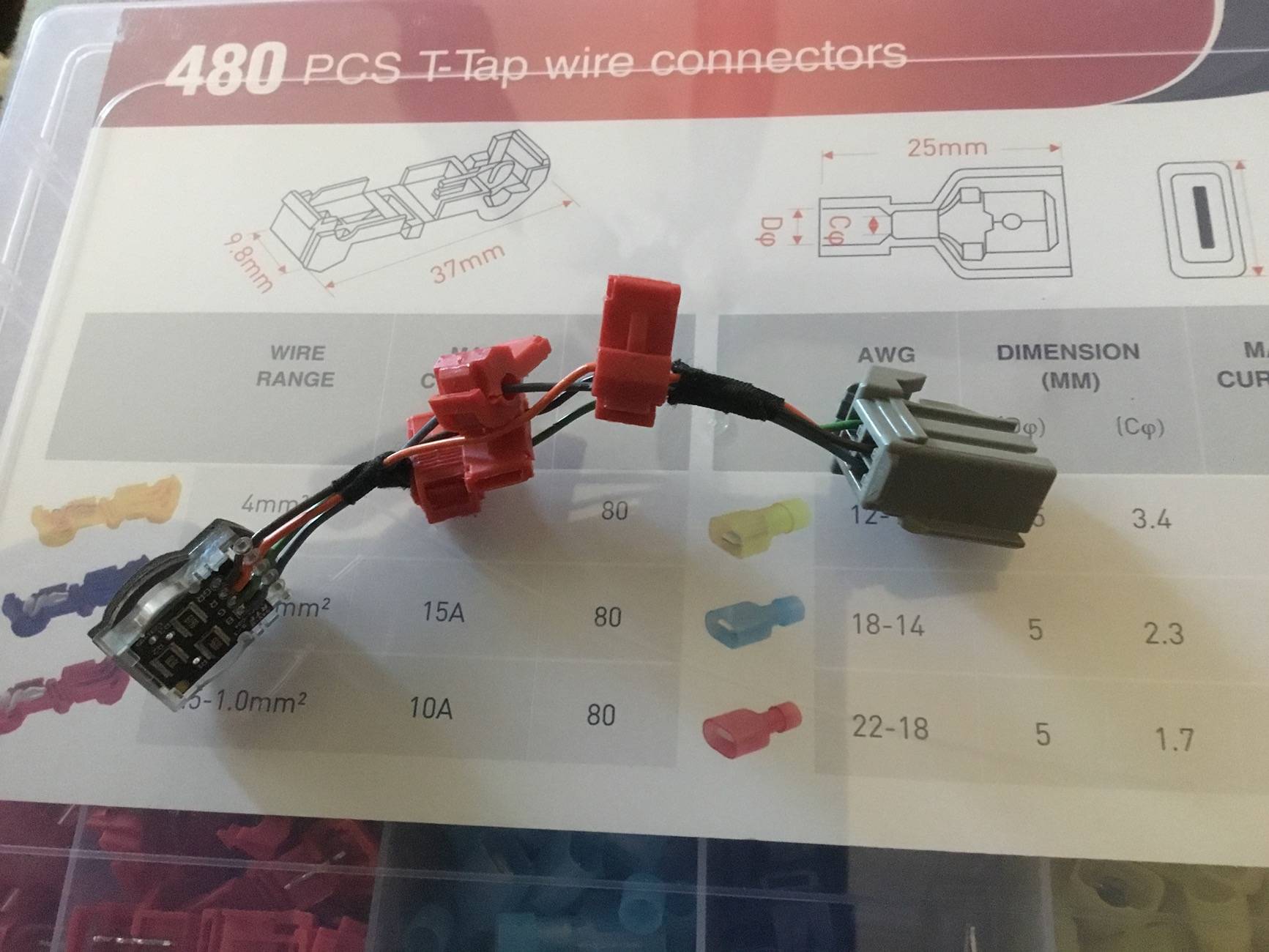

I can make a plug and play harness for this in case people don’t want to cut in to their factory harness. I’ll sell them for $150 each + shipping. If anybody is interested, let me know.

damn i haven’t looked into this in a minute lol. i’d have to get both plugs male and female and then convert it to a Y plug that’ll go into the cup holder.

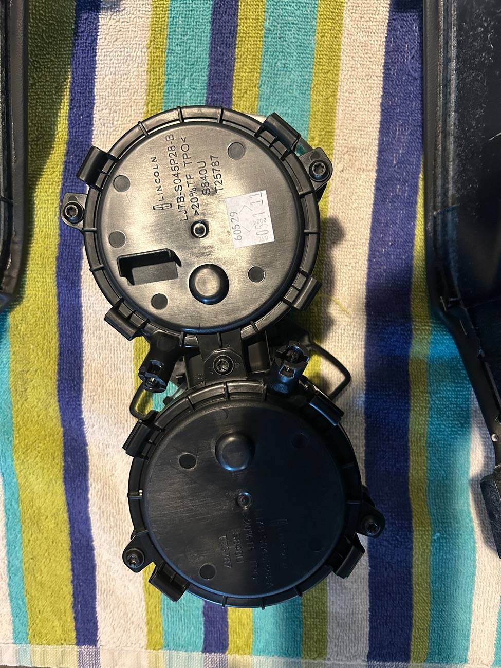

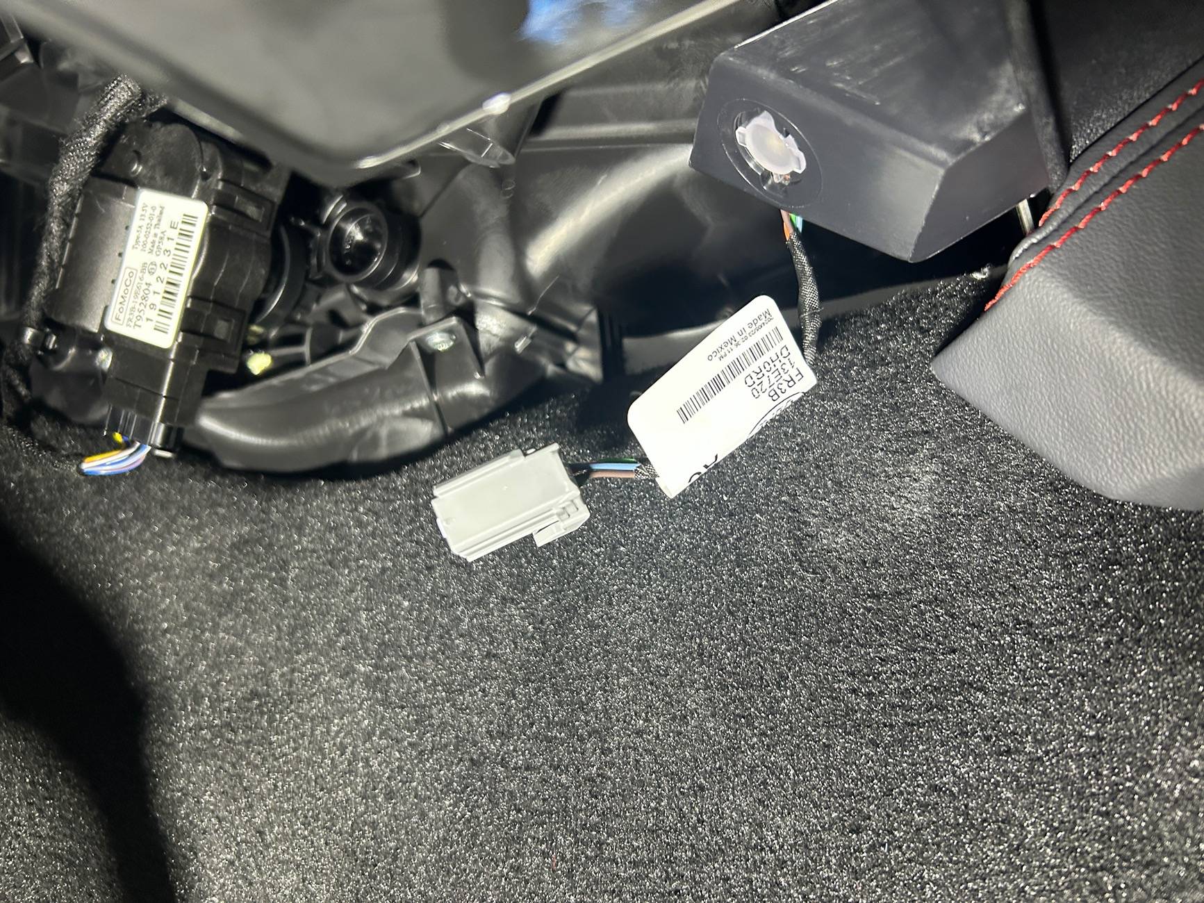

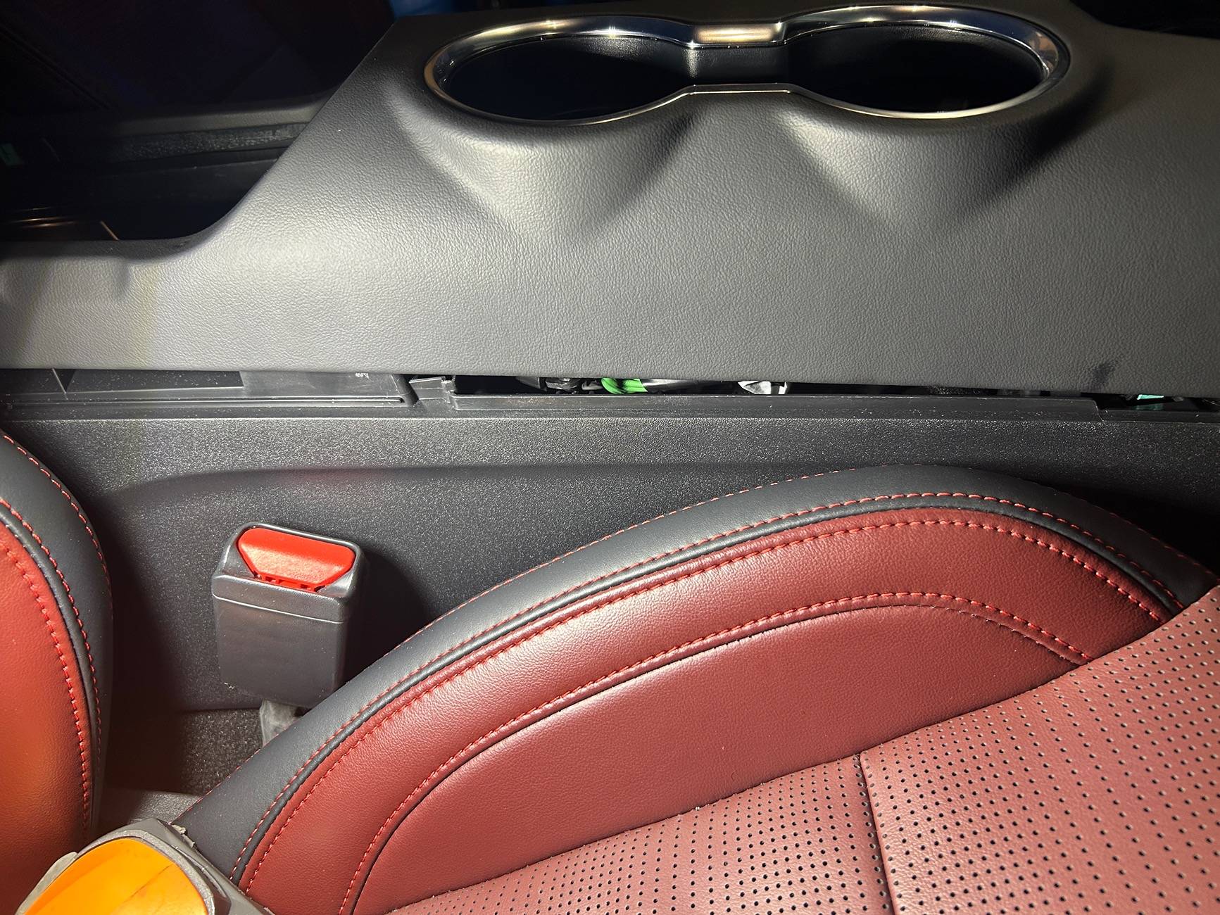

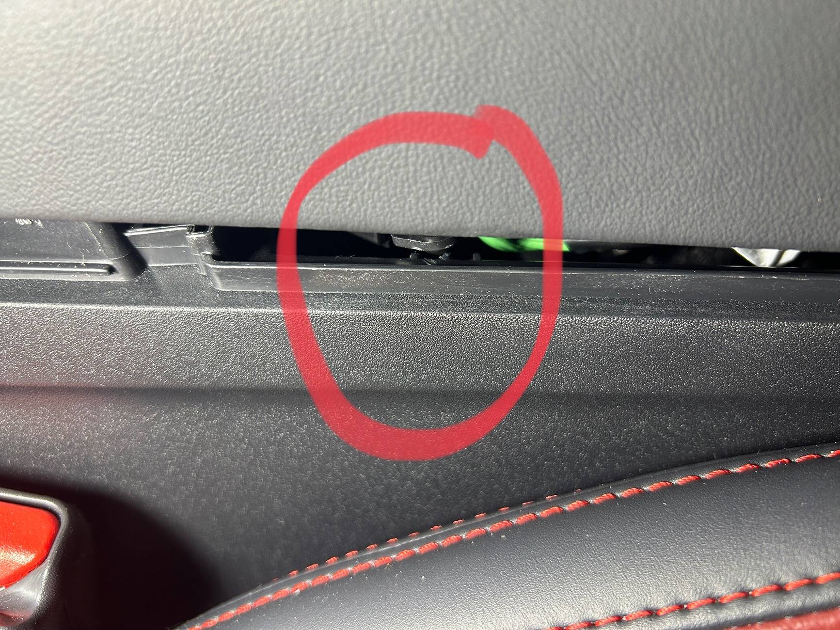

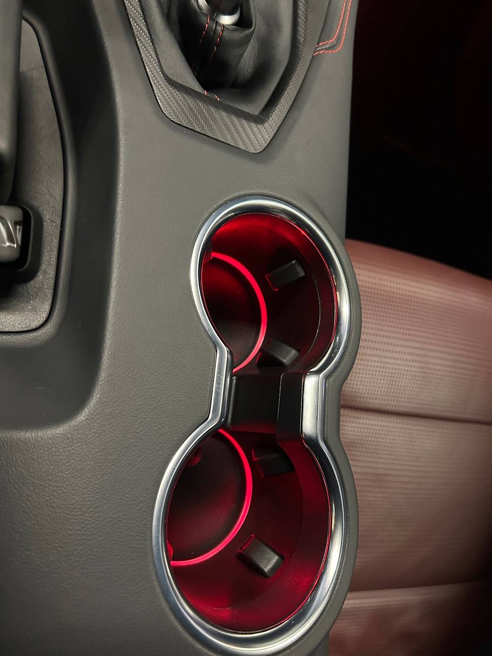

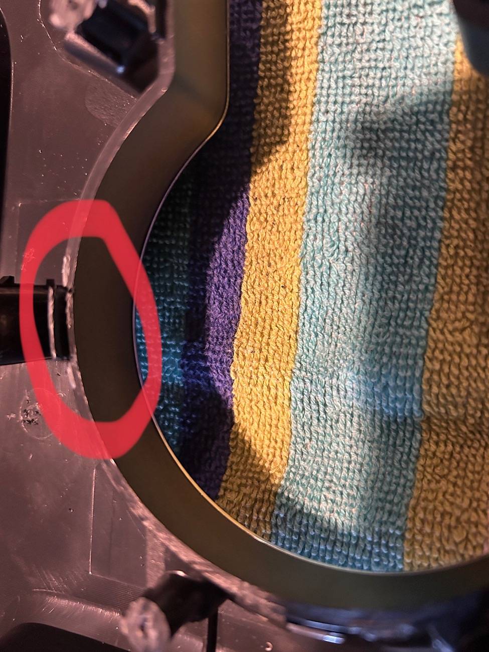

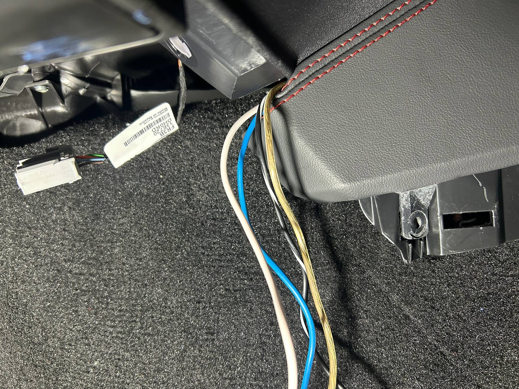

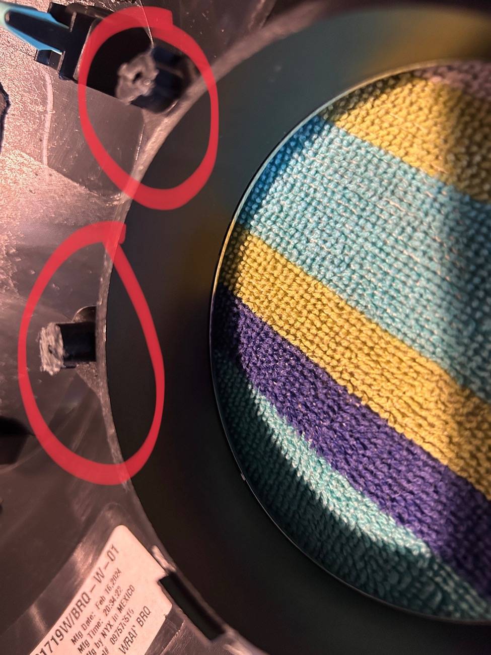

i got a chance to do the install and had a few complications. Easy fix, but slowed down the install. They changed the wire harness on the bottom of the cup holder so there was a clearance issue with a screw on the passenger side. Remove the screw that’s hitting on the cup holder, nip the top plastic, reinstall the screw. Then trim the 3 raised ridges in the inside of the console then everything will fit. Took about 5 1/2 hours due to figuring out the clearance issues between the upper and lower console. I also added a picture of what the light looks like in the driver foot well. To remove the light, twist clockwise then push it out, disconnect the harness directly behind the light and you can use t-taps to make the connection if you don’t want to do any wire cutting. It came out nice and was for the most part plug and play. Take your time,

why the resistors on the harness? shouldn’t they work by tapping into the lights from the right footwell lighting directly?
