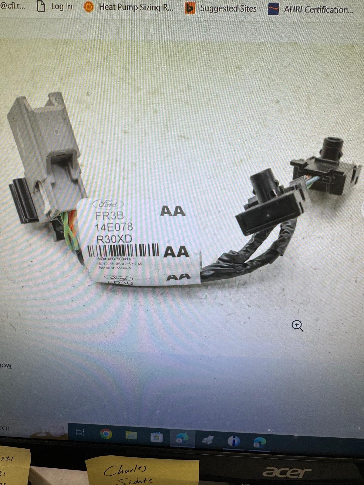

Where and how do the wires plug into the new cupholder? I see on the s550 it has actual plugs but on the Lincoln it just has 2 circles different connections

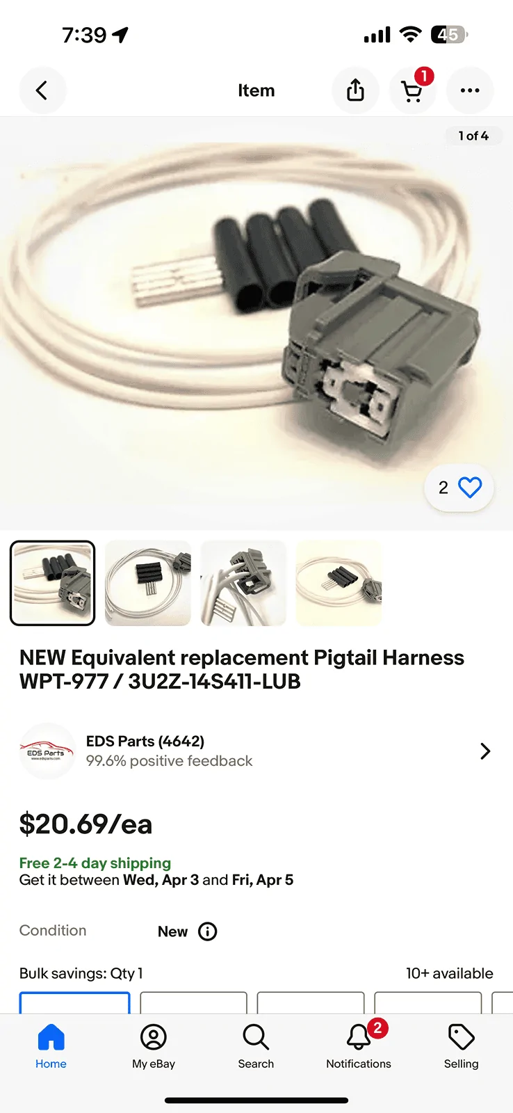

What’s are the harness part numbers?
The main harness is FR3B 14E078, the wire assembly is WPT-977, it plugs into the main harness and gives you your four wire pigtail
The harness has the round connections on it
