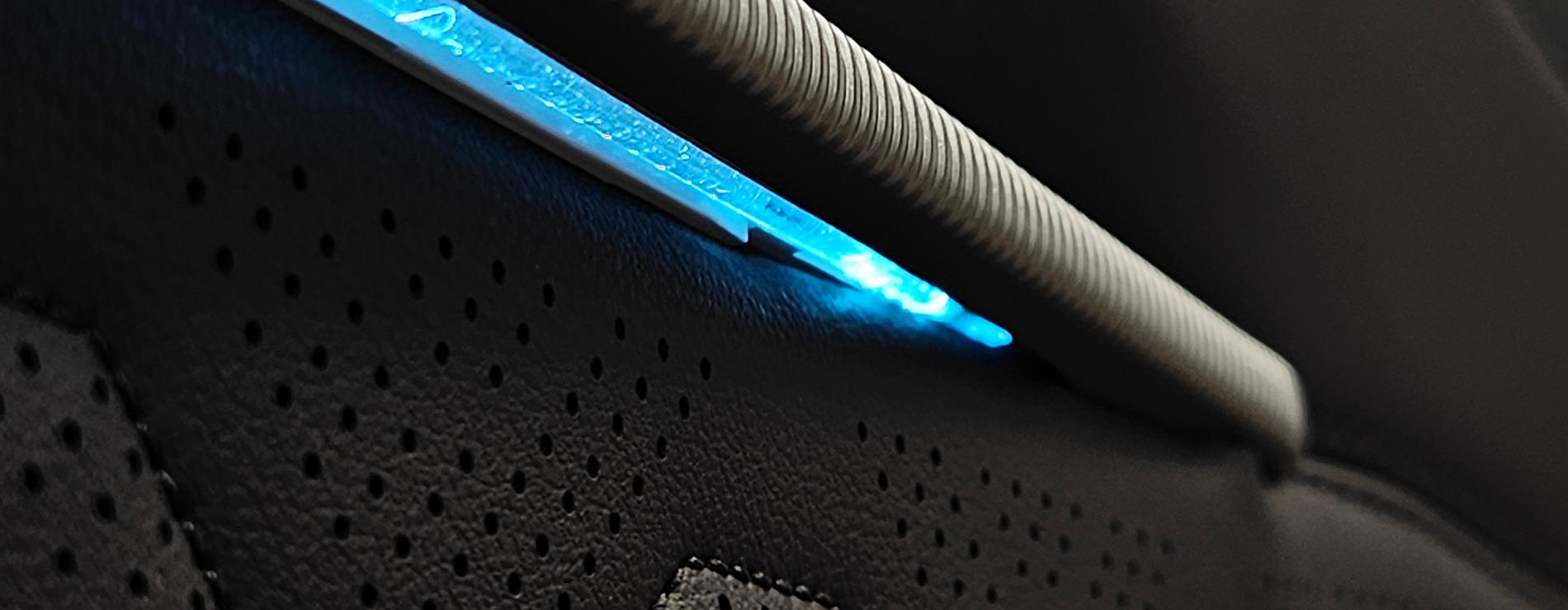

Looks really nice. I like the blue. I am sure it looks even better in person. Regarding the video, maybe you could upload it on YT and share the link.

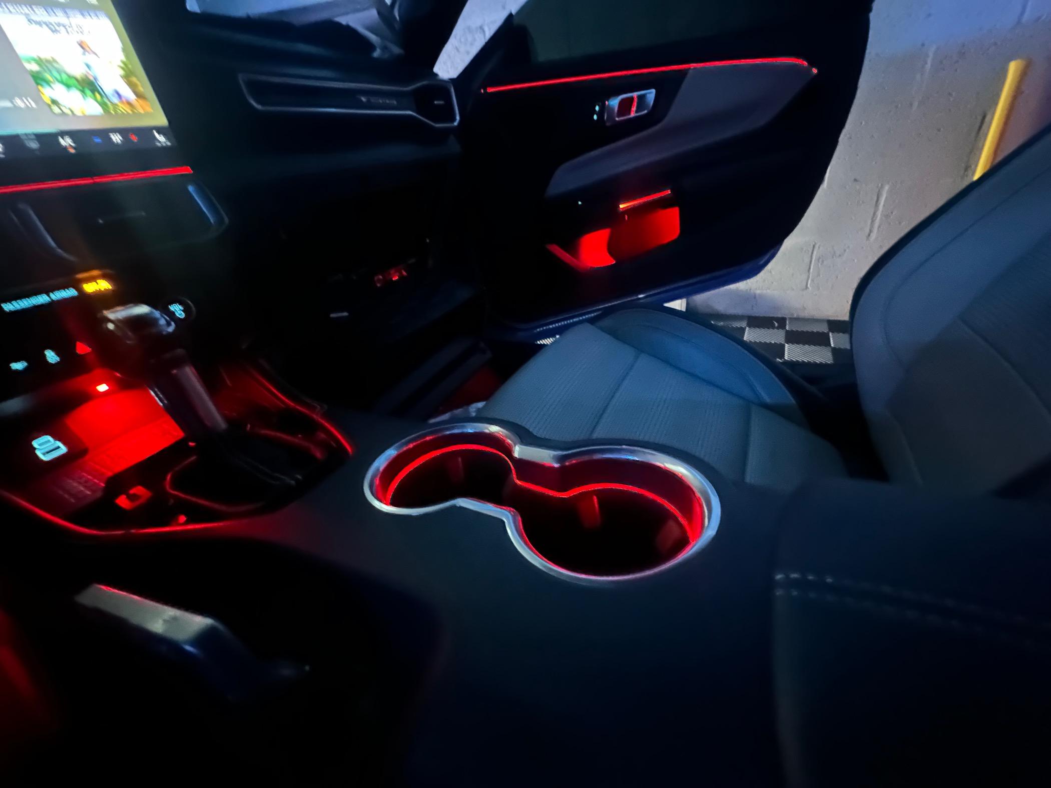

Hey man how are things lately. I hope you are still happy with your ambient light. Have you tried to put wires in the cup holders like they used to be for the S550? I have read somehwere before that it is not easy as there are no connections to that part.
Can you share some more nice pictures or footage if possible? I will take it as best practice. Thanks buddy. @INSANEMUSTANG9

Yes everything has been great I did get around to doing the cup holder, I am going to make a video, enough people have asked me, just been busy, but no issues

tired uploading a little video but says it’s too big if you message me on instagram I can send it that way

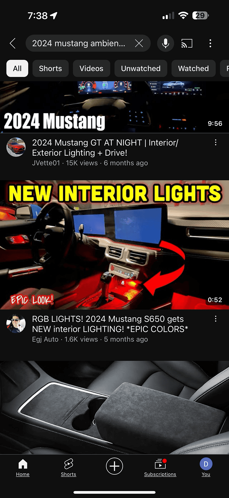

Yeah some some took my pics off the form here and uploaded it to YouTube try to sell light kits like they actually accomplished something. So decided to upload a video showing what it actually look like at night.

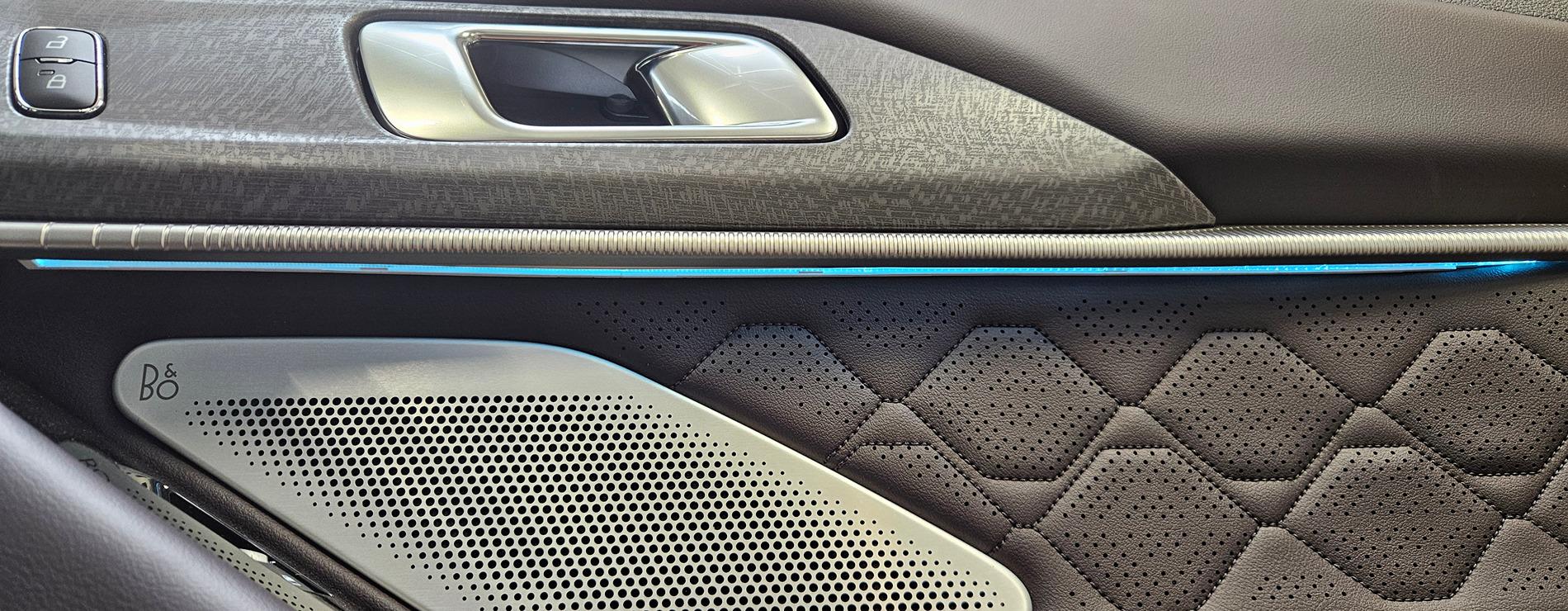

Ford added ambient lighting to the 2025 Explorer and did it similar to this. they have a thick fiber optic cable with an LED at the end and they have marks in the fiber optic cable to disrupt and broadcast the light
