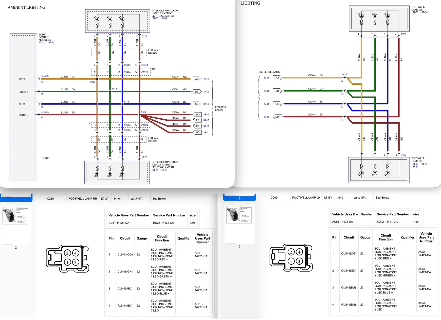

Looking for some help with some wiring for a footwell lighting kit since my car does not have the ambient lighting option.
Install instructions have you tap into the gray wire with a purple stripe in the passenger footwell to come on with the dome lights. In my S550, there was a purple wire with a white stripe for the headlights that made the footwell lights come on when you opened the door AND when the headlights come on at night. Has anyone figured out what the equivalent wire in the S650 would be for the same behavior? Or does anyone have a full wiring diagram for those harnesses? Not having much luck on all my searches.

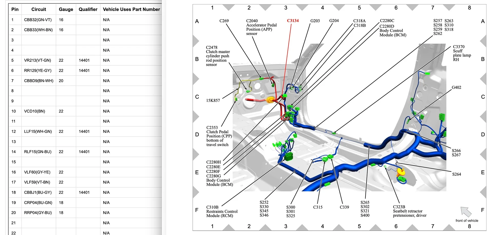

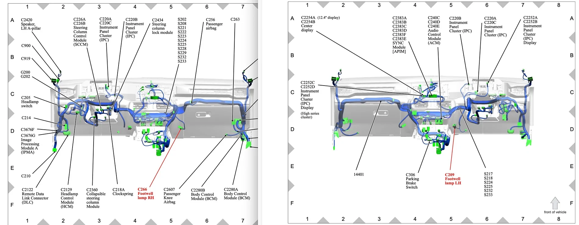

Here attached is the 2024 Mustang Footwell wiring from BCM with location and Harness C3134 connector
