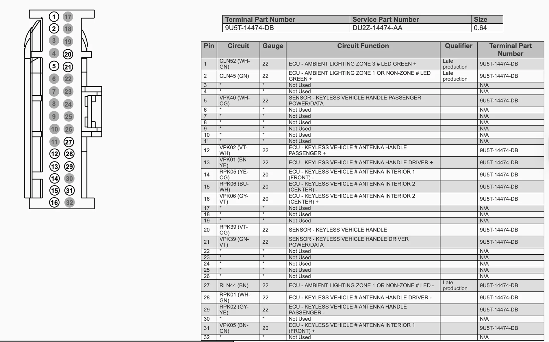

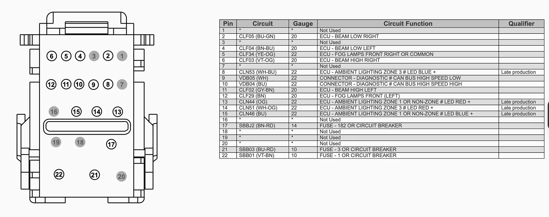

Below is Connector C2280D (J4 on the BCM). Pin 2 is AL Zone 1's Green, and Pin 27 is AL Zone 1 Ground (might be Zone 3's ground as well, as it did not specify that on the connector diagram). Pin 27, or wire RLN44, is shared with a few other circuits, so I caution against anything drastic with that wire.
Below is Connector C2280G (J7 on the BCM). Pin 13 is AL Zone 1's Red, and Pin 15 is AL Zone 1's Blue. There is no ground pin for AL on this connector. This connector leads to the HCM, so definitely don't fudge with this one too much unless you want to do just that.

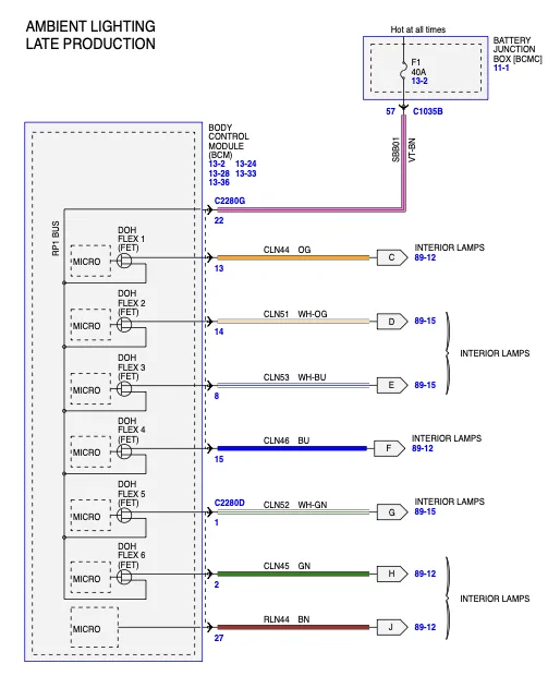

Onto the pièce de résistance, the wiring diagram for the wire itself... Pretty self explanatory... Red to red, green to green, and blue to blue. Ground is just ground. Zone 3's wiring is also in this picture, in case you want to add AL door sills. Zone 1 leads to a splice with the door lights, goes back to the interior lights connector, and then to the footwell lights.

Diving back into this, there are two lines in the BCM configuration, 726-37-01 and 726-37-02, that stand out because they include the flexible circuits. It is disabled in my Mustang's BCM, but enabled in every late production Mustang that has AL optioned from the factory.
Additionally, comparing this to the AL wiring diagram reveals that there are six individual microcontrollers, each with its own flexible circuit notation. I want to assume that these flexible circuits are what provide power to the AL, but I cannot confirm it since options 7 and 4 are not on the FORSCAN spreadsheet for those circuits.

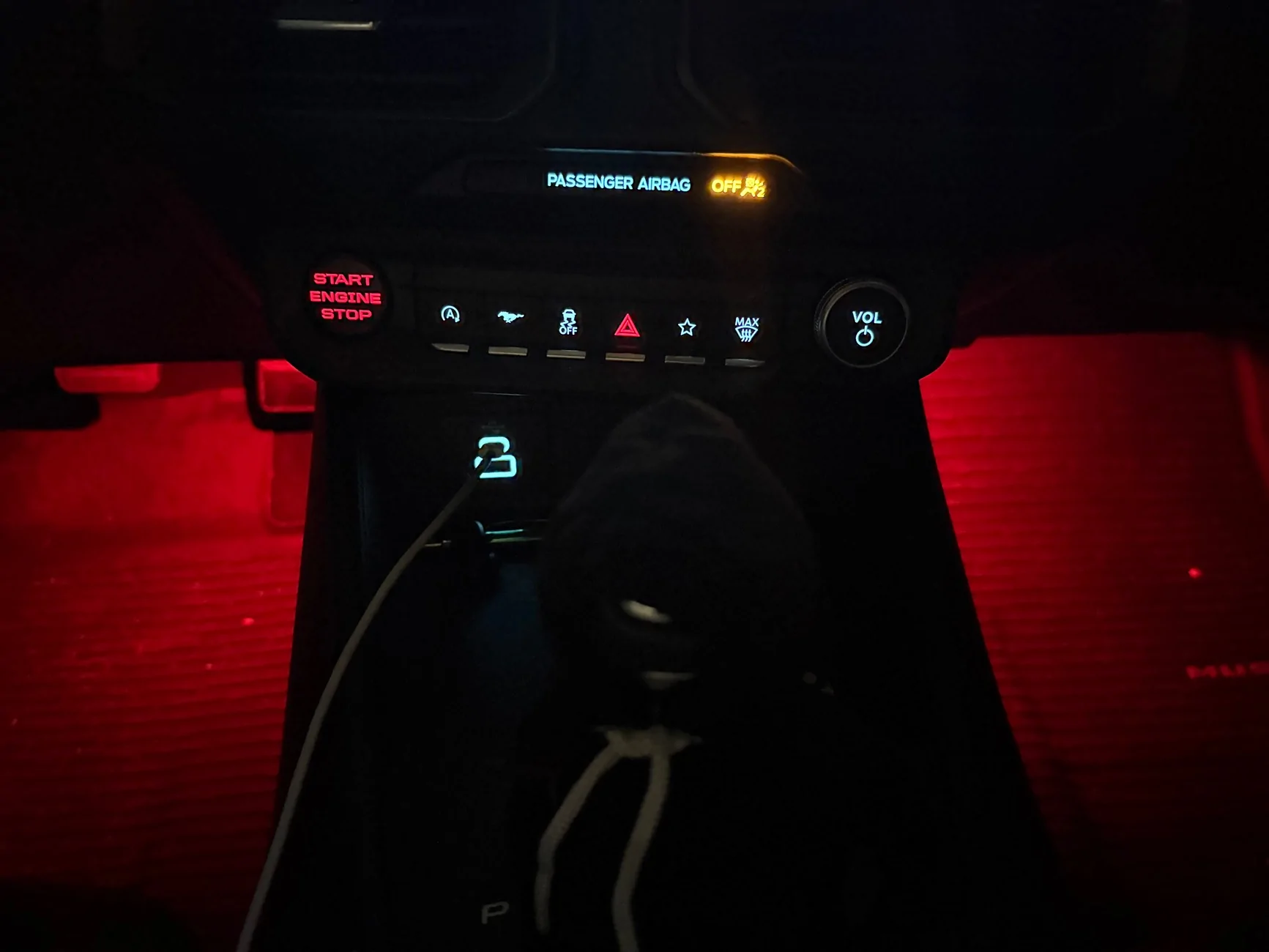

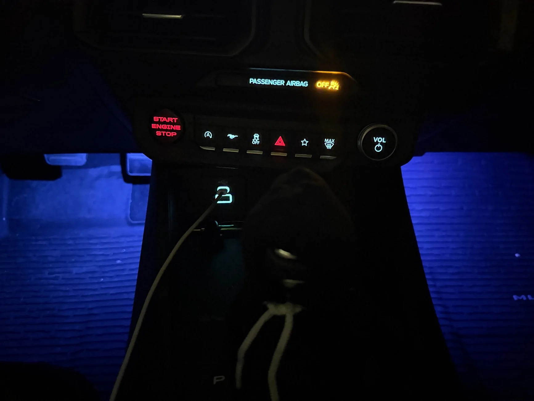

Update on the ambient lighting... IT WORKS (sortof)!
The flexible circuits are definitely what control the AL in the late production mustangs.
The passenger side is working wonderfully, the drivers side is constantly lit red (might be my fault with how I wired it), will need to look into it to see whats wrong. Otherwise, its working.
Edit:
Update on the lighting, one of the lights came defective, so I'll be exchanging it at the dealer. Now that I know this is possible, time to fill my wish list on Amazon 😁

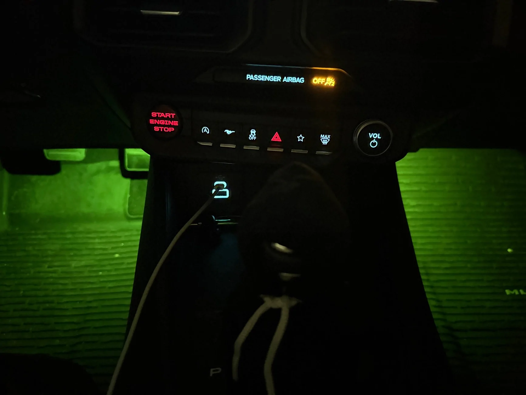

Finally got the replacement light in, now I can add some results 😅
I’ll post a full work-up about this mod once I get everything together

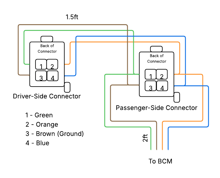

Here's the diagram with the wire lengths and wiring diagram.

To wire the connectors for the footwell lights, crimp the wires to the connector pins and feed the pin through the back of the connector. You'll hear a click when it is in place and locked.
Once that is done, wiring it to the BCM is gonna be the hard part. Connector C2280D (Jumper 4) needs to be taken out of its outer plastic piece. Wire and crimp the pin and feed it through the respective spot. Same thing applies for Connector C2280G (Jumper 7); Take off the locking mechanism and the front plate to feed the pins through the front. Connector C2280G most likely already has those two wires so using the wire taps is fine here. I recommend going farther back along the wire as this harness does hide under the foam insert on the passenger side. The ground already exists, though I caution that this ground is also shared with the HCM, and damaging this ground can cause headlamp problems.
Once you wire the harness to the BCM connectors, you can reassemble the connectors and plug them back into the BCM, and you can put the positive terminal back onto the battery.

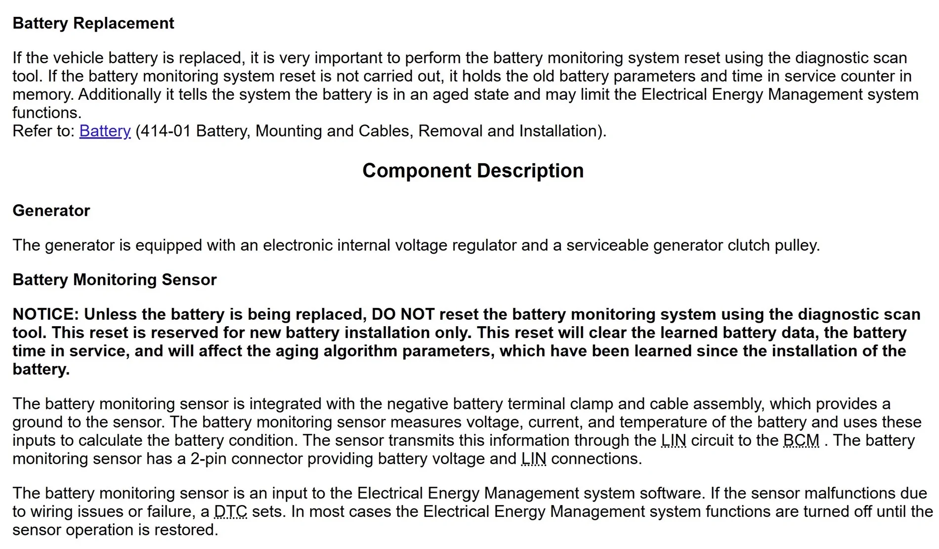

Question: When you disconnect the battery plus terminal does the monitoring info stay in memory or do you need to rewrite the learned settings??
The BMS doesn’t need to be relearned unless you’re replacing the battery unit. Otherwise, disconnecting the battery to do electrical work doesn’t need a BMS relearn.
