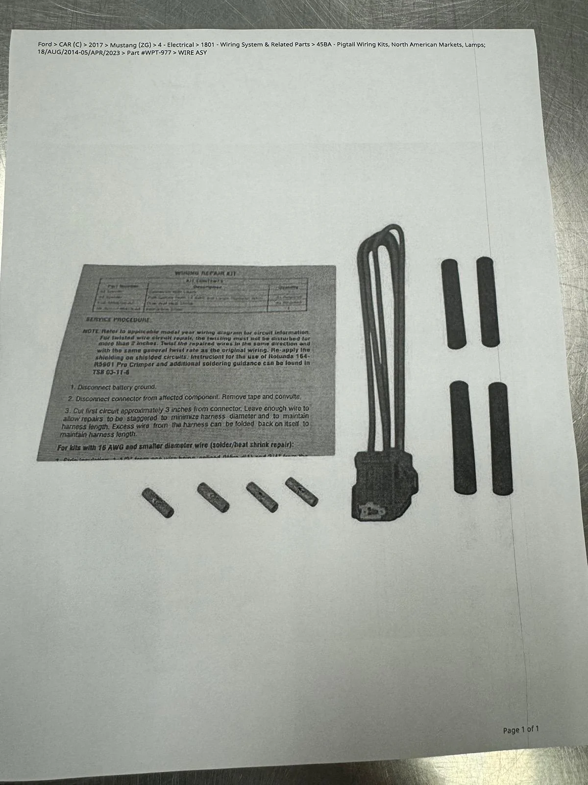

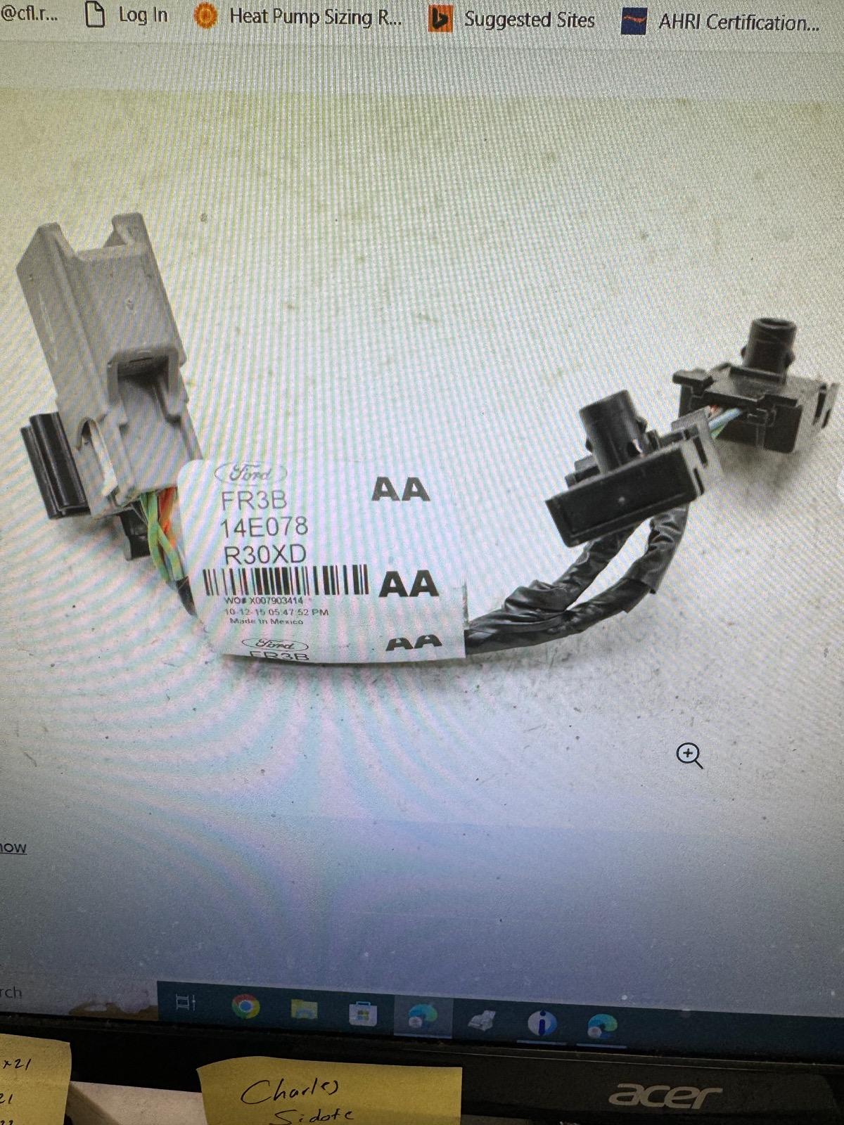

The main harness is FR3B 14E078, the wire assembly is WPT-977, it plugs into the main harness and gives you your four wire pigtail

It’s been almost two years since I did this, but from what I remember those plug into each side of the cupholder for the LED lights. Then you’ll need the adaptor(picture attached) to plug into that harness, that gives you your wires to tap in to the footwell ambient light.

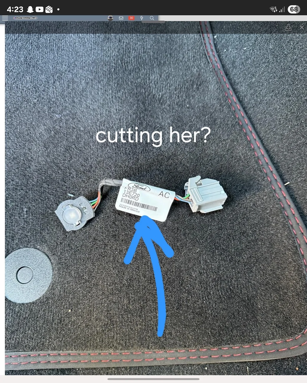

Tap into footwell ambient lighting itself that's mean i need to cut and use t tap or posi?
And is this pigtail enough or short?

I used line taps, once you get the tape off you can separate the wires enough to use them. Or yes, you can cut and splice there. You will need to add about 2’ of wire to reach the footwell.

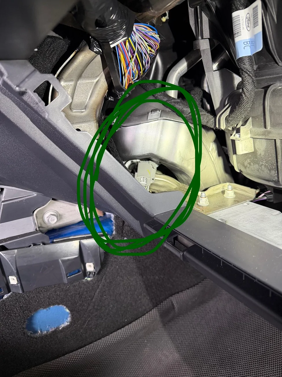

I just completed this as well. If you take the glove box out is it easy to access the passenger plug for the lights. Just thought I’d add this because there seemed to be a few questions about how to tap in. I chose to make my own plug and play harness
