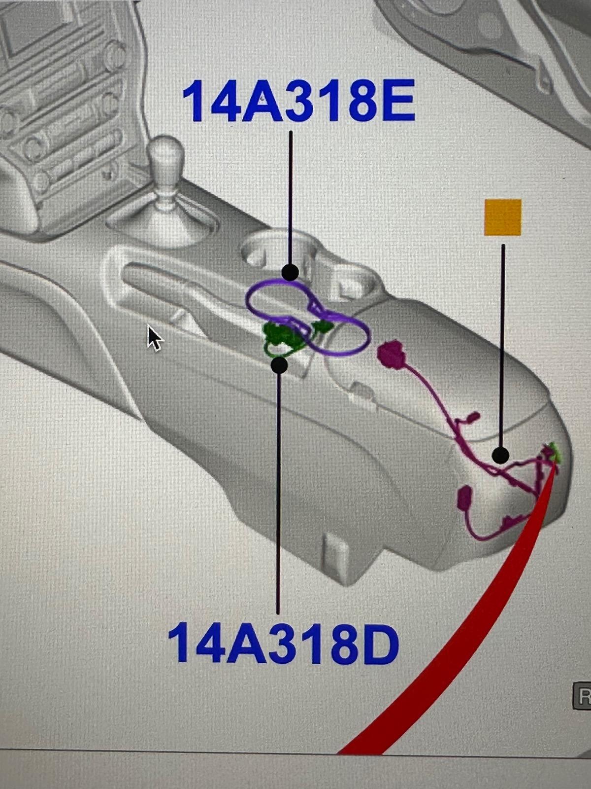

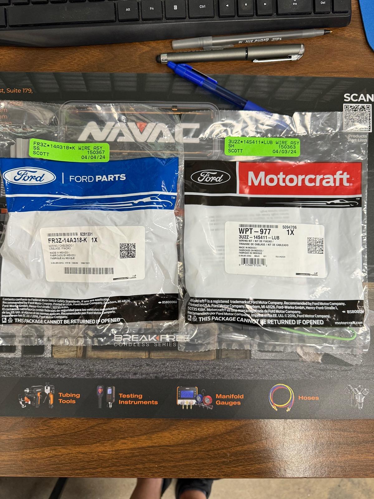

The cup holder harness I see the part number but I can’t find that on ford parts. Is there anyway to order that separately without getting a whole cupholder from the s550. Is this the wire part number? I found it on ford parts FR3Z14A318K
The cross-over # from my dealer on my receipt is FR3Z*14A318*K. Your dealer will order it for you, they will require payment first because it's special order part, at least that's what my dealer did. Taxed it was $89.08, kinda pricey. But will be well worth it in the end. Mine should be here tomorrow.

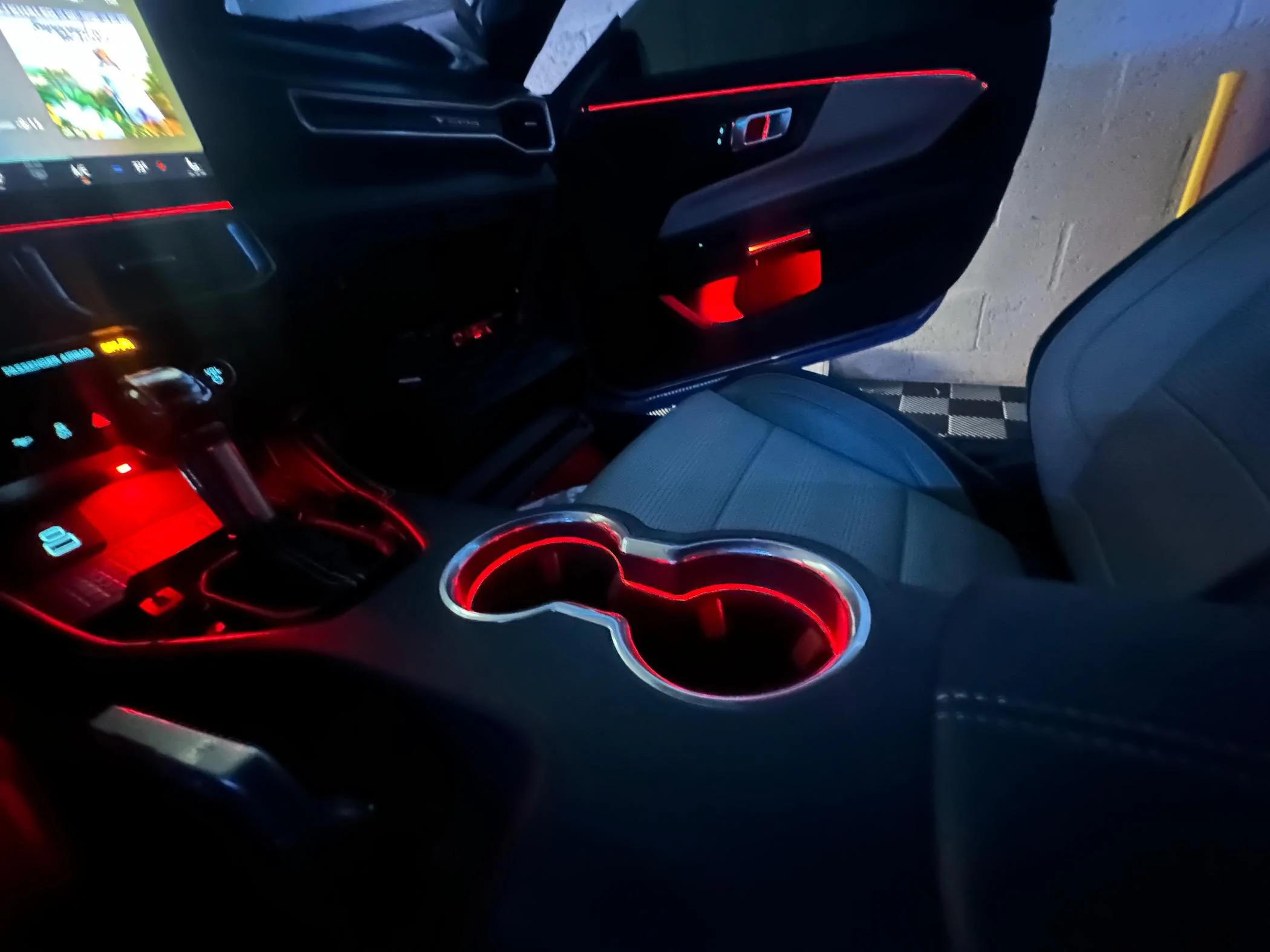

Just finished doing my cup holders then saw your post, yours looks way better! I had an extra s550 cup holder laying around so ordered the Lincon cup holder and am going to change it out once it come in, thanks for the info

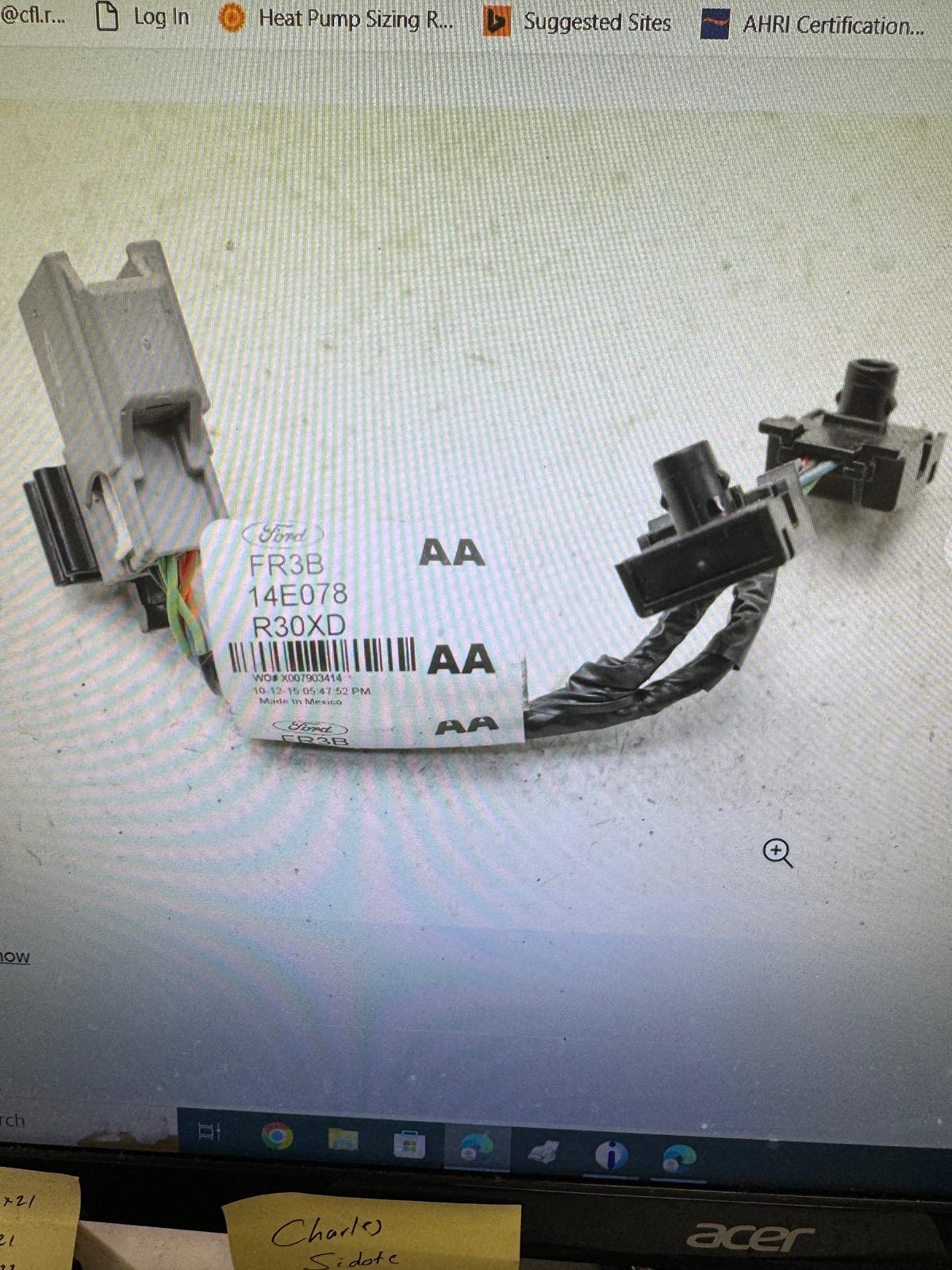

Can we get an updated post with parts and instructions?
I wanna give this a shot but im a bit confused lol
Seems like we need the following:
  • LED Harness: FR3B 14E078
  • Pig Tail assembly: WPT-977
  • Cup Holder: LJ7Z-7813562-BA
Looks good, but I agree the Lincoln cup holder does look better with the LED’s at the bottom.
You have the parts correct, OP gave instructions, nothing has changed since then. 😂
