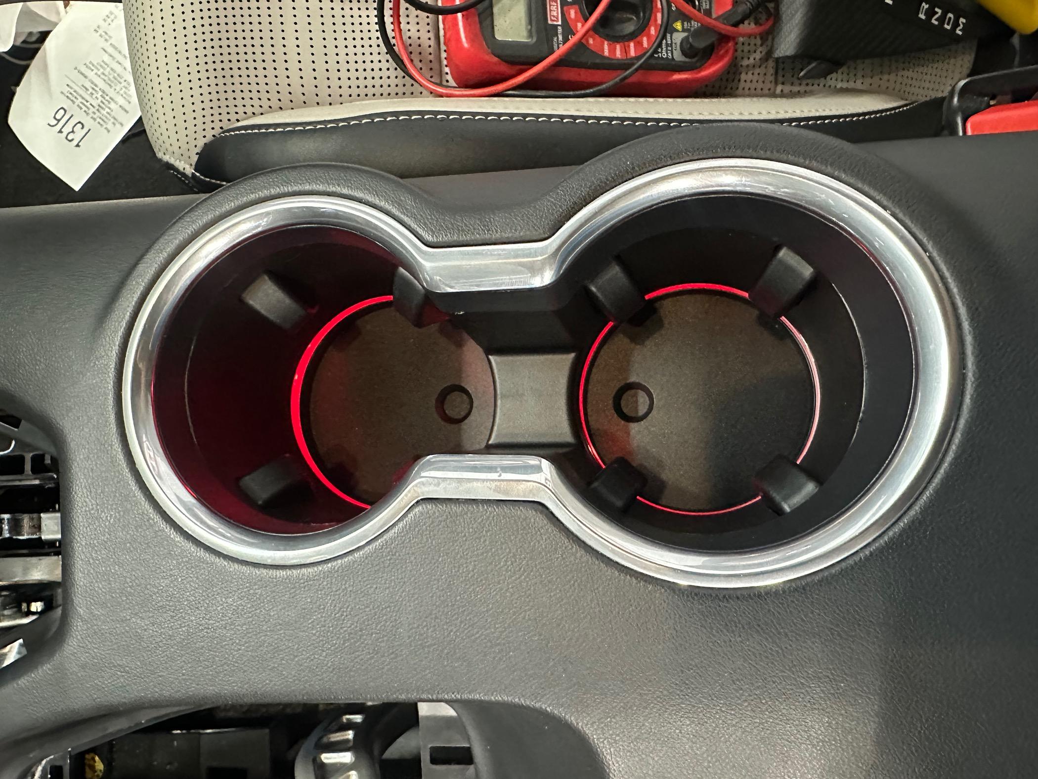

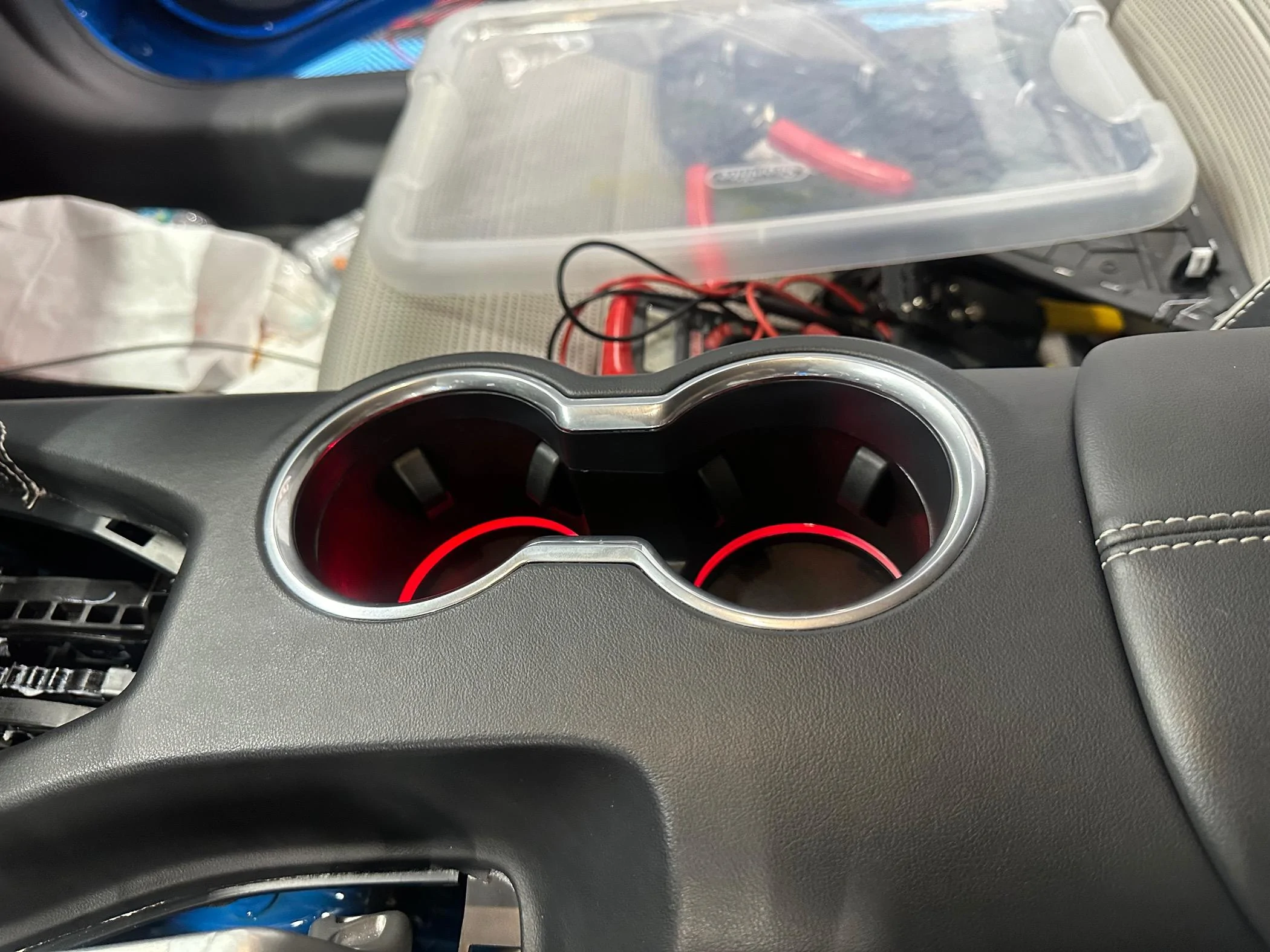

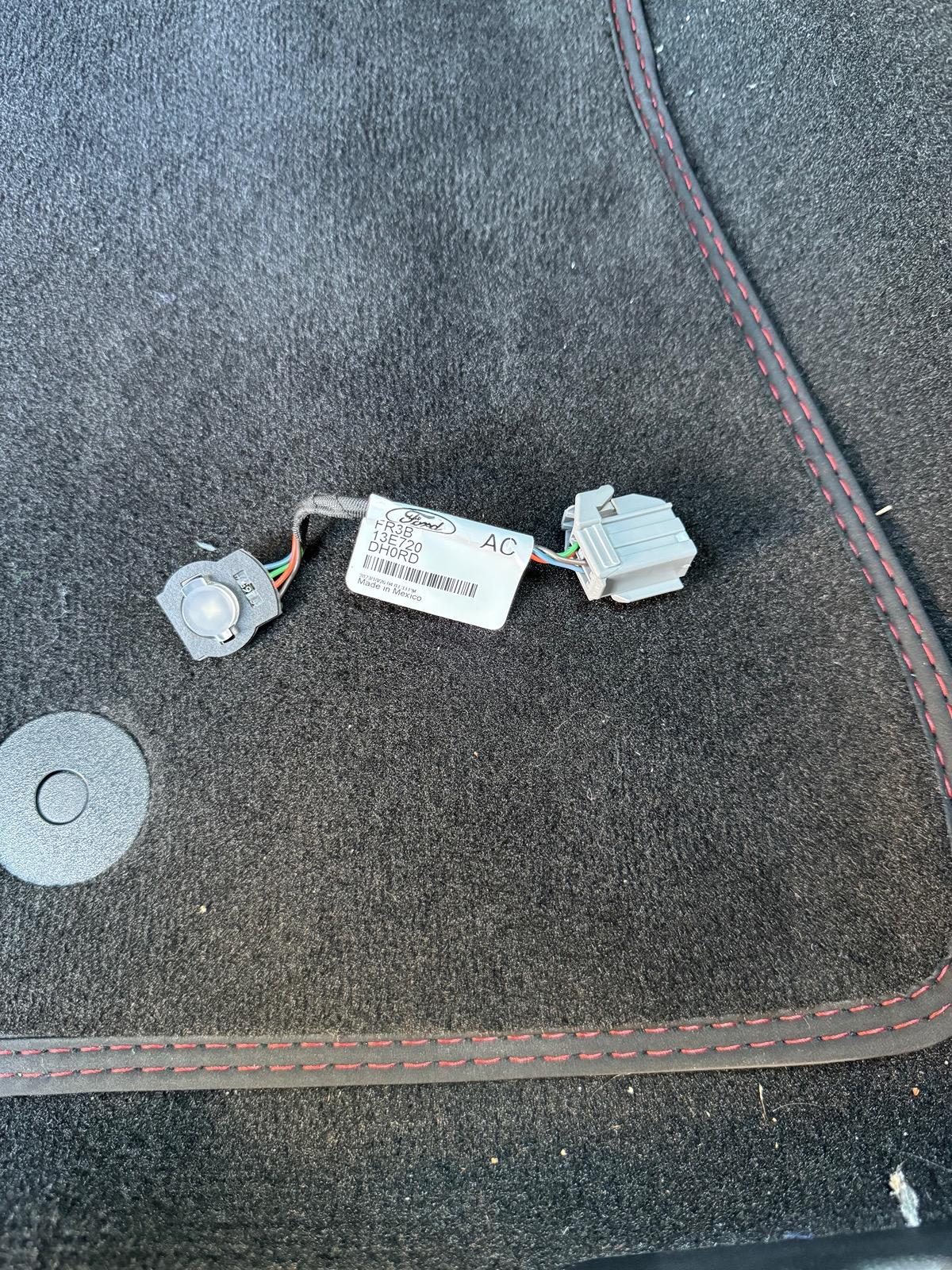

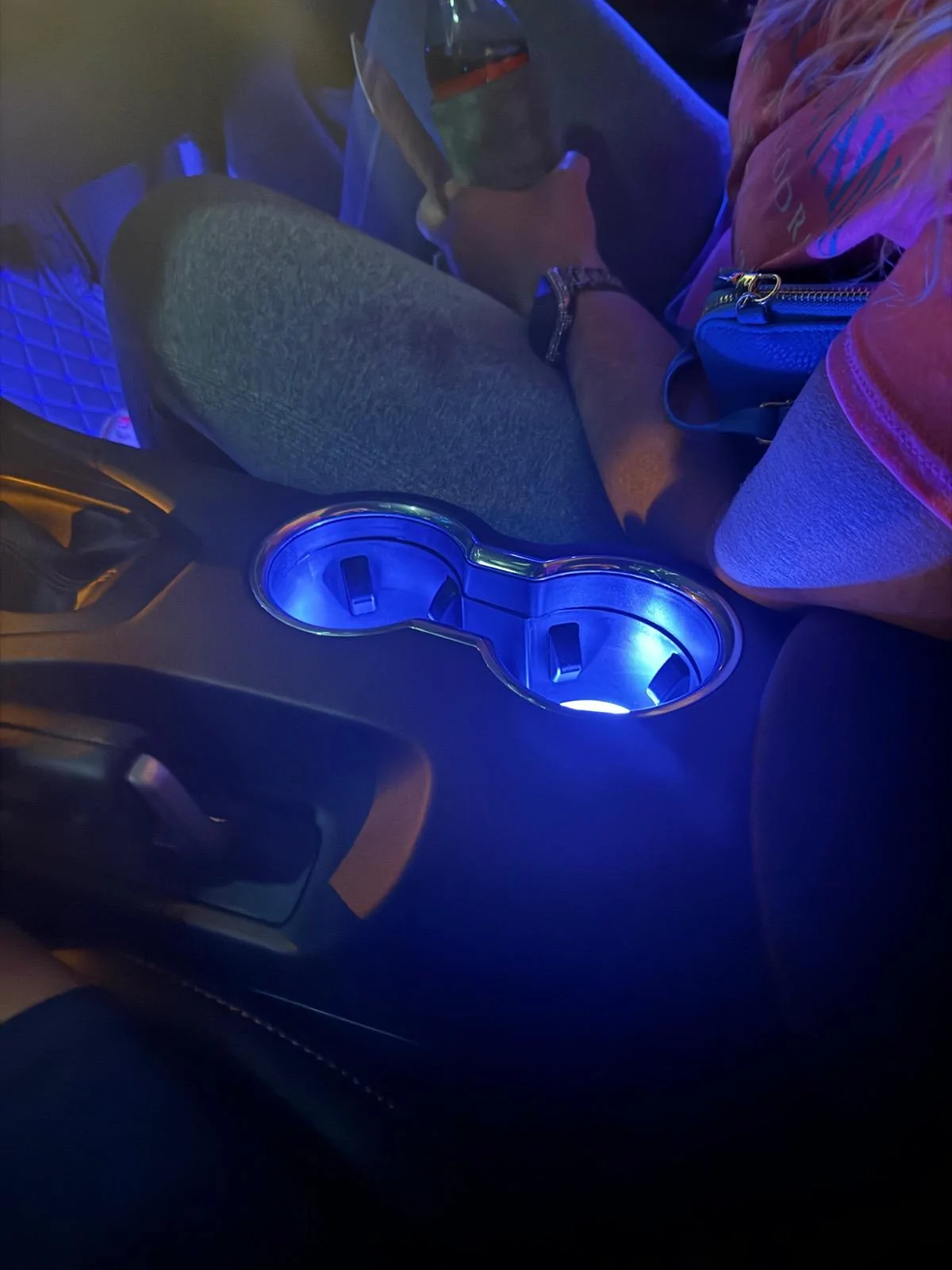

Ok, so I did the install yesterday, unfortunately I didn’t get pictures as there really aren’t many needed. Once you get started it’s pretty straightforward. Although I would recommend getting the S550 cup holder, the Lincoln one is larger and modifications need to be made. Other than that, it was easy. I tapped in to the driver side footwell light which was pretty simple. Just unplug the harness and remove it. I did take a picture of that in case it didn’t work and I had to buy a new one. It did take about 4 hours, while I had everything apart I replaced the shift knob with one I had on my S550. All in all, a nice upgrade that I’m happy with but if I had to do it again I would definitely use the S550 cup holder. You can see the gap I mentioned in the pics. Sitting in the car it is not noticeable, the camera angle brings it out.

No, you’ll need to splice on an additional 2’ of wire. I thought and read the same thing, but when I removed the cupholder and physically compared it to the Lincoln one it was smaller. That is the biggest reason for a not so perfect fit. So, I had to notch out some areas on the Lincoln cupholder because its mounting holes aren’t in the same place and had to drill new holes to accommodate for that. I also trimmed the mounting locations down a little to close the gap to where it is now. I may locate a S550 holder and replace it later. But like I said, it’s not a major flaw and I can live with it until I get the other one. If you’re at all mechanically inclined this won’t be a difficult task, just time consuming mostly due to the cup holder modifications of trim, fit, trim again. lol Still worth the effort in my opinion. Insanemustang9 used the S550 holder, I think the difference is where the LED ring is located

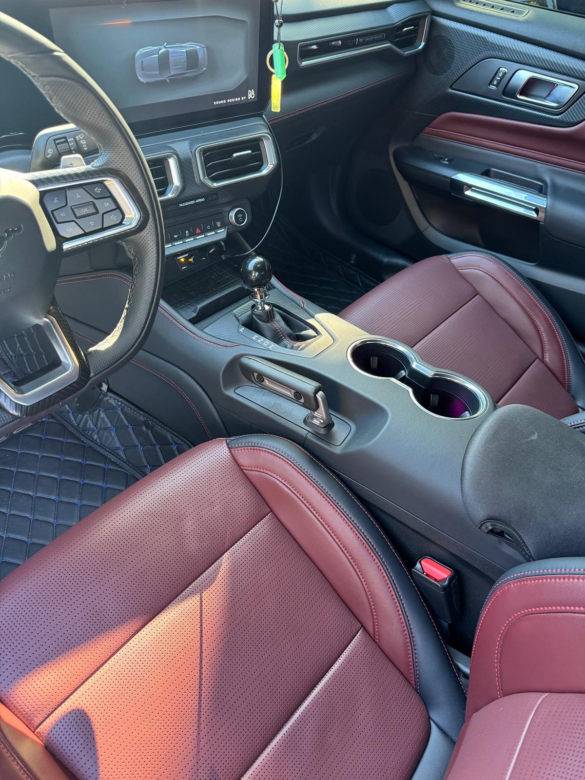

Took a minute but definitely takes little finesse to get it fit well
Looks good. I’m confused with the pig tail harness. No one has really showed where we’re tapping into. I understand the footwell lights but where? Where does the footwell harness lead up to and is the pig tail harness we bought long enough to reach where ever we’re tapping into

Look under your dash next to the center console, you will see the footwell light. I unplugged it and removed it to tie my wires in. No the pigtail on the harness is not long enough you will have to add about two feet of wire
