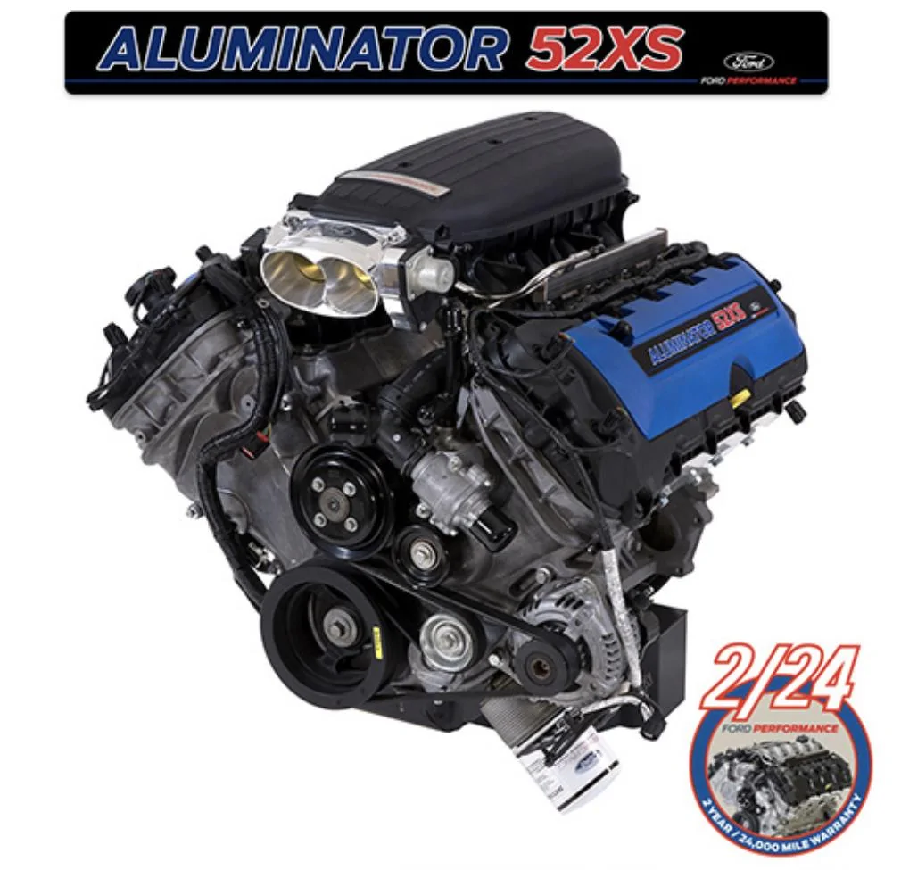

Okay, Dark Horse has Dual 80mm Throttle Bodies. 52XS has Dual 65mm Throttle Bodies, although it does have a CobraJet Intake Manifold. It won’t have the 580 of the Aluminator and has smaller displacement, but If more Air Equates to more HP, then the Dark Horse should be able to, at least, have the 525+ HP of the Voodoo, even though it’s Cross Plane Crank. Considering Emissions and other Federal Regulations to make it 50 State Legal, it should provide enough HP to please Most Buyers.
S650 Mustang REVan Interviews Ed Krenz, Mustang lead engineer, about 2024 Dark Horse Mustang 1669215764572
Ford Performance has taken the technology and hardware developed for the Shelby GT350 Mustang and has created the ultimate naturally aspirated, 5.2L cross-plane crankshaft crate engine. With a rating of 580 horsepower at 7,800 rpm, the new Aluminator 5.2 XS is the most powerful naturally aspirated modular crate engine ever built by Ford Performance. This is the worthy successor of our previous rendition-the "A50XS". Every Aluminator is hand assembled by the same technicians that build the Mustang Cobra Jet drag racing engines. Premium aftermarket components are used to ensure durability like; unique ManleyĀ® connecting rods, ARPĀ® rod bolts, MahleĀ® forged pistons, forged steel crankshaft sprocket, and billet oil pump gears. Unique components developed specifically for the Cobra Jet racing program are used including Cobra Jet short runner-high RPM intake manifold, 1517 CFM dual 65mm Cobra Jet throttle body, and high RPM pulse ring. Ford Performance Engineers developed a balanced combination of high end, 580 horsepower and strong mid-range torque with the Cobra Jet intake manifold, unique camshafts and fully CNC ported GT350 cylinder heads.
P.S.
The new Dual Intake Arrangement of the 2024 might just make it a little easier to drop this thing right in!

"Ford Performance has taken the technology and hardware developed for the Shelby GT350 Mustang and has created the ultimate naturally aspirated, 5.2L cross-plane crankshaft crate engine"
Ford - "we uh, yeah, back to cross-plane crank guys!"
