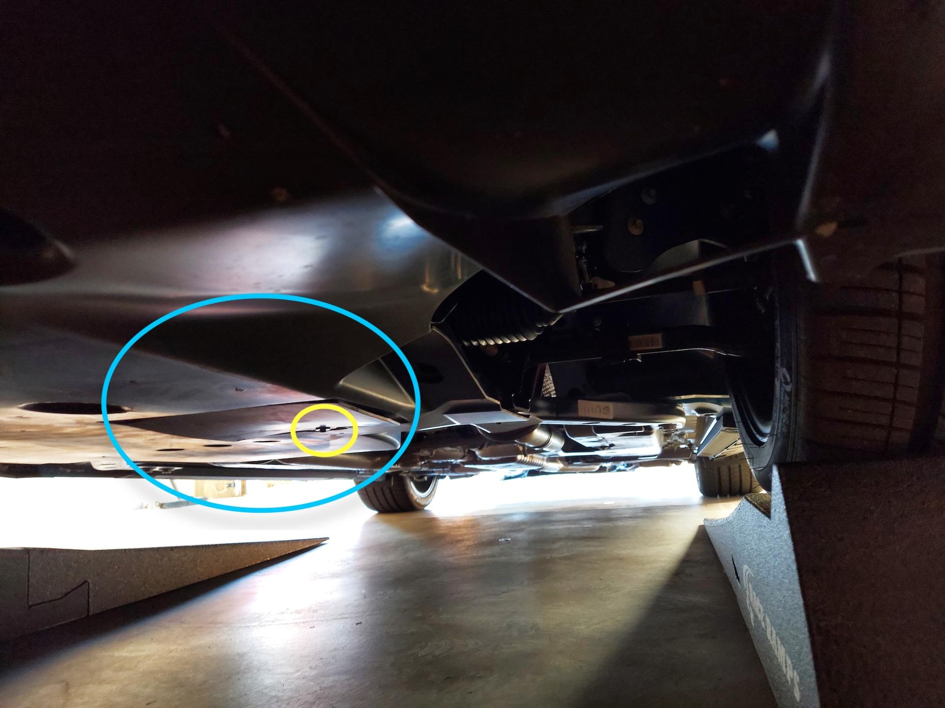

...his Ford has some weird folding tray that makes it easier and neater to swap out the canister.
Attached is a photo highlighting what I believe you're referring to.
Overall, the bellypan of the S550 Mach 1.
Inside the blue circle is an access port, a flap, several square inches, tens of centimeters square.
The flap or port is secured by a single bolt, circled in yellow.
With the bolt loosened and the flap removed, you're immediately presented with a diagonal cross-member and rather large bundle of wires. There is enough space to place one arm through the port and touch the filter and engine. You can also place a second hand along side of your arm, leaving the second hand just outside the port. Extend your arm fully. With your second, touch the hand of the second arm to the elbow of the first; this kind of gives you an idea.
