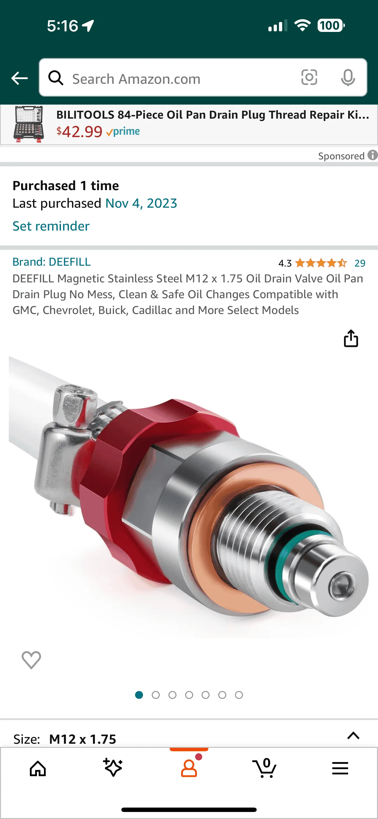

I bought the M12x1.75 Deefill drain plug from Amazon. Hopefully it fits.
The quality of the Deefill is excellent!

I changed the oil today and it fits. M12x1.75 is accurate.
I have purchased Fumoto in the past, but I must say the quality of the Deefill is clearly superior.
BTW- the stock plug is either not magnetic or extremely weak.
