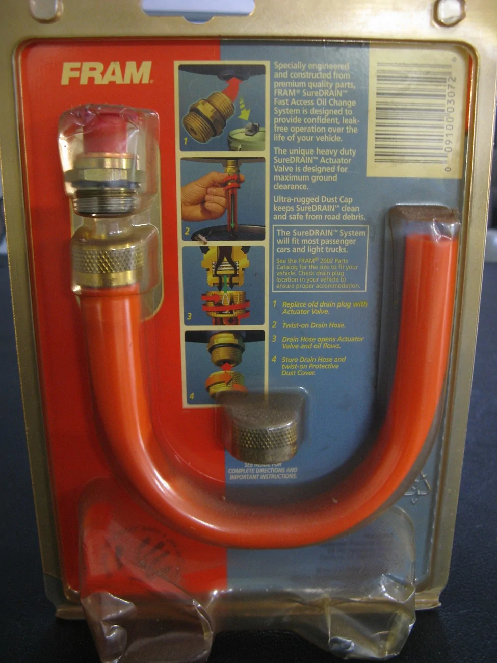

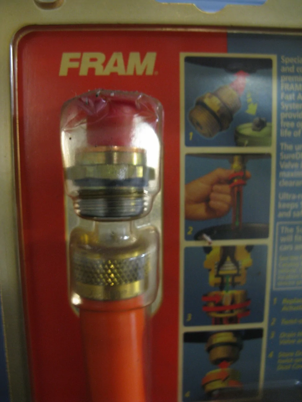

FWIW - I had the first iteration of these from "Fram" on my 2002 - 8.1L Avalanche (these things have been around for a long time). The first one I installed "broke off" during installation, maybe installation error, but, I installed another one after removing the "threads" from the pan. It worked fine - "kinda" - before one oil chage, I unscrewed the cap and, there was oil in the cap that wasn't there before. I pulled the valve out and cleaned the check ball mechanism with spray cleaner - the Fram unit had a spring loaded check ball (metal cone) and seat, I'm guessing that a small piece of debris caused the ball not to seat fully because it never happened again. Anyway, I sold the Avalanche with the valve. I had already purchased another one, for another 8.1 L GM v-8 (see pics) that I never installed because of that "one" episode on the Avalanche. I installed a Fumoto valve instead, and have used them ever since. The Fumoto valve I installed on my Mustang, has a nipple for attaching a hose to flow oil into the oil pan
