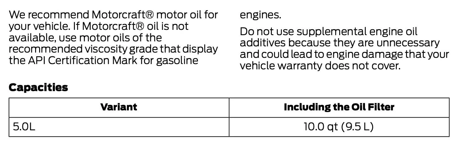

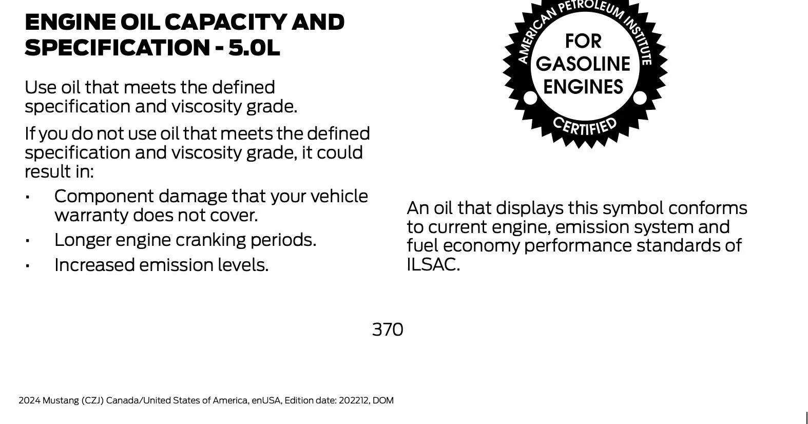

Does anyone know if the Dark Horse takes more oil than a GT?
Page 371 of the 2024 Owner's Manual says 10 quarts, 5.0 liter. It does not differentiate between GT and DH.

Manual actually says 9.6 qts
