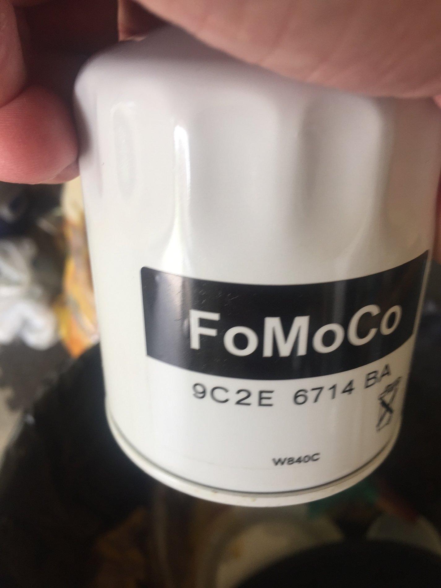

Do they still use an undersized FoMoCo initial factory filter like they did for the S550 (pic below)?

the FL500s i Bigger than the filter on the car from the factory. But that’s wha

That looks like the one that was on from the factory. I used a FL500s which is bigger but what the manual calls for i think.

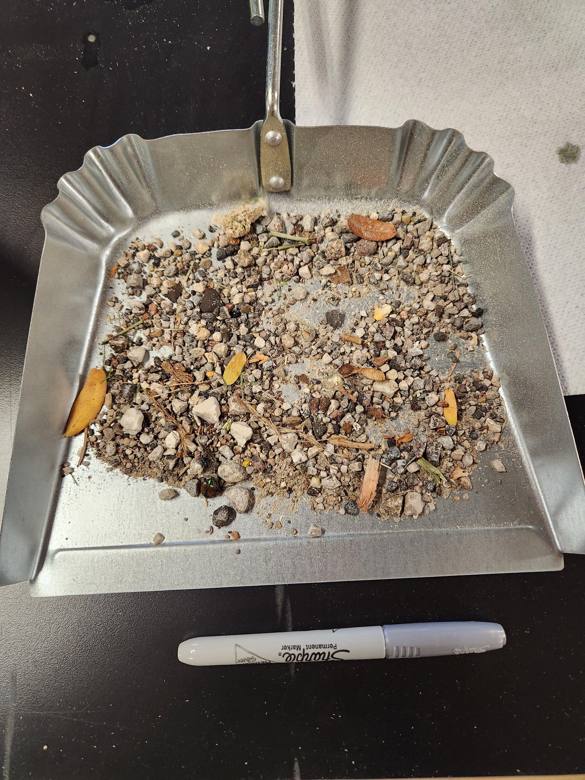

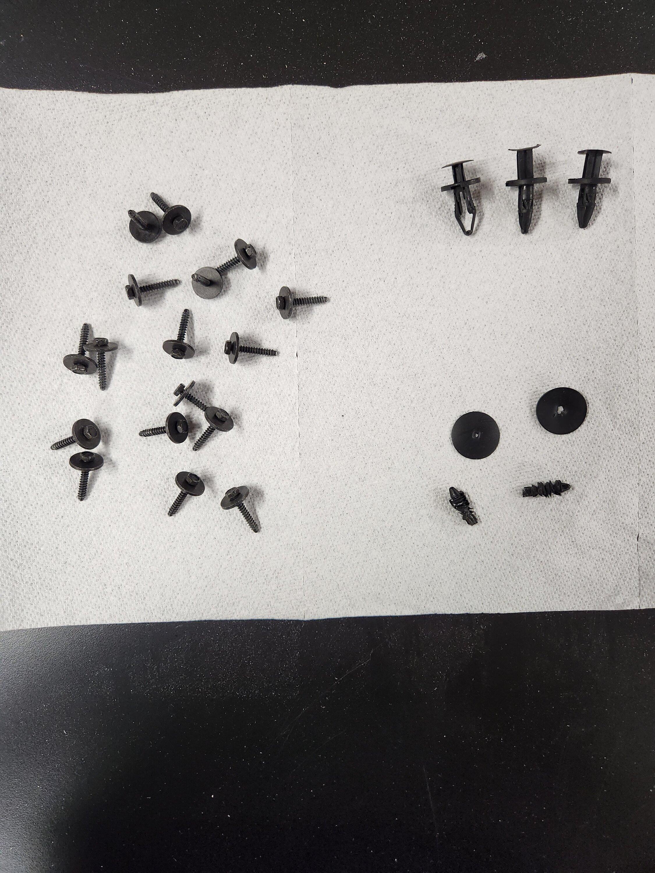

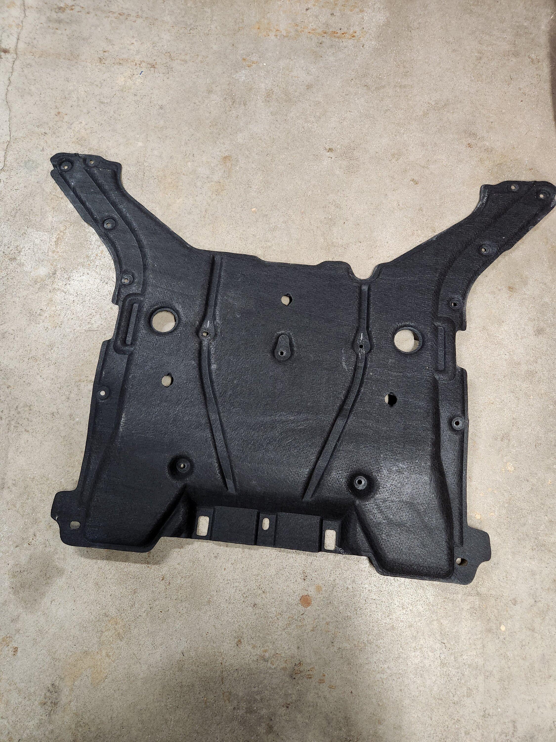

I just got done with the first oil change on my Dark Horse. 1300 miles. What a huge pain in the ass. Ford did not make it easy! The whole under pan has to come off to get to the oil filter. And the strakes have to come half way off to get the pan off. 17 7mm screws and 5 plastic retainers. The 2 big ones in the middle will brake, so be prepared with replacements. Once it's off, then it's pretty easy, but then it all has to go back on.
Oil plug was not that tight.
The pan that I had to remove was full of rocks. And I have been very careful keeping it out of gravel. The rails behind the front tires were full of rocks. And the hard plastic pan under the radiator toward the front was full of rocks. I think I spent more time getting stones out than changing the oil. It drove me nuts.
Another observation...there were some tiny stones stuck in the soft tires. I haven't drove it in 2 weeks. I picked them out and they left disturbingly deep divots.

It's the HP tires. They are rock collectors.

There's a bit of gold there...to the right of the bug
