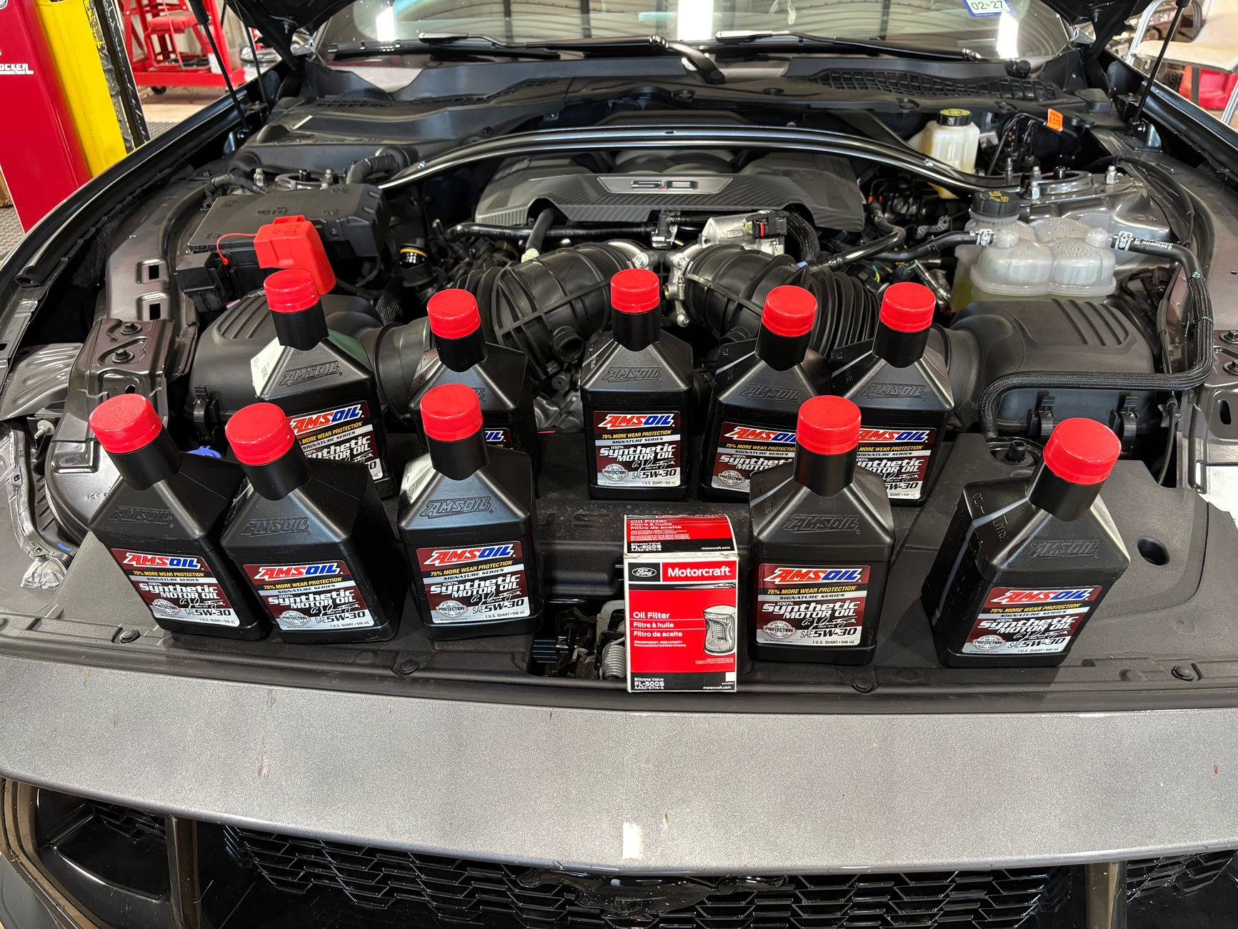

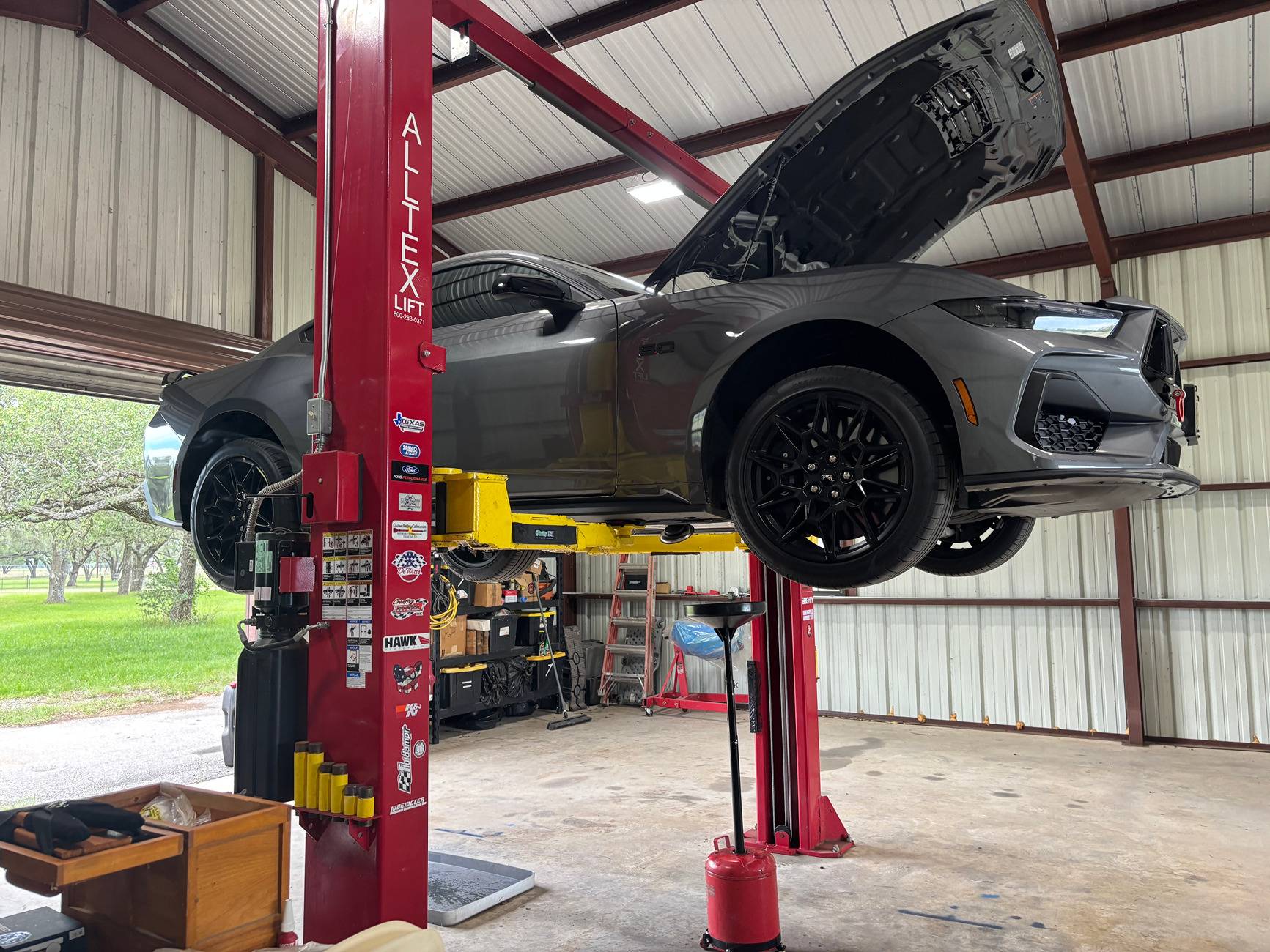

This is what I do, because as you have, I've heard too many stories of minimum wage monkeys doing oil changes, no offense I was one too, gotta start somewhere. Plus Ford gets oil in 55 gallon drums, not always the best. Licensed aircraft mechanic now (join the Air Force please) and have been wrenching on cars for 46 years. This isn't rocket science. I photo everything and I email it to my google email account, plus a thumb drive I keep in the glove box.
Seven cars ( join the military, hint) all 2021 plus, (hint join the military). I do this all on my Challenger Scat Pack Wide Body, Camaro 1LE, Cadillac CTSV, and Mustang GT Performace Pack, and a few others.
Drive the car, do an oil change on a warm car/oil. Sucks I know but it gets all the particulates and contamination circulated for a good drain.
What are the jobs of oil? Lubrication, cleaning, and cooling. Important.

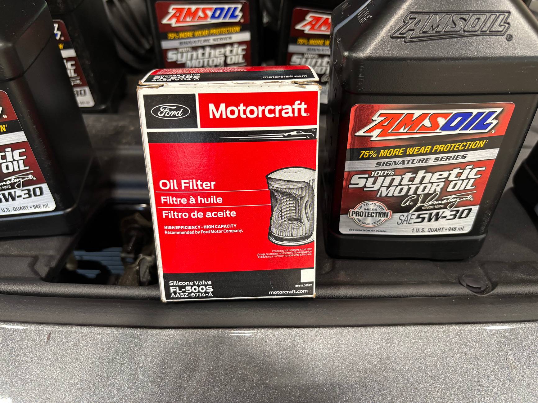

Amsoil is my #1 go to for everything, but I always use the manufactures oil filters for everything. 1st oil change, just make sure the old gasket from the factory oil filter comes off with the factory oil filter (odd if it doesn't), look at the filter and the mounting boss(where the filter screws on), check to make sure the old gasket isn't there, its a rubber o-ring.
Amsoil will give you the drain plug torque 19FT LBS for the 5.0. Exercise your torque wench, meaning rotate it to it's highest setting then back to it's lowest setting (lubricates the spring in the torque wrench) THEN set the torque for the drain plug. I let the oil drain until its done, a drip or less.
Tighten the oil filter(not rocket science), I tighten mine as tight as I can hand tight. Not a weight lifter but it should stop when tight enough, being an o-ring. Old days it was a compressible gasket, so we tighten it to it stops and turn it as far as you can. Your no different than the monkeys that don't care about your car, remember that. Just turn it and then some with your hands, that what they do.
See my attached files for what I do to protect my warranty. Your phone records the date.

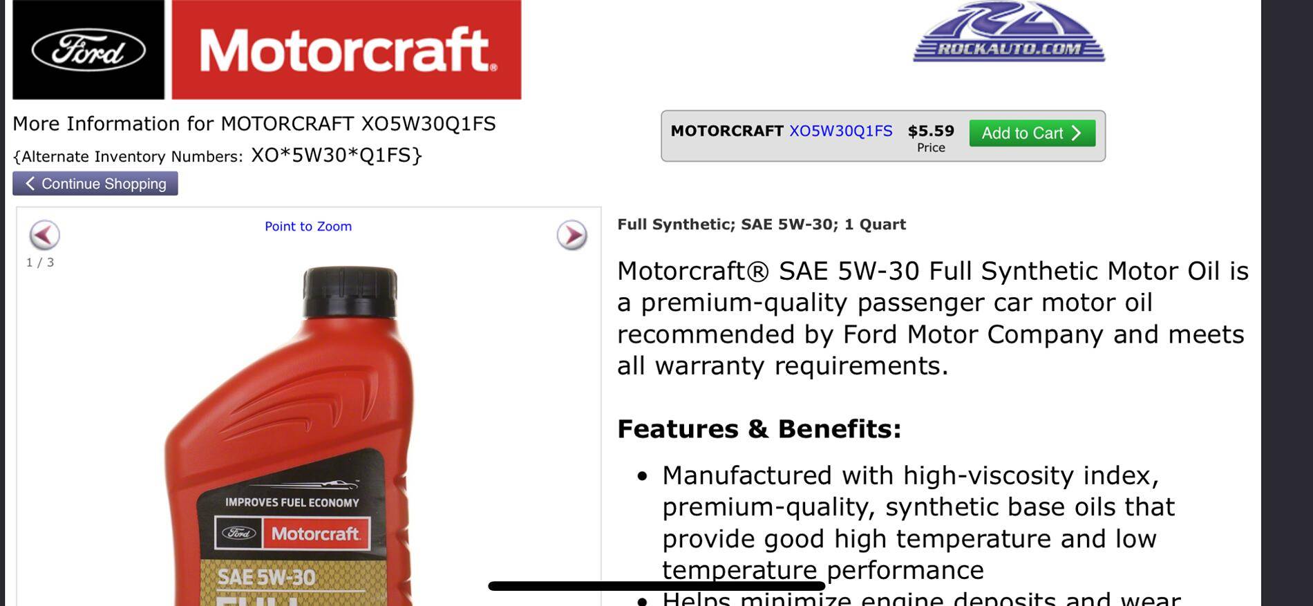

Rock Auto online (I mentioned that in my previous post and had you ordered then, you’d have it by this weekend) $5.59. Otherwise yes Ford dealer where it’s twice the price but local and available.
https://www.rockauto.com/en/moreinfo.php?pk=11450437
