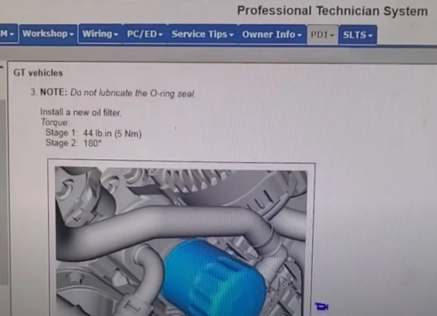

Well got everything I needed today. Don’t trust myself on over tightening so grabbed a acdelco digital torque wrench off Amazon that was on sale, even grabbed a Milwaukee cordless ratchet for all the bolts, and to add a lip.
Only thing I’m worried about is tightening the filter, but will be watching videos to get an idea of how tight they do it. Kinda nervous but I think it will be fine, giving myself a lot of time to do it. Really appreciate everyone’s help and reccomendations.

Glove and hand tighten as tight as my wrist will go. Works great

Not everybody has the same hand power, but generally, hand tighten it once. Let go, feel if it's tight. And then give it a little bit more hand tighen power. Just a little bit more than your normal hand tighten strenght.

@dtillsstang ..... about the oil filter. With a wipe of oil on the rubber gasket the filter will seat easily. Turn it until it is snug then (some say another 1/4 turn) I just tighten it a bit further. You'll know as it won't want to turn anymore. Don't use a filter wrench to tighten it as that will "roll-up" the rubber gasket. You will be fine. Good for you!

As for oil filter, others have offered excellent advice but add one more check and that is to make sure the previous oil filter gasket ie: the rubber ring, isn't left on the car.
