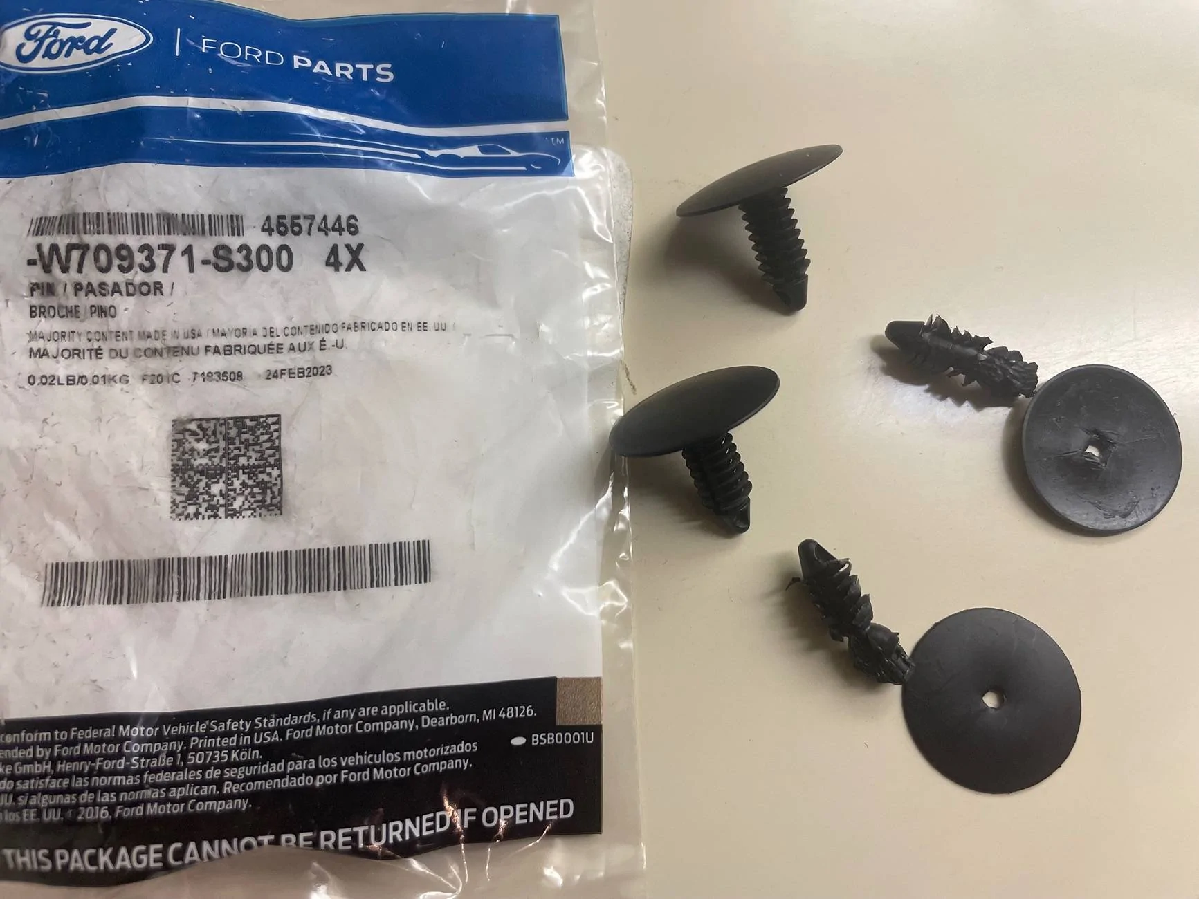

The big pain on the S650 is the belly pan. Lots of screws and two types of push pins. Helps to have an upholstery tool. One of the two types of push pins comes out in pieces, so I have spares. Here’s the part/part number. You can see the broken vs. new ones. Comes in a four pack, you’ll need two.
