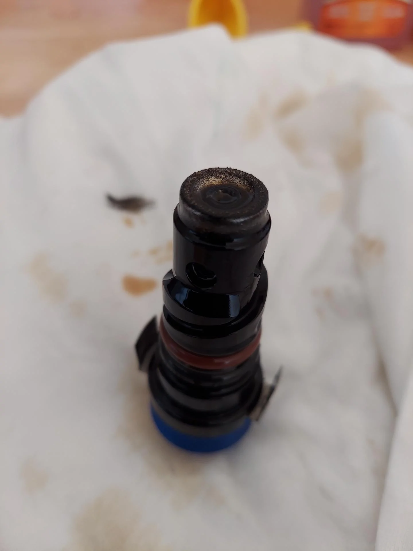

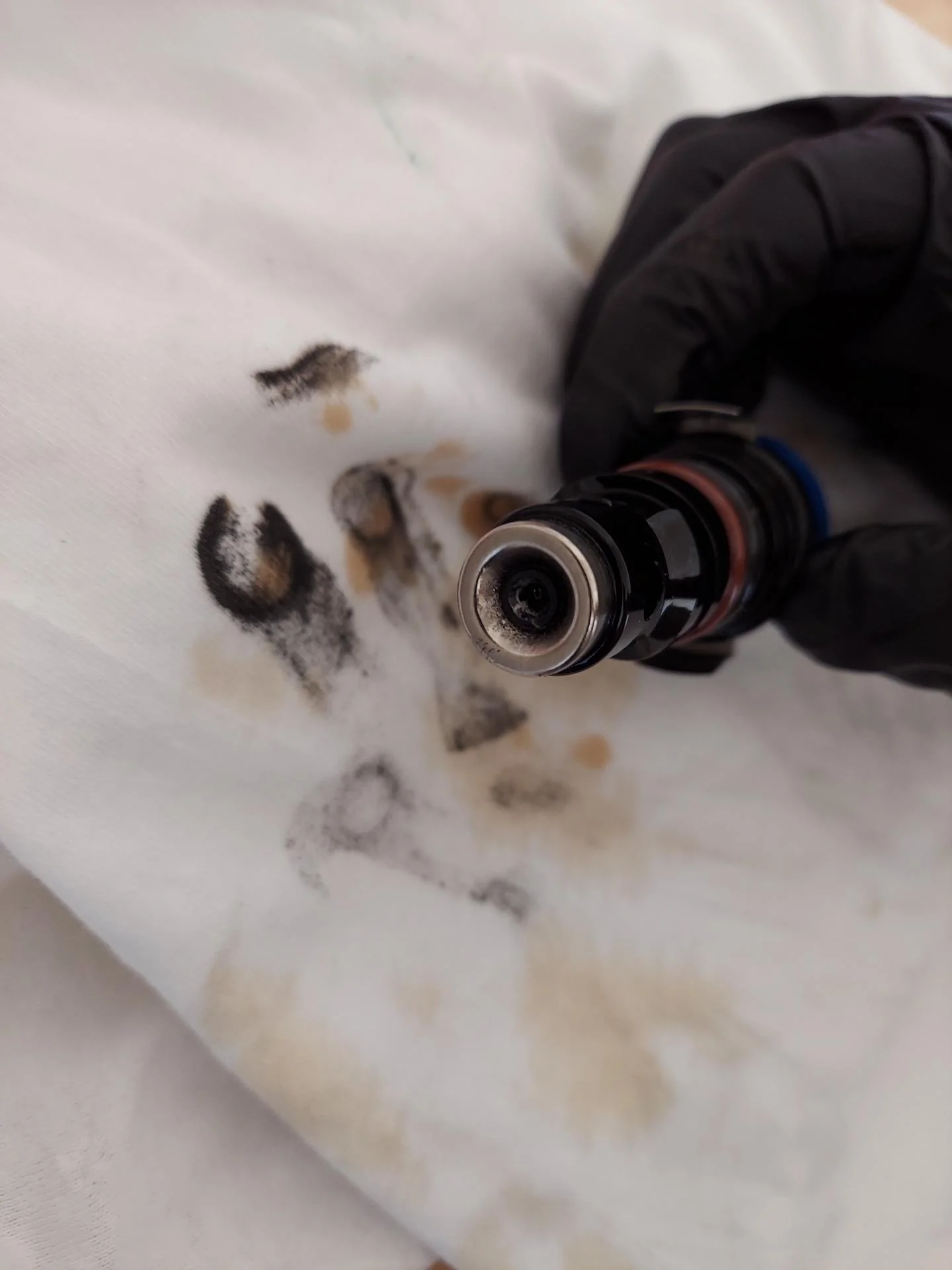

I changed mine shortly after 1,000 mi / 1,600 km.
Leftovers from factory machining and assembly, along with break-in material, are present. I've had oil analysis performed on the first and now second oil changes. There's something of a flushing effect which occurs with those changes, to remove contaminants and bring the oil itself to something true to the specified weight and characteristics.
During the first oil change, I installed a magnetic plug. Attached are photos from the second oil change. They highlight what the engine has been shedding, plus materials which hadn't been filtered or flushed during that initial change. During any oil change, there will be oil remaining, in the galleys and oil cooler (if equipped).
Doing this is IMO a best practice. It's a step towards goodness. I do believe the factory oil fill is not off the shelf oil (see XL-17 discussions) and it is not a good idea to change sooner than what I referenced. Many (probably most) Owners do wait until 5K mi / 9K km, change the oil then and experience no issues.
