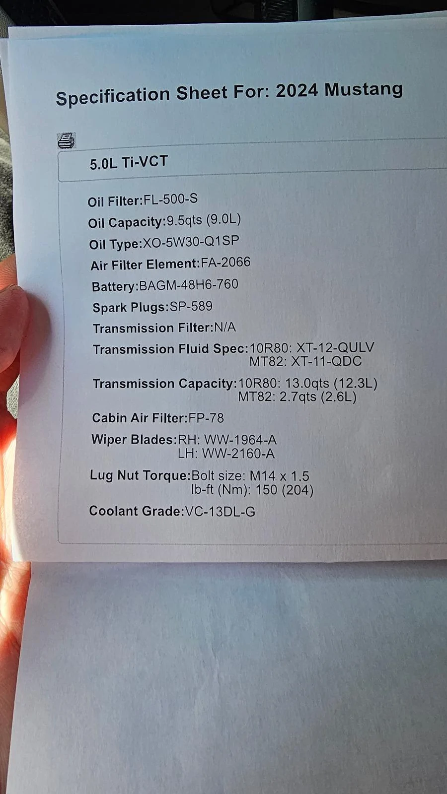

Yo, so I finally got my first oil change at 5k miles. I wanted to do it earlier, but the dealership insisted on waiting. I don't plan on keeping this car for more than 3 years, so I'm not too worried about it. But man, I miss my 550.
Anyway, the technician told me the oil capacity was 9.5 quarts. I checked online and saw that it says 10 quarts or 9.5 liters in the owner's manual.
Ford's software does say 9.5 quarts or 9.0 liters, they gave me a printout.
I don't get it. But whatever, I just added another half quart and now it's all good.

that's really odd since everywhere else says 10 QTs.
Only thing I can think of is maybe the new models with start-stop take 9.5 and they just changed the documents for all of them
dusman59
Mar 8, 2023
914
929
AZ
2011 GT glass top & 2024 GT
I was 1qt low when I checked after driving home from the dealer. Car had less than 25 miles. I added 1/2 qt 5-30w Ford blended to bring it up to the mddle of the safe zone on the dipstick. Checked it again at 500 miles and it hasn't changed. I don't see what S/S has to do with oil amounts.

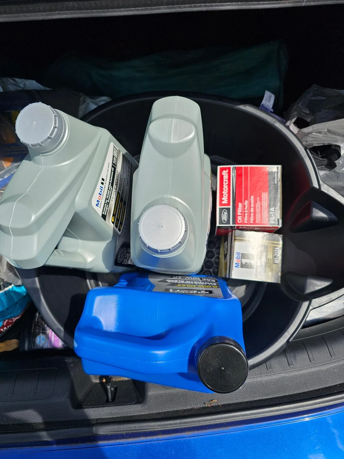

S650 Mustang First oil change.. 9.5qt? 20230916_144216
Did the oil change on my 22 gt pp1 (super tech bottle is for my 95 f150) idk why I psyched myself out on this car. Kinda most of the reason I'm not enjoying it.. I feel like I can't touch it

Did they not check the dipstick after the change to verify it was correct?
Did you check the dipstick before you added more ?
Change amounts can vary from dry fill capacity as when there are things like oil coolers not all of the oil will come out through the drain plug.
I do wonder if during factory fill that they're accounting for vehicles with extra coolers or not.
Or if they're firing the engine before doing a final fill check.
I also wonder what the oil circuit looks like and whether oil always goes through the external coolers or whether they have a thermo bypass valve on it. I'm hoping the engine also has an oil to water heat exchanger as well ...
He didn't check the dipstick, I figured 9.5 wasn't in the danger zone. After I let the car sit for 15m while talking to them I checked the dipstick and it was barely above the bottom of the crosshatches, after I added what I had in my trunk (old car habits, I always keep a bottle of oil in the trunk)
Now it's sitting 3/4ths in the cross hatch marks

Their info is wrong. It's 10 quarts on the nose.
