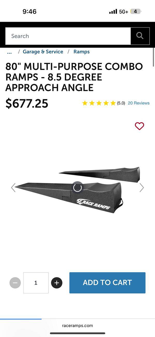

Got it all done. The undercover was a pain but not too bad. Ended up going with Pennzoil ultra platinum, $70 total for oil change compared to dealers $217, no ticking so far, the race ramps were awesome.
2,839
2,820
that's a lot of money for something you can't even use to change a tire

It’s usd lol, wanted to make sure I didn’t rub when I added stuff, I got a 15% discount though so it was more like 550. Could of probably got by with rhino ramps but decided on these.
