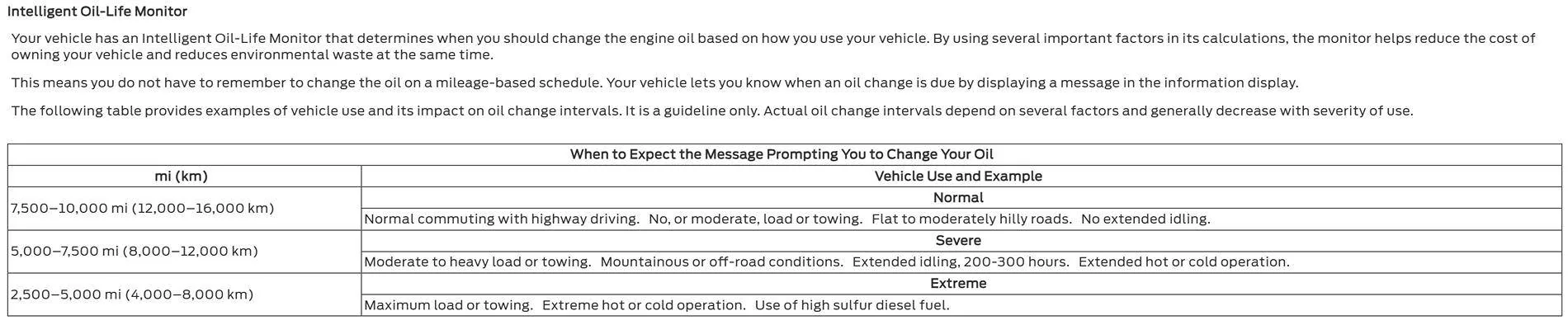

If your Oil Life Monitor (OLM) is telling you it's time to change the oil, you should. The OLM is driven by several factors, to include miles, temperatures, RPMs, amount of time driven, frequency of each drive, etc. At one extreme, a car not driven at all, the OLM will expire at the end of one year. At the other, someone who tracks their car consistently, the OLM will expire much quicker.
If the OLM is not alarming, but you're interested in changing after the drivetrain's break-in period, you can do that. I did. But it is not a requirement. Several trains of thought on that. I've attached two of my previous posts and some other threads.

FWIW - was told by two different Ford dealerships - the first oil change due at 5K miles. This is for both a 2024 S650 GT and a 2024 Ford F350 King Ranch. My wife has a 2024 Hyundai Palisade - same deal.
