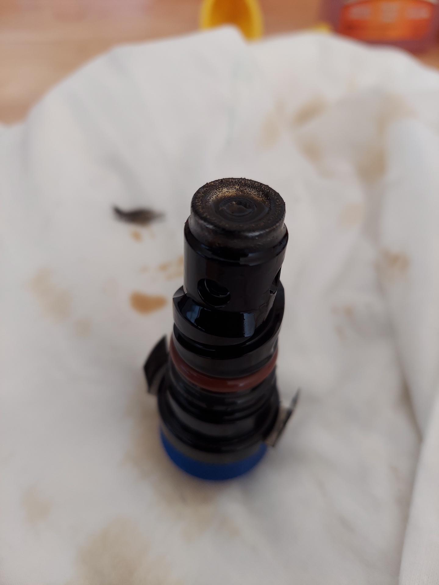

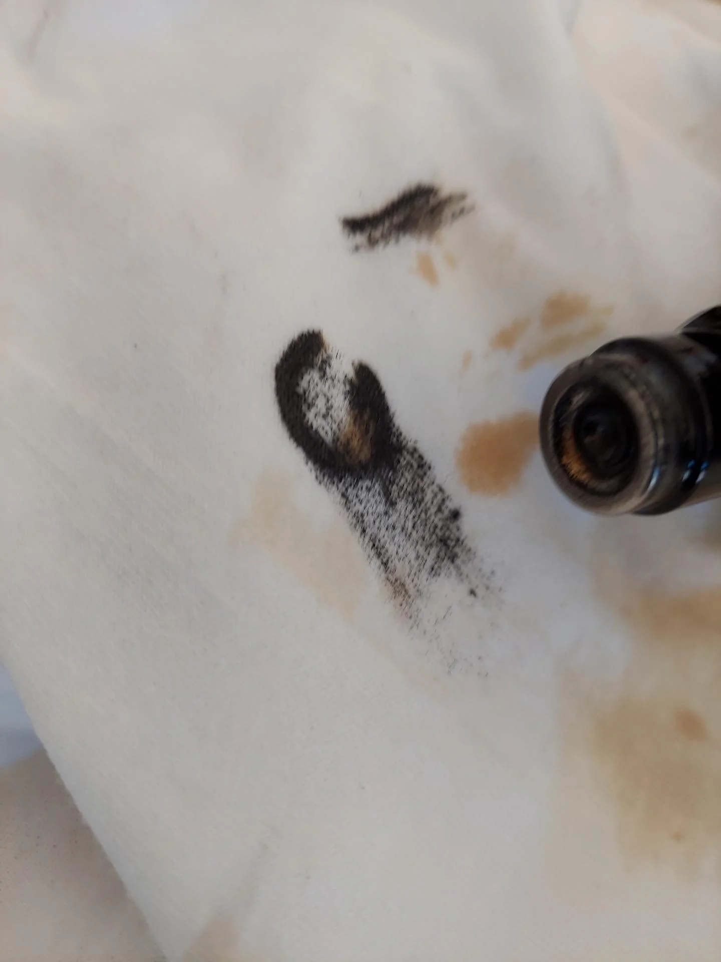

Many do their initial at a 1000 miles / 1600 kilometers.
Skye is a weekend/Holiday car and not a DD.
I did my initial at 1265 mi / 2035 km.
Leaning forward to Winter storage, I completed my second this week at 2546 mi / 4100 km.
I think it's a good practice to accomplish the first around a 1000 or a bit more. There's a lot of crud leftover from original machining and breaking-in. Blackstone Labs believes there's something of a flushing effect with a new engine, that it takes some initial oil changes to remove what was there from first miles and parts seating.
Reviewing my magnetic drain plug (installed during first oil change) this week, I can confirm Blackstone's thoughts.
I do not recommend changing the oil sooner than completion of recommended break-in period. I do believe the factory fill contains at least one additive (IMO, XL-17) to assist with seating the parts.
YMMV.

What oil plug is that? I didn’t know they had one out for the 24. Cause we have a metal pan again correct?

It's a UPR type for my 2022.
Correct: Members have confirmed the S650 is using a traditional metal pan and plug.
I'd expect the aftermarket to field S650 versions as soon as it's possible.
