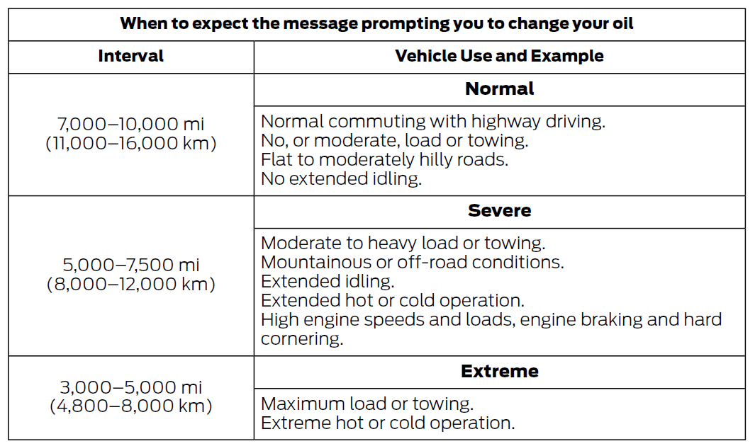

Interesting It says these cars have an Intelligent Oil-Life Monitor. I don't recall reading this on my s650 manual
Your vehicle has an Intelligent Oil-Life Monitor that determines when you should change the engine oil based on how you use your vehicle. By using several important factors in its calculations, the monitor helps reduce the cost of owning your vehicle and reduces environmental waste at the same time.
This means you do not have to remember to change the oil on a mileage-based schedule. Your vehicle lets you know when an oil change is due by displaying a message in the information display.

Exactly. My wifes 22' Expedition puts a message on the dash and sends a text when it is at 20% (I think) oil life left.

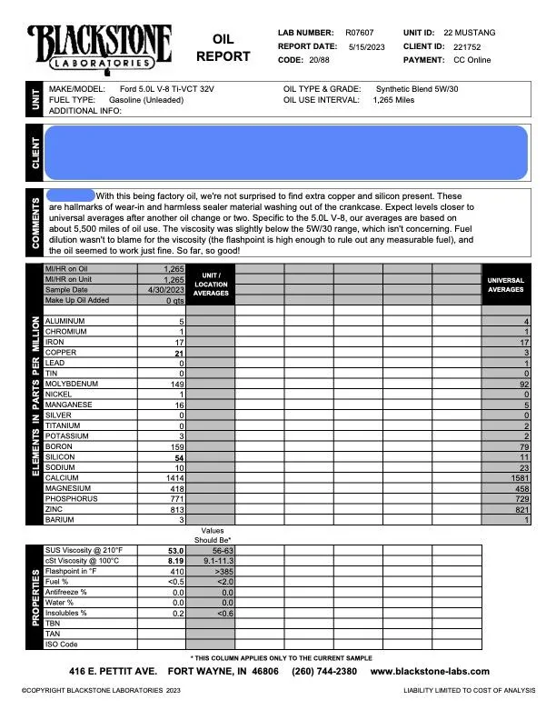

Did my initial at about 1200 miles, 1900 kms. Replaced with 5W30, Pennzoil Ultra Platinum (PUP).

As others have commented, the Oil Life Monitor relies on multiple factors to advise you when to change. One of those factors is time. No matter how little you drive, the Monitor will tick down to 0% in one year. At a minimum, the factory timer counts down 1.92% a week and expires at one year. At the other extreme, people who consistently track, go to the strip, or see severe duty more often, the monitor could countdown at a faster rate.
Some break-in and engine oil analysis insight.
I've had zero issues of any kind. No oil burning. No ticking. No change in power or behavior.
For those interested in oil analysis, most people use Blackstone. You can receive an analysis kit for free and set that aside for the first oil change. Once you have a sample, you can pay over the Internet for a lab and send the sample in. In two weeks or so, you'll get the results.
I did an initial, for confidence things were well. All results were nominal. I'll be doing another this season.
Regarding the viscosity statement in the analysis below, I believe this is a tell that the factory fill is not off-the-shelf, that there are additives to assist with break-in. Many have commented previously, Ford uses XL-17 or something of the sort. While I do not have insight into the factory fill, I do feel something is complimenting the "regular" oil we buy in the store.
Regarding the high levels of copper on new engines, many Ford owners have reported same. It's a common characteristic.
Explaining Higher-Than-Expected Copper (Only) In Oil Sample
https://stratson.eu/high-copper-levels-used-oil-analysis/
"Copper is a soft malleable metal that is used in a wide variety of applications. It is non-abrasive and helps prevent wear. The appearance of Copper in a used oil analysis should not be cause for alarm or repair unless other abrasive wear metal such as iron, aluminum, chromium, etc. are present at higher than normal levels. There are several possible sources for high Copper levels. Leaching as mentioned before from oil coolers, leaks from cooling systems, external contaminates, an oil additive, or from excessive wear. In all of these cases, other metals, materials and contaminates will be present."
