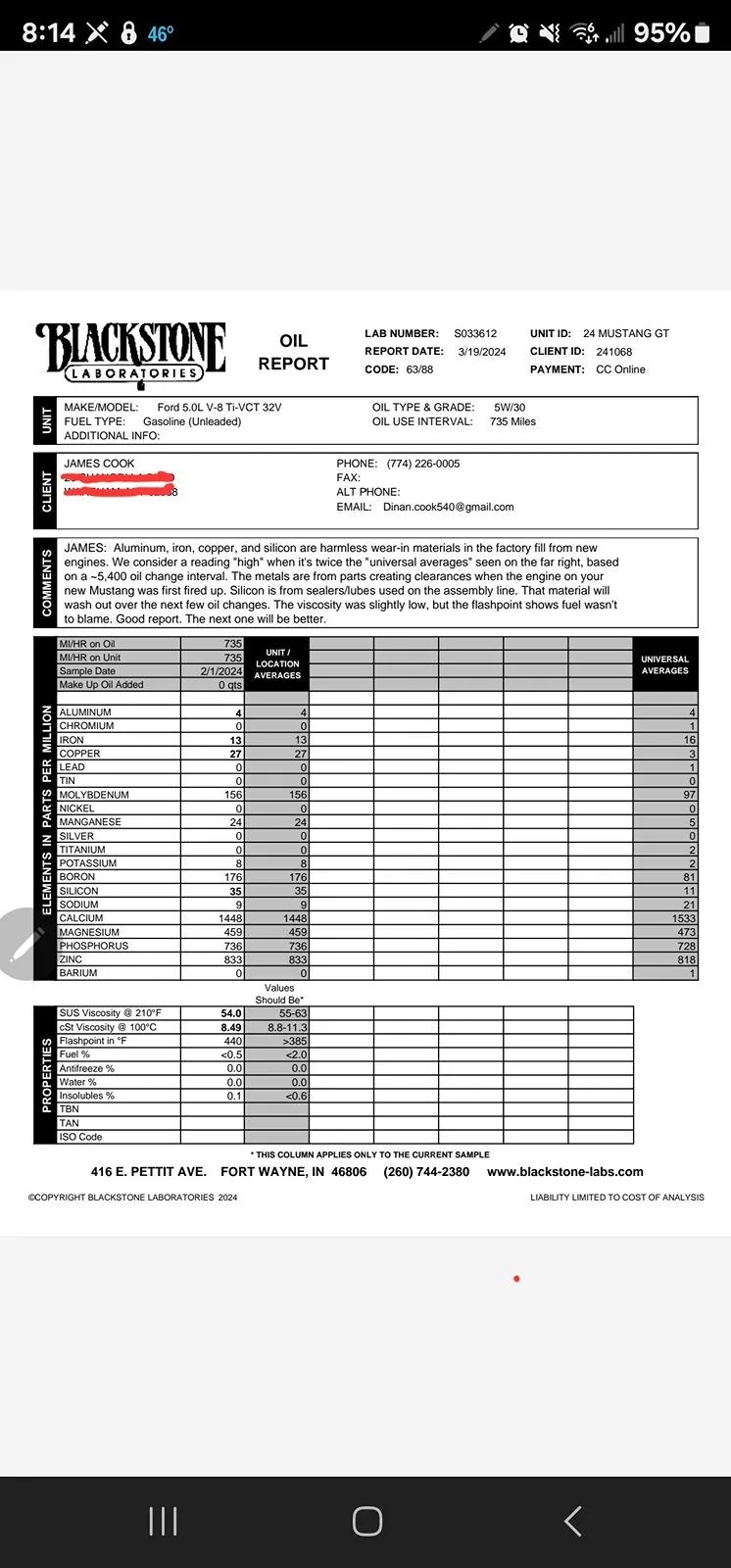

My first oil change was at 735. Just was a convenient time for me. Here is the Blackstone report.
Missed a spot or two
