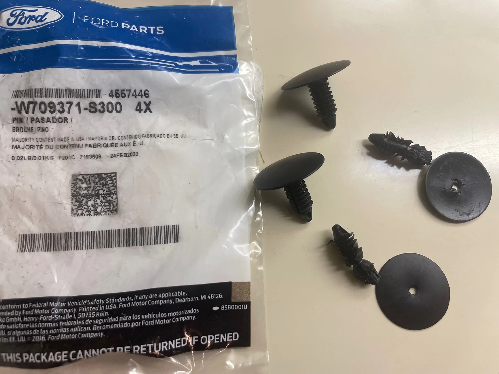

Not to scare you but these new Mustang GT’s are a little more complicated to change the oil. There’s a somewhat large belly pan that has more than a dozen little screws and 2 different types of push pins that makes the filter not readily accessible. One of the two types of push pins never comes out clean and probably needs to be replaced (picture attached). I do my own oil changes and dealing with the remove/reinstall of the belly pan takes up half the total time. If I were to take my car to a dealer and pay their prices I’d expect my car back as it came from the factory. On this forum I’ve read posts of this not being the case. So if you look underneath make sure all the screws, which are easy to lose, and push pins, which are easy to break, have been replaced. If they’re sloppy on that, then they’re probably sloppy on the oil change too.
S650 Mustang First oil change--checked the oil next day and it was barely above the min mark IMG_9280

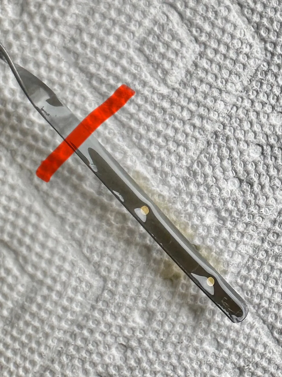

I had the opposite experience with my ecoboost. I paid for a full synthetic at 4200 miles and got the car home and later checked the oil - it was over a quart overfilled. Red line shows the oil level.
But then - the dealer sent out a mobile tech, fixed it, and my next oil change will be free plus a tank of gas. (I’ll take it in on a 1/4 tank😉). Dealer sent me several messages and calls of acknowledgment and apology.
So I’m OK with that but must remember - Trust - But Verfy!
