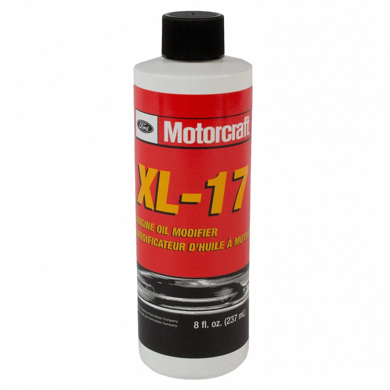

Nope, not tied to filter pre-fill. If anything additional oil additives seem to treat it. One observation is it goes away with miles only to return back after an oil change. So what could be in the oil then? One theory is oil accumulates suspended carbon from among other processes blow by. Small amounts of small particle suspended carbon is known to have tribological benefit. So then why do cars not have the tic from the factory? One theory is that a friction modifier is added to the factory fill. But what could this magic elixir be? Possibly XL17, which is suspended carbon/graphene.
