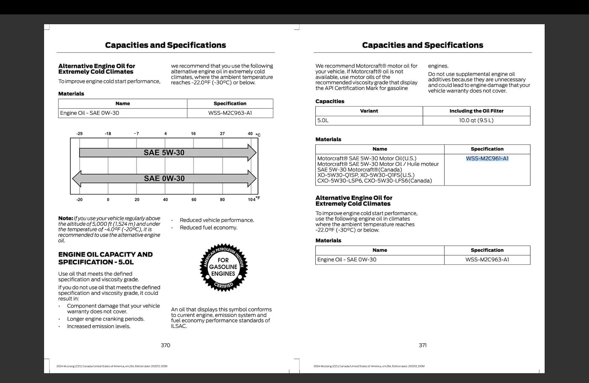

Is the factory specified oil dino or synthetic blend since many have changed to full synthetic? TIA.
The Owner Manual specifies the following for Eco and 5.0 engines: WSS-M2C961-A1, 5W-30
The Ford requirement translates to API SP and ILSAC GF-6A.
Checking Motorcaft, Valvoline, Castrol and O'Reilly's oil brands, I could not find a dino oil that was API SP, GF-6A and 5W-30.
Most conventional oils are 10W or straight weight, GF-5 or even 4.
7Gs are filled with blend.
If someone has a stock car, 2015-ish or older, traditional, conventional oil could make sense. I'm not aware of any modern manufacturer producing cars to use dino. Temperature, compression, emissions and Low-Speed Pre-Ignition requirements are some of the reasons why. Virtually all makers are requiring blend, if not synthetic from the start.
