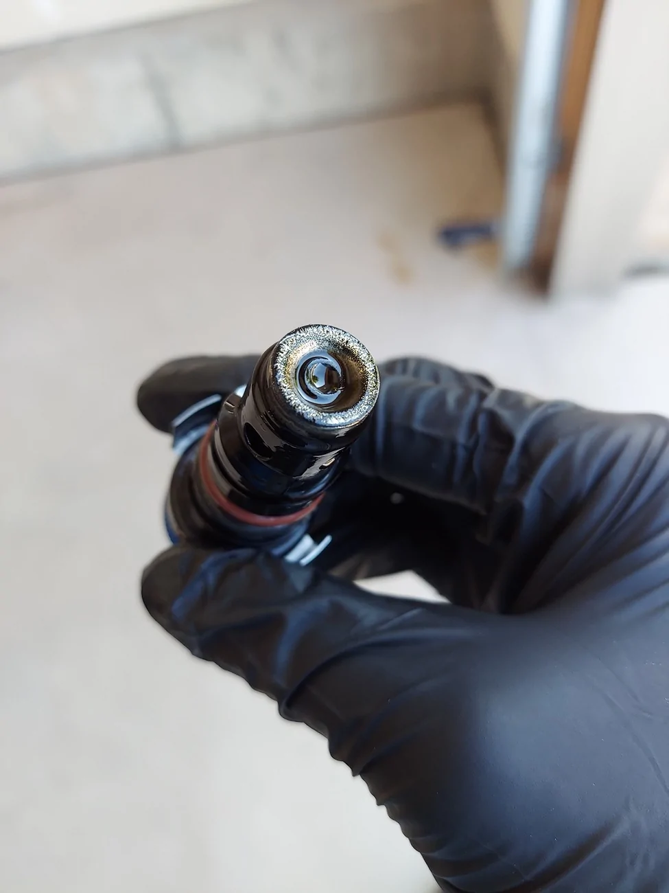

I can appreciate the concern. One of the benefits of a gravity drain is that flow of oil is helping to drag out anything with it. For reference, attached is a picture of my magnetic drain plug. I changed Skye's oil this month. I've cycled the factory oil, plus 20 quarts of my own, through the engine, lines and cooler. Still seeing some specs of matter on the plug. Much less than the first change. That's not a good thing or a bad thing. It's just a thing. Oil analysis and other checks have been confirming everything is fine.
