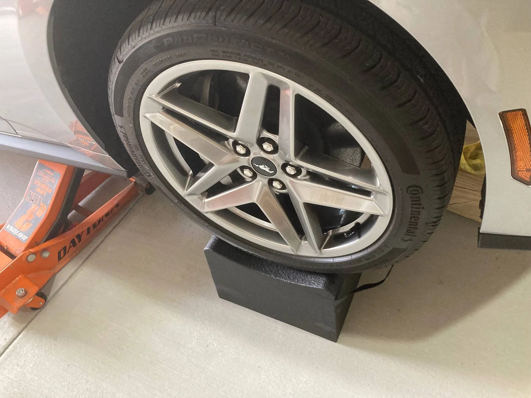

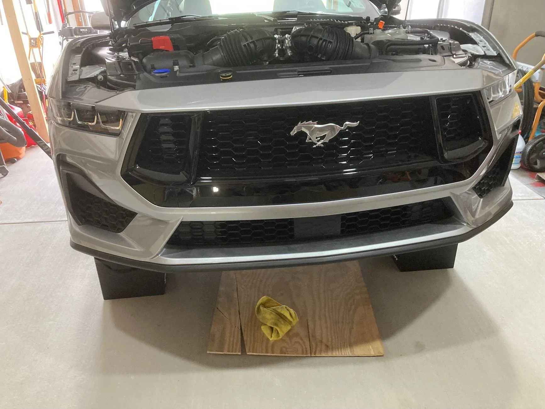

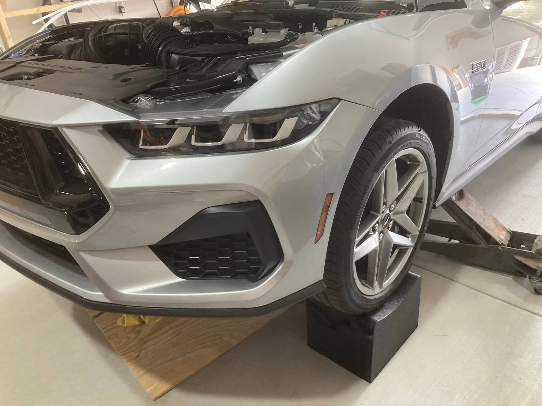

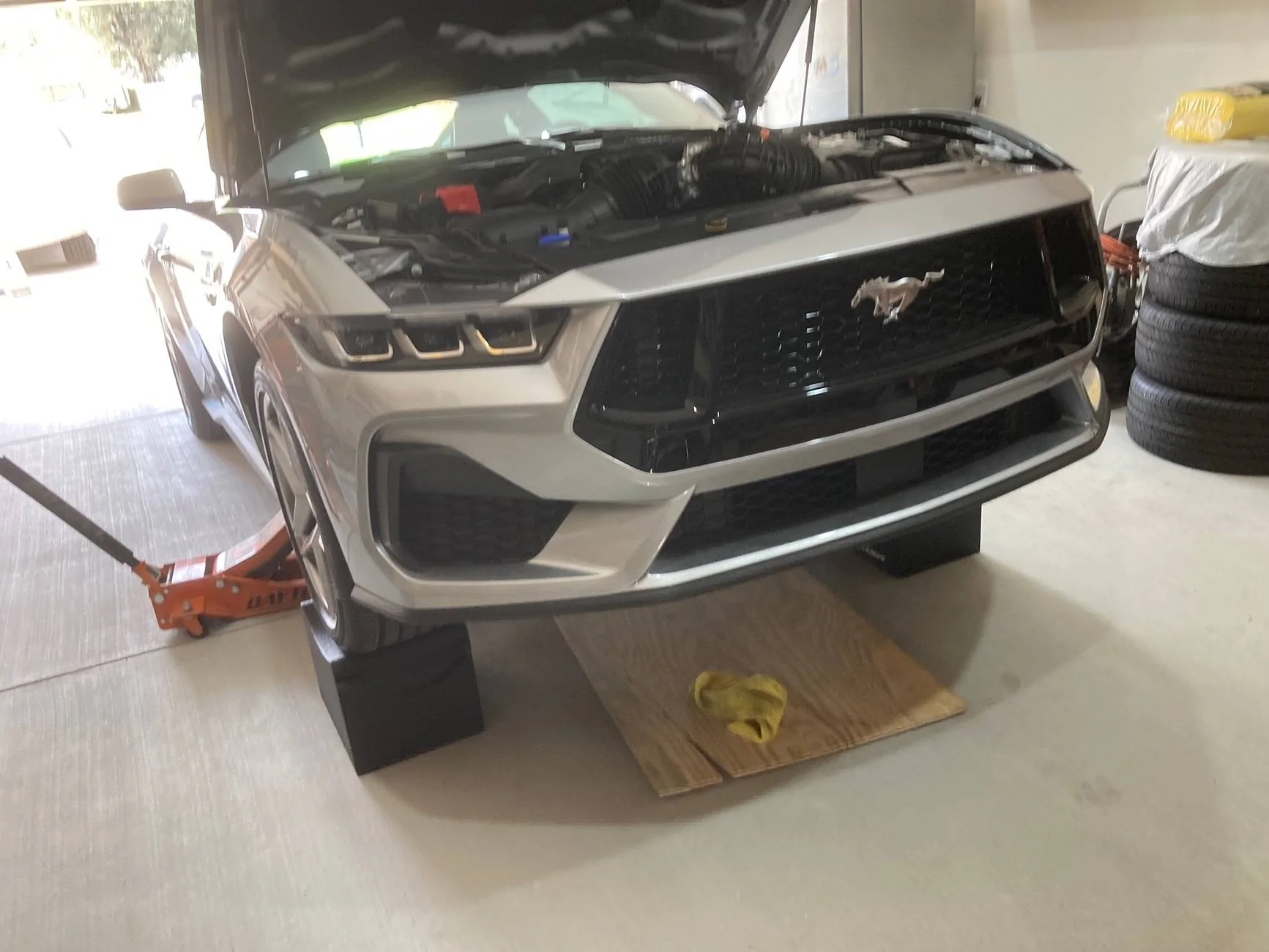

So after having car for 1 year finally did oil change at a 1000 miles. Used the Motorcraft Synthetic. I’ve changed oil in many a car and truck over the years, this is a couple of hour endeavor. I used the 10 inch tall Race ramp cribs. They gave you plenty of of room under car, really good product. Panel removal easy but time consuming. I ended up up using a rubber funnel I got off Amazon to prevent the oil from dripping on frame components, it worked great!

That's a really good question, if the drain was on the side of the pan I would say yes. The method I used is just as if on jack stands. It gives you a lot of room to move around and you need it with all of those machine bolts you have to remove. BTW it does hold 10 quarts.
