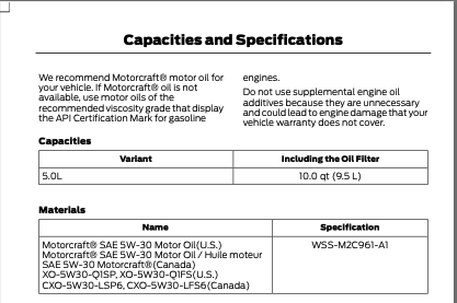

It's not true and honestly I'd be suspect about your dealer based on this. Here is what your owners manual calls for.
And here is what the spec is.
https://www.motorcraft.com/us/en_us...oil/sae-5w-30-synthetic-blend-motor-oils.html
Now there is absolutely nothing wrong with Mobil 1. It is a full syn so I'd love to know how many points they took from you as full sun costs way more than the blend. Id also ask the exactly what weight oil did they use. That's kind of important.
Ps. Our Mustangs use the same oil as other Ford vehicles so once again, based on what you were told, I'd be looking for another dealer.
I can't testify to what when in, but I was billed for 5W-30 Motorcraft XO-5W30-Q1FS. $133.24 - $20.02 for my inconvenience = $113.22 for an oil change is only mildly outrageous since it does take 10 quarts and I specifically requested full synthetic. After reading about how many bolts are necessary to get at just to do the job, and watching 2 techs with a flashlight trying to figure it out, they can keep the money and I'll keep my time.
After a poor sales and now service experience, I'll be travelling another 25 miles to the next dealership over.
I started the day with 42K Ford Pass points, now I have 19,356.
